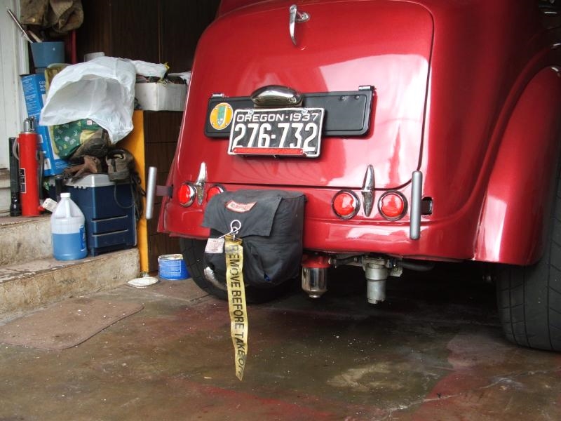

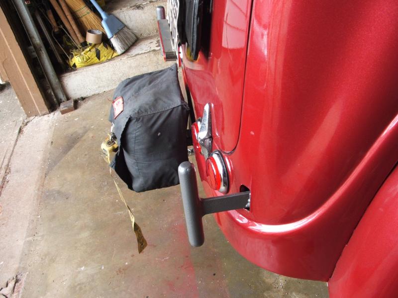

Spent a few hours yesterday fabbing up a chute mount that would locate a plate behind the body, and not require drilling any holes through the body to mount the chute. I built it from some heavy wall 1"x2" scrap box I had leftover, and then took my old plate and welded it to the bracket.
Couple hours this morning drilling and bolting it to the frame, and after some adjustment I came up with this:

It sits just low enough to miss the runk lid when fully open, and also close enough that my hinged license plate will drop just past it. About 1" from the body for clearance, as I wanted it tucked in tighter than it was when I had the previous bumper. That chute is a pain to repack, so hope I don't ever need to open it again!

Probably was a pain to do all that, but the chute is a nice touch though. Turned out looking real good back there.

Thanks! Seems like a concensus. Every one of my friends looked at it and asked if I was going to put the chute back on, so I decided I better figure a way to do so, and not mount it to the body. Everybody was also glad to see the old bumper go, except my brother, but he's not too car saavy, so I don't listen too much to his car opinions.
