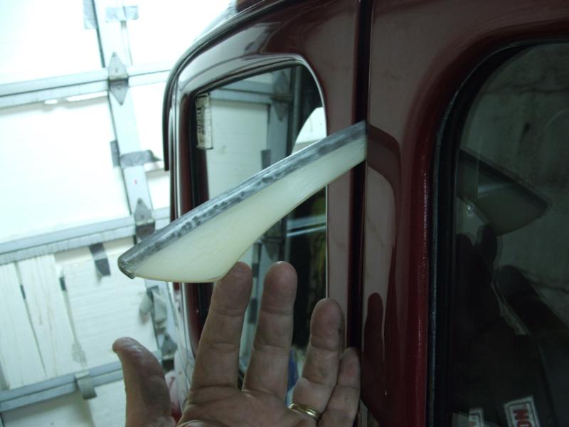

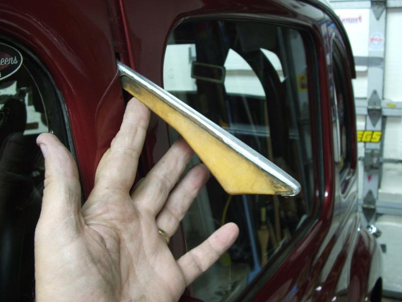

Made a pattern for my missing semiphor today, from the existing one on the driver's side. Took some old aluminum tubing I had and cut one side open, then worked it over the edge of a piece of 1/4" steel to make is ft the edge of the plastic I got.
After cutting the pattern out and dressing it on the belt sander, I epoxied the metal to the edge and drilled for the pivot screw. I need to figure a way to age the plastic now, as it's not yellowed enough. Wont really show when it's closed, but I'll see if I can get some stain or paint to distress it.

Hey Val what is a semiphor? Im not to sure what im looking at in the pictures

I remember those so well. I grew up in England and my dad's 50's vintage Morris Minor had them. That was the old version of the turn signals! Kudos for keeping them on the car Val. They look great! Nice job.
Old Oct 26, 2012 | 08:56 AM
  #584
That was the automated version of sticking your arm out the window to signal a turn. Some semaphores had lights too.
Maybe there were, but I'm not aware of any American cars that had them.
Old Oct 26, 2012 | 09:29 AM
  #585
Yes, these are small "flags" that sit between the front and rear doors. They were illuminated, and had a solenoid that operated them when the signal switch was turned left or right. The older Austins were 6v., and my solenoids are no good, so they're simply there to fill the slot on my car.
The old VW's also used them, and repros are still made in 12v., so I could get later A40 semiphors, but they would need to be adapted to mount in my A10. I just want the car to look complete, so I'll use my lights, and not worry about them being operational.
