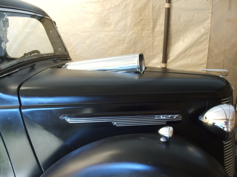

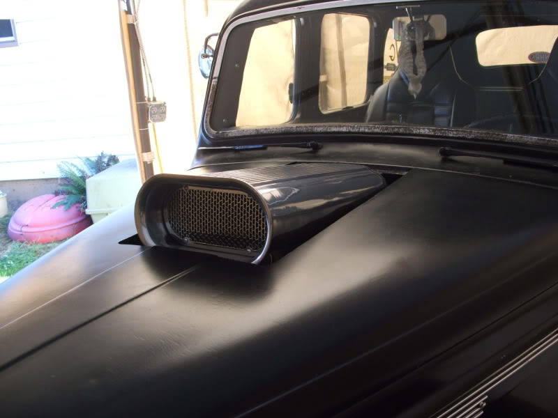

Back on the Austin to begin some changes. Got some 1.5" spacers from Richies Scoops and installed them between the carbs and the scoop to get it up farther through the hood. I will also have my 5 degree carb spacers later this week, which will bring the rear up another 1/4". I want it to still be uphill angle, just further through the hood, and less angle.
Pulled the scoop and was also able to do some chopping on the scoop itself. Due to engine setback my scoop sat under the cowl in back. By removing about an inch of the cast metal on the underside of the scoop I could slide it forward. Then I removed most of the sheetmetal base from the back and left just enough for the air cleaner to seal. The end result was the scoop slid forward over 2" and now just barely cleared the cowl. I did have to notch the lip that the hood rests on to match the scoop contour, but it goes on easily.
Before:
After:
The next part is to get some 1/4" round stock and bend it around the hood opening to fit about 1" away from the scoop. Then I'll weld it to the hood and that should leave a nice rounded raised area at the edge of the opening. The thin sheetmetal doesn't support much, and easy to get cut on when cleaning or wiping the scoop off. I'll wait to do that until I have the wedges installed, as it may change things a bit.

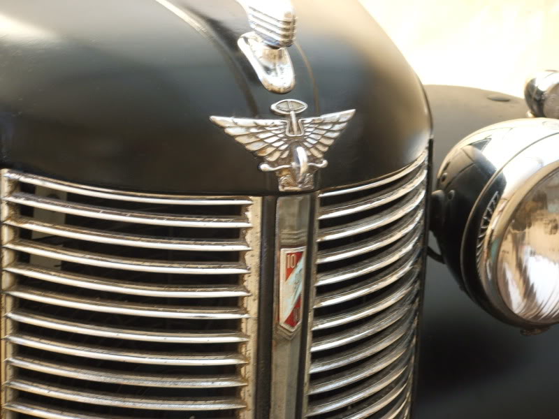

Got the grille "Austin 10" badge from England also, so finally something on the front to identify what it is:

Love the way the scoop turned out. Looks nice with the height and angle the way it is.
Old Aug 24, 2011 | 12:19 PM
  #89
Thanks! I've been trying to figure out how to get it raised without chopping the cowl for months. A friend took one look at it and mentioned carving up the base so it would slide forward. I didn't think about it, and wasn't sure it would work, but it did.
I went from 6 quater inch bolts to 4 to hold the scoop on, but still plenty strong.
