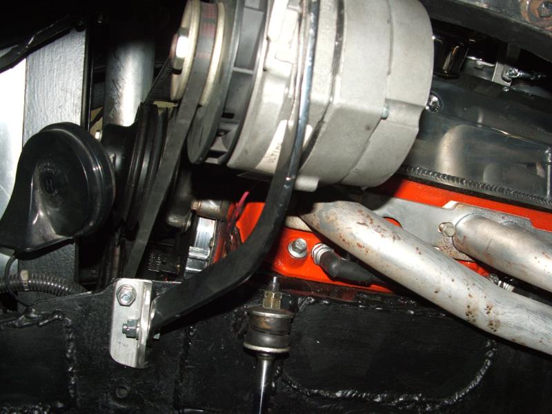

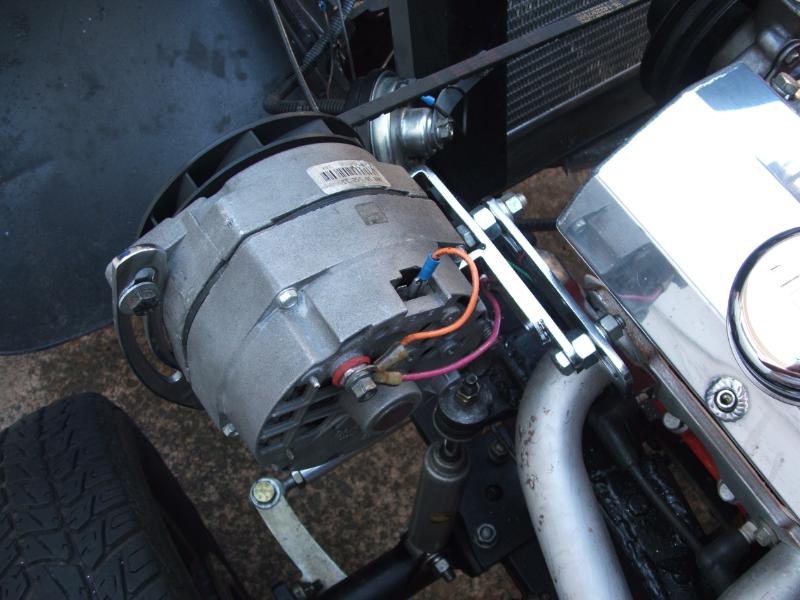

Been dealing with a less than good alternator mount since switching heads. My old mount hooked to the front header bolt at #1, and then into the front of the head. My adjustment was a piece of 3/8 allthread rod as there isn't room for a regular arm under the hood. with the new heads I lost the olt hole in the front of the head and my bracket always tried to move at an angle, making the belt run at an odd angle too.
Finally ordered an adjustable mount from Summit that hooks to both front header bolts, and can slide forward and back to align the belt. But the new mount sat the alternator even higher on the engine, and that wouldn't allow any type of arm to brace and adjust the alternator from the top side.
Since my engine is on solid mounts I decided the only way I could bolt an arm on was to come off the frame. With 1/2" clearance between the belt and the hood, and the belt and the frame, the belt has to be pretty close to perfect length, but it fits. Cut some aluminum angle and made a frame bracket, then got the anvil out and did a little bending to the arm, andfinally got it all to fit and adjust. Mounted from the bottom it tightens the belt as I move the alternator down towards the frame, so it's at it's loosest at the end of the arm.
Pain in the rear little job that took 3-4 hrs to finally figure out!

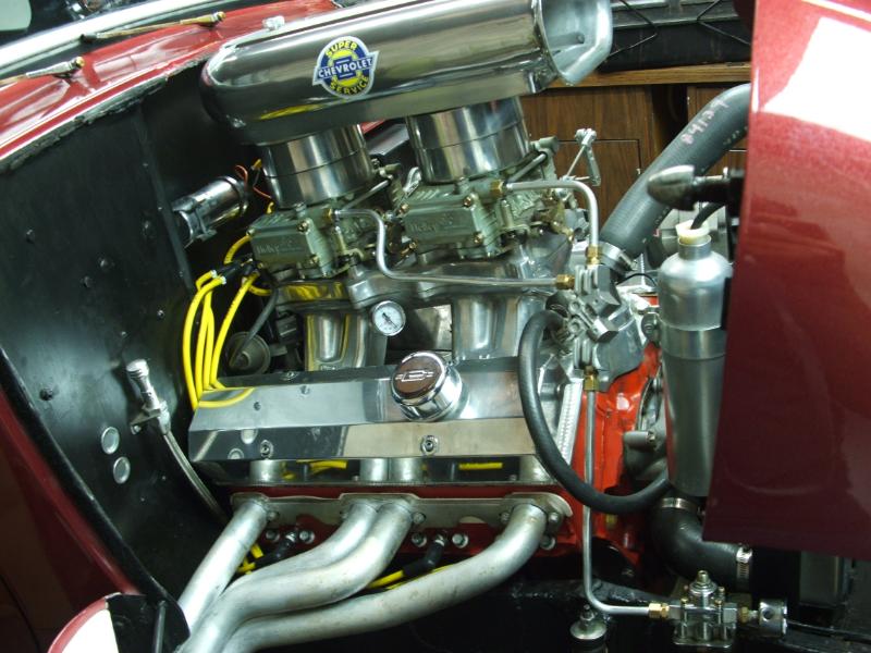

Developed a little miss on one cylinder and figured out my MSD was causing the plug wire to fire through the insulation on my small wires and that fouled one plug. Swapped out the wires to larger insulation, and replaced the bad plug. Fixed the miss. Pretty close behind the head /firewall clearance, so that and the high output was a bad mix.
