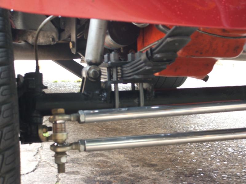

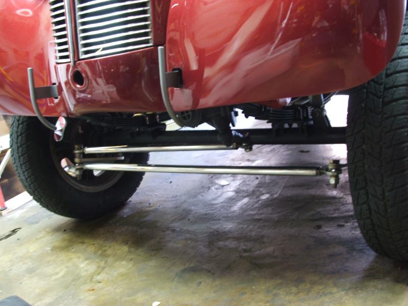

Did a little reworking of the fuel lines today, so had to run to the local hardware store to get some fittings. While I was there I came across some 1" aluminum tubing that was pretty cheap, and looked like it would work for another idea I had been considering.
Been wanting to possibly change out my tie rod and drag link for chrome pieces, but they don't make the sizes I need. I purchased the aluminum tubing and cut it to length of my tie rod and drag link. Took one heim off and slid them over the rod for a perfect fit!
Afterwards I got the Never Dull out and polished them up a bit, and they came out great I think!

Old Jun 19, 2012 | 09:45 PM
  #473
Shalamara's Avatar
March 2013 ROTM
Joined: Jul 2011
Posts: 415
From: Culver, Oregon
Neat idea!
Old Jun 19, 2012 | 11:32 PM
  #474
Thanks Bill!
Figured it might mess with people's minds when they see tie rods that look like they're polished aluminum!

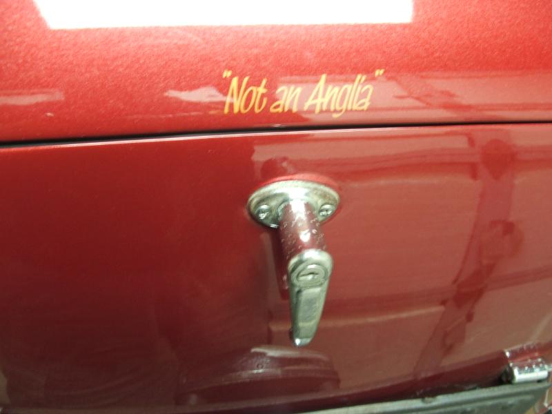

After answering the question many times I decided to have the sign guy make me some new signage for the rear of the Austin.

Old Jun 29, 2012 | 11:37 PM
  #478
Looks great! I like the new lettering on the trunk. lol
Thanks Bill! I actually had a guy argue with me the other day about whether it is an Austin or an Anglia. I called it the Austin, and he corrected me saying, "It's an Anglia."
I asked him if he really thought I didn't know what kind of car I owned, and he replied he grew up in England and knew an Anglia when he saw one. I pointed out the grille emblem and he said it looked like someone had put an Austin emblem on an Anglia.
I finally gave up and walked away from my own car to get far from him. That was when I decided it would be fun to put the new lettering on the trunk. I also put a smaller one on the inlet to my scoop, so when they look into it they see the same phrase.
