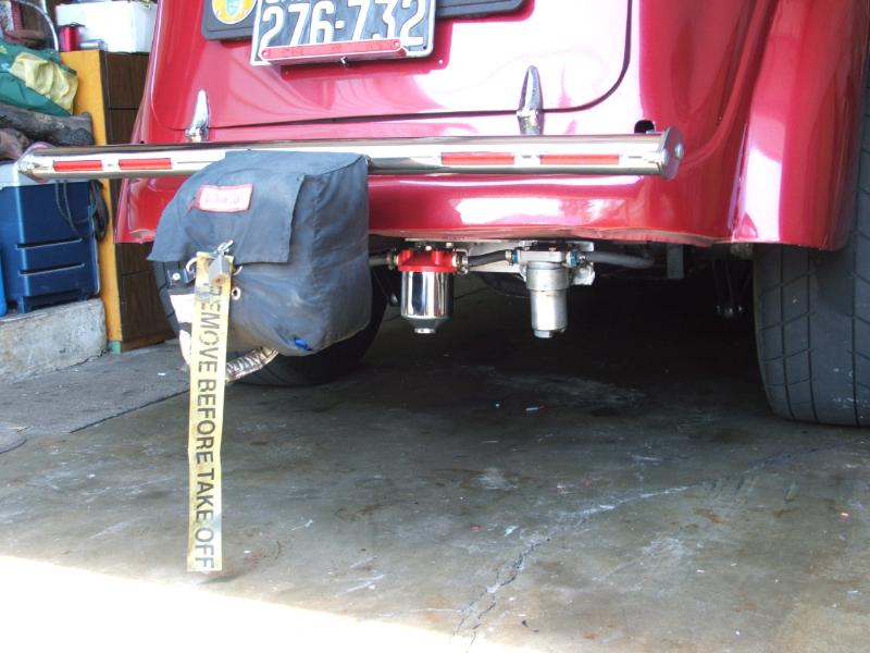

Clamped off my line from the fuel cell today and intalled my 10 micron canister filter. Had to relocate the fuel pump to do it, so I built a mounting rail from 2"x2" aluminum angle and mounted them both on it. Then just drilled holes that lined up with the old mounting holes for the fuel pump and bolted it all in place.
Haven't had any fuel problems with a new fuel cell and lines, but never know when you might get some ugly gas these days!

nice! im gonna have to replace the tank in the 68 now. the jets in te carb keep getting pluged with rust. going to maybe get out 55 chevy fired up this week need to get it outside for some pictures
If you can find a place to hide one of these 10 micron filters it will stop all the crud from plugging your carb. They're not too spendy either. I got mine at Summit for $25.
