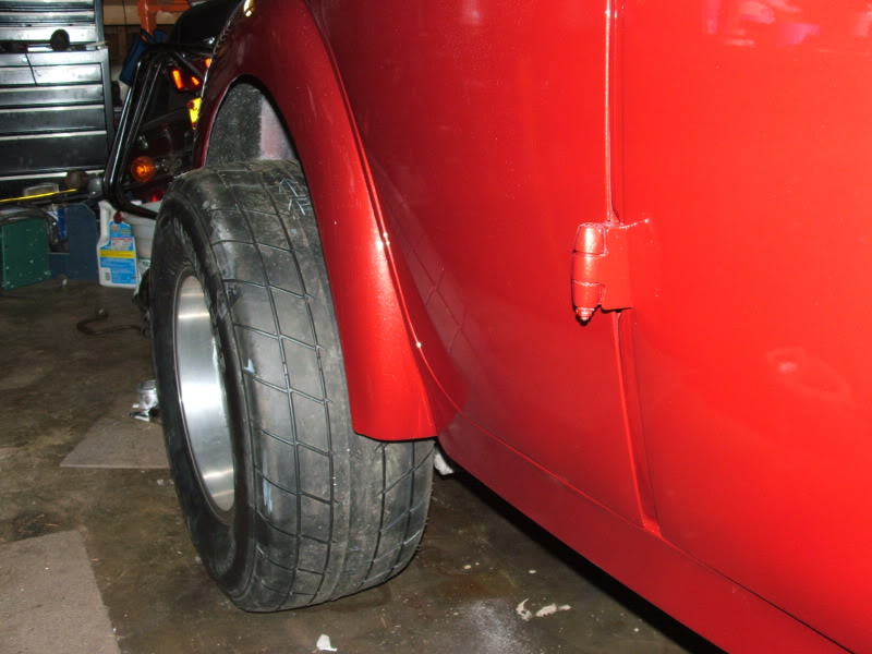

Started the cleanup, and painting on the undercarriage. I should have been more careful to mask off the chassis after all the work I did to clean and paint it once I finished it. Had primer all over the ladder bars, front suspension, inside the tilt frontend.
Got it washed Sunday, and cleaned, sanded and painted most of it today. Dropped my tires and wheels at the local tire shop and had them mounted and balanced, then got them on the car this afternoon.

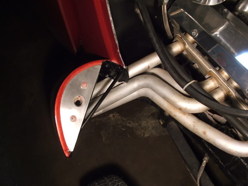

I also got my rub plates built this morning to keep the hood pins from scratching up the inside plates on my latch system for the frontend. Removed the latches and traced the shape, and mounting holes on thin aluminum, then cut it out and cleaned it up on the belt sander. Made them about 1/2" smaller than the fender so they will protect, but leave a painted border.

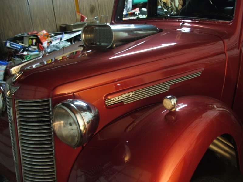

Another productive day! Sign shop sent me a layout to approve for decals, and they looked great! Also got almost everything done on the frontend of the car! Got my lights and fan all wired, then cleaned up the chrome and got it all on also.
