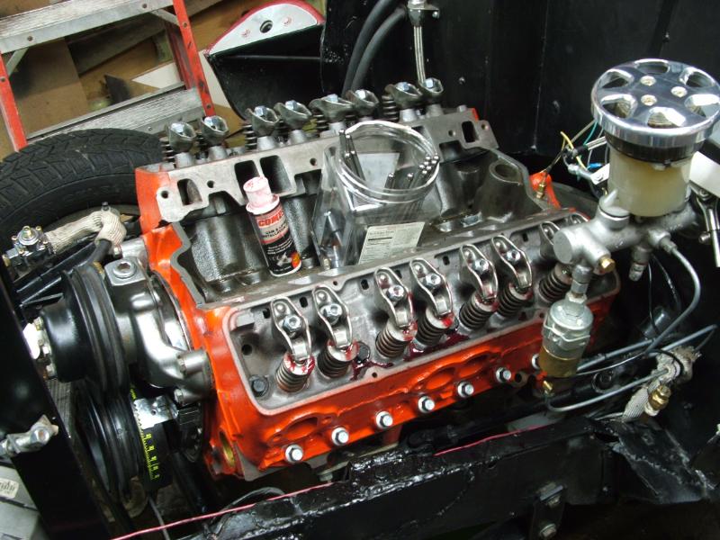

Well I took the heads to a 2nd shop to get another opinion. They confirmed that the guides were cut too large from the get go. Decided to trade the aluminum heads in to the 2nd shop toward a set of old 2.02 camel humps. They had a freshly rebuilt pair with new guides, SS valves, hardened seats, new springs, and CC'd chambers. Cheap swap, and I feel better about the old school Chevy technology.
Got the new heads on with new rockers, and new head bolts. Just waiting for the brown truck to deliver the lifters and then I can finish assembly and break it in AGAIN.

looks good! you cant beat the ol 2.02 camel humps they are great head, got them on my 68 camaro
