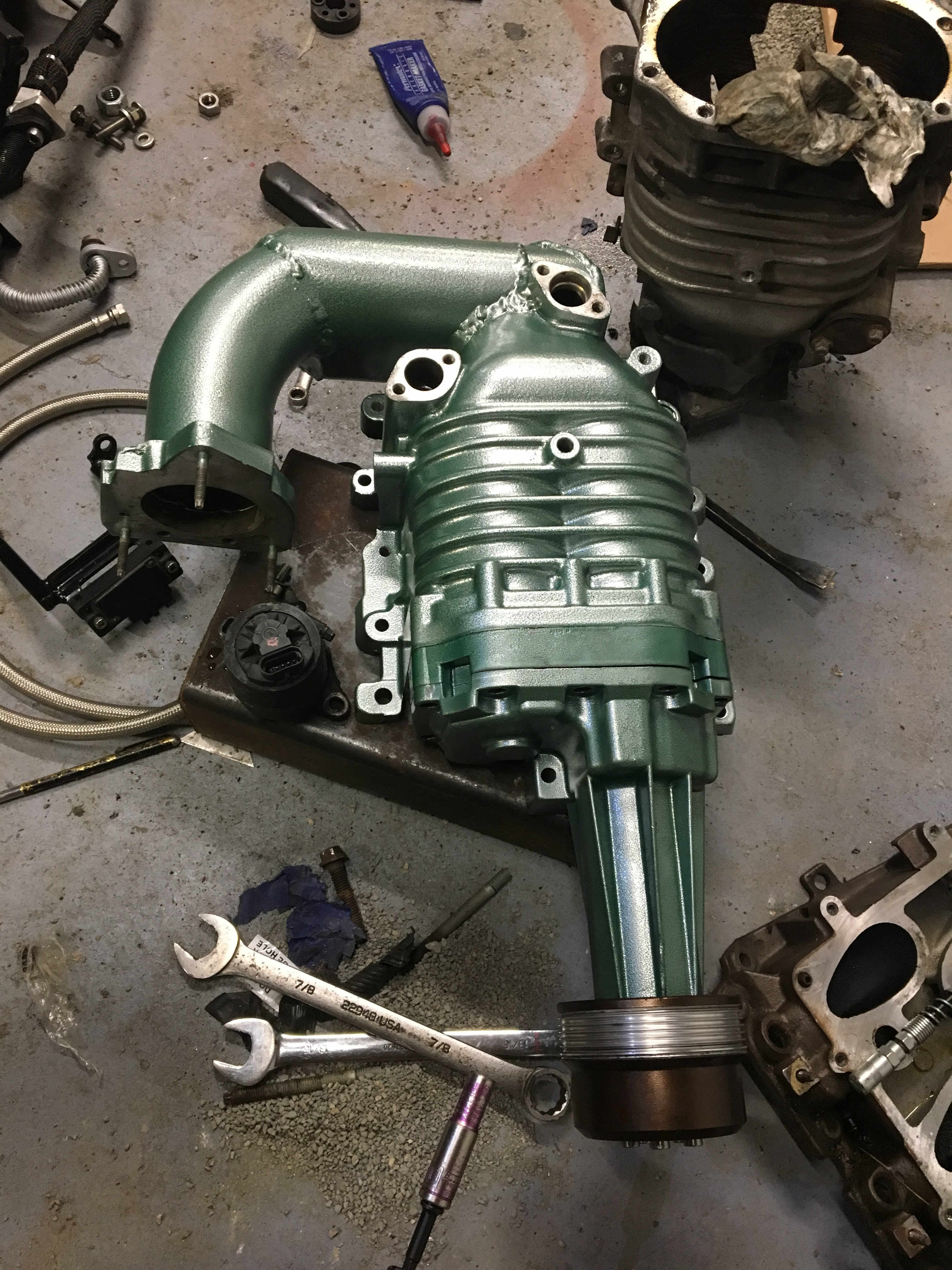

I got bored two weeks ago and decided to top swap my 3800 camaro. It's about 95% done, have a few little things to finish up yet but I got it tuned and took it for a shakedown run last night to make sure everything is working.
Long story short: L67 top swap, kept everything functional, the EGR, EVAP, BCS, A/C, etc. Car is a manual with T-tops, my summer DD. I've retrofitted D2S 3.0 square HID housings with the help of my 3D printer, '98+ brake upgrade, modified the '97 wiper arms to accept a traditional J-hook wipers, and a few other little things.
I have my own TIG and other fabrication tools, as well as the donor motor, so the cost for me to do this was ~$350 total. Most of that was new gaskets. Raw material for the blower case modifications came from a local metals recycler for about $10 total. The supercharger came from a '97 Bonneville SSEi, I used a 4.0" ZZP offset pulley to start with, added one idler to the belt routing and changed the belt path to get as much wrap as possible. Existing mods that were left untouched are headers, Intense S1X NA cam, Blue LS valve springs and LS style retainers, roller timing set, and maintained the fenderwell intake. Torque arm is divorced from the transmission tail housing.
But enough of that, some pics!

I'll go down the list of what I had to do to pull this off.
1. Supercharger case modification - there's enough meat in the side of the case to work what looks like a 90 degree fit into a tight radius smooth elbow inside. That way you can get around the stock L67 fuel rail. But you need to quickly transition to a typical mandrel bend to clearance the A/C lines. Note that the gen 3 case is very thick in that inside corner, transistioning from about 1/2" thick to a solid 1" at the bottom and if your TIG is underpowered you'll have to braze there. Note that in order to clearance the firewall the blower case cannot extent beyond the LIM back edge at any point. Also note that these modifications mean that the EGR and coolant provisions in the LIM need to be blocked off, and inside the blower case the PCV provision needs to be blocked off because it needs to draw air from between the MAS and the throttle plate.

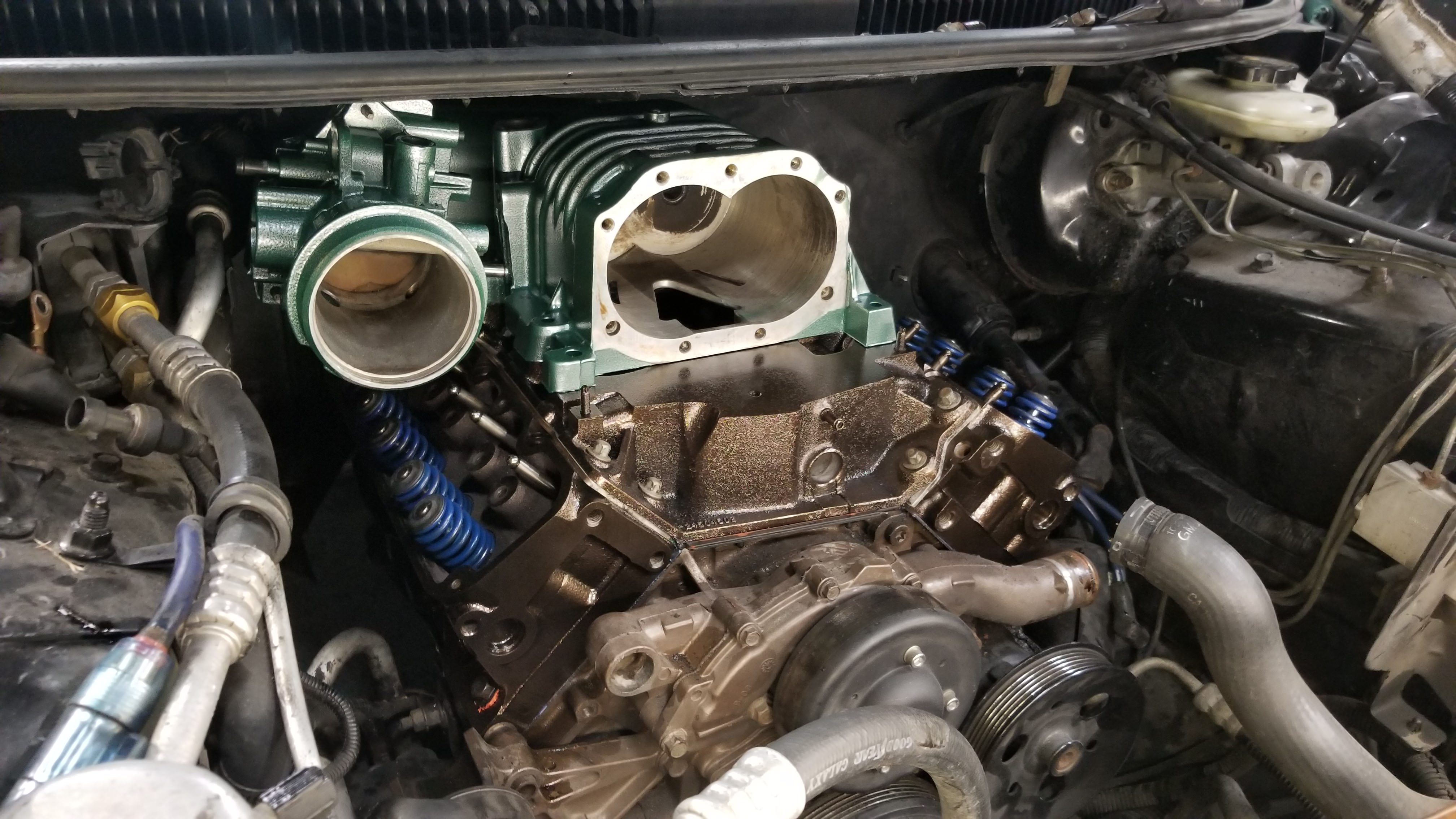

2. Throttle body placement depends on if you have DBW or cable. I wanted to keep the A/C, and I don't have DBW. On the passenger side of the cowl there's a bump up of about 1/2" extra vertical clearance, which is enough to squeeze the throttle body in there between the A/C lines and the fuel rail, in my case I mounted it withing 1/8" clearance to the rail. The other limiting factor is the alternator. The throttle body needs to be angled on two axis so the TPS clears the A/C lines and the inlet doesn't point straight into the alternator and is high enough to clear the heater hoses. I wanted to keep the TB as close to stock distance from the blower as possible as in past builds I've had weird tuning/idle issues with a remote mounted throttle body.
3. Firewall fit to L67 LIM is too tight, on mine it was about 1/4" interference with the very back bottom corner of the LIM. The firewall needs to be hammered in to provide clearance to the LIM. I also found later on that, due to EGR tube routing I needed to clearance another spot right behind the valve cover where the thermostat outlet and EGR tube are close to the firewall. Obviously there might be another way to route the EGR and thermostat outlet, but that's just what I ended up with:

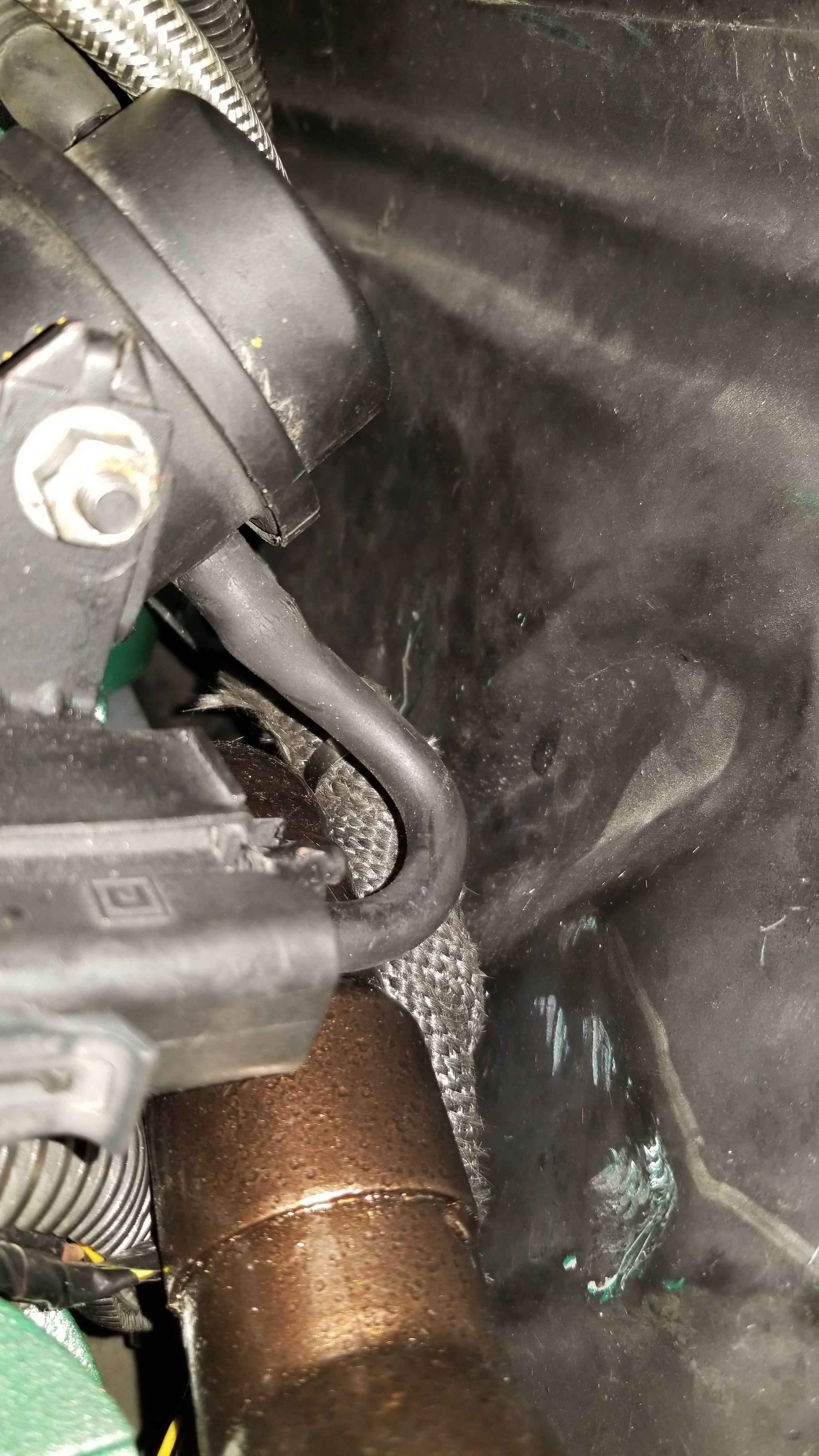

4. EGR, ICM and coils, fuel rail connections. I turned the EGR tube down and away from the manifold, and re-routed it along the side of the motor just above the header flange. I used stainless steel tubing and high-temperature compression x pipe fittings to relocate it to the side of the blower case. There is not enough room to utilize the stock L67 inlet port, perhaps if you machined a 90 degree adapter block and came at it from a different angle you might be able to. The EGR tubing is 16mm tubing - close enough that you can make a 5/8 hole and tubing work. I got the parts for this from McMaster, stainless tubing and 800F yor-lock fittings, cost about $40. The ICM had to be relocated forward of the oil fill which had to be moved from the passenger side to the drivers side. Fuel rail inlet and outlet simply bent to point to the drivers side.

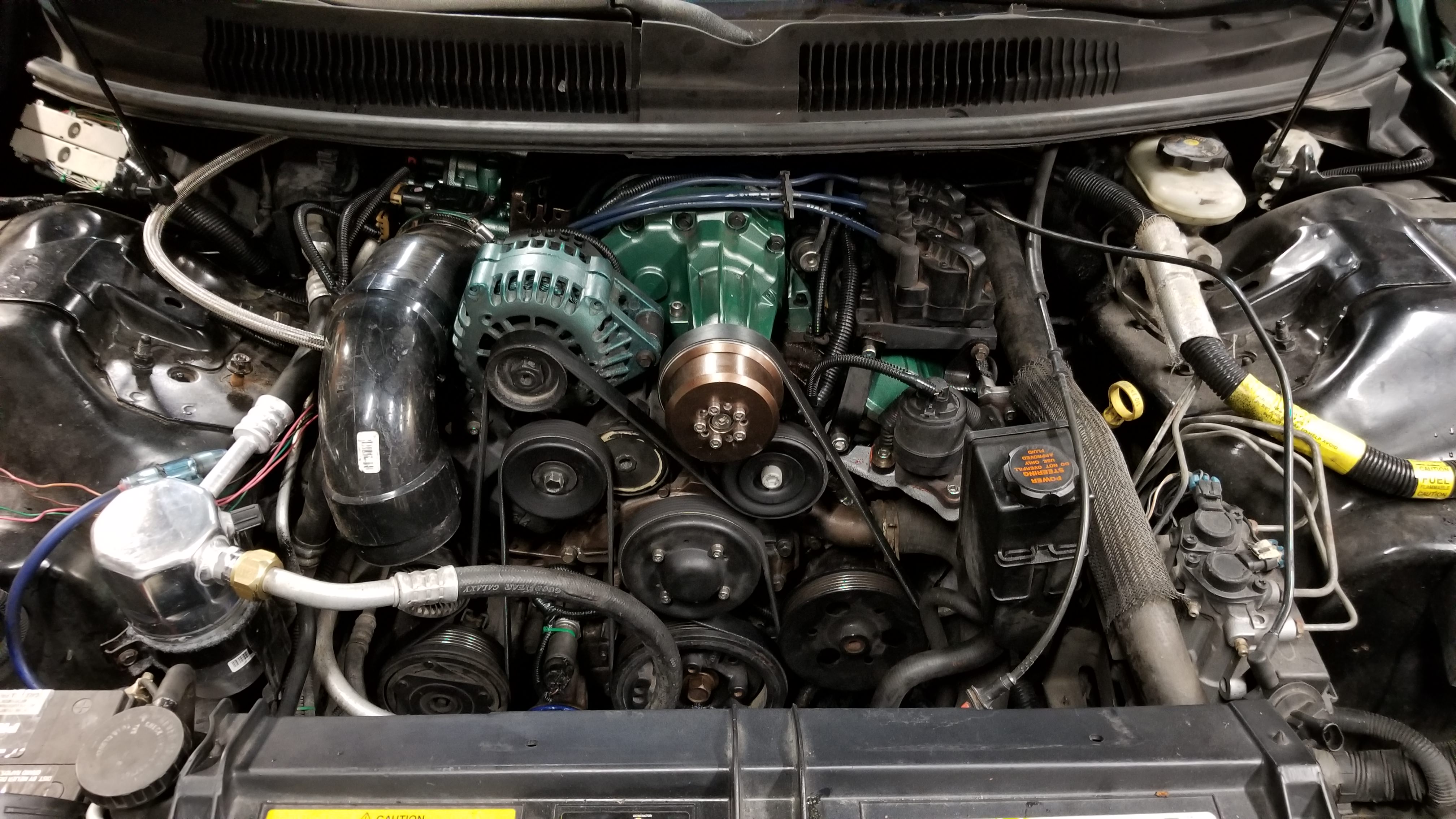

9. Belt drive - You can get away with several belt options. None of them are going to have very good belt wrap, and will likely slip:
I added one idler pulley, changed the belt path, and increased the size of the tensioner and idler pulleys to be able to use a standard size, readily available 136" belt from a Duramax:

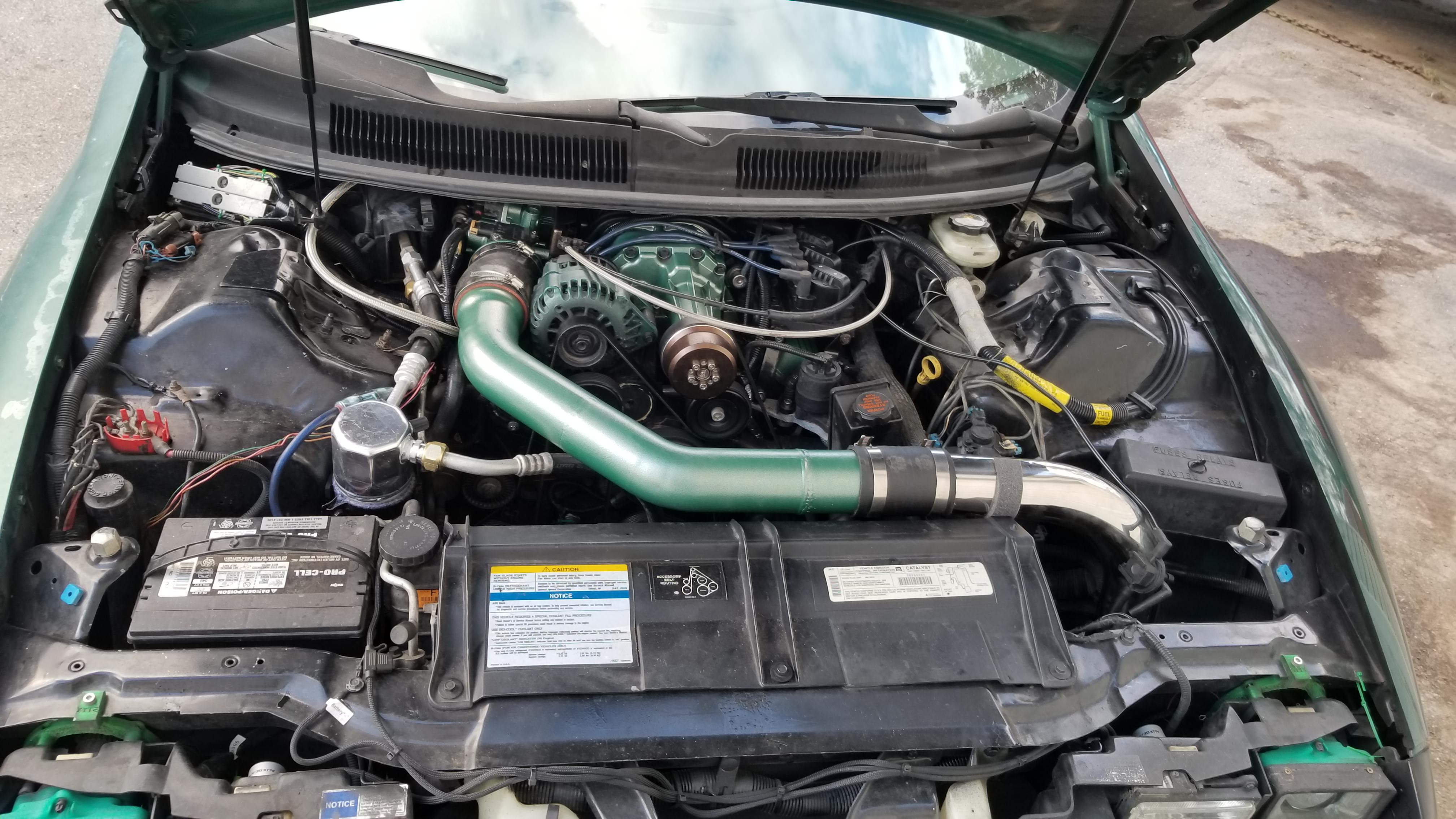

10. Intake ducting. I tried to keep this simple. I'm using a 3.5" diameter offset coupler on the throttle body, then used a 3" steel tubing to complete the path to the air filter, which is located down inside the fender.
