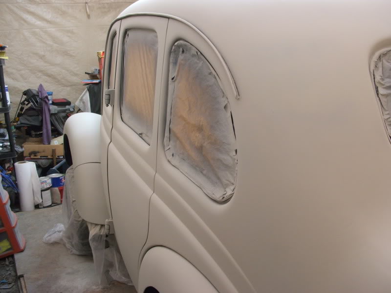

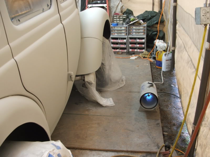

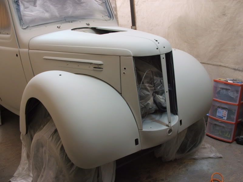

After a couple days of stripping and sanding, I shot the high build primer today. Bought some locally that is designed to be shot directly over bare metal or primer, so I wouldn't have to seal it again. Spendy stuff by the time you get primer, actuator, and reducer!
I've got the little heater running for a 90 min. cure, but I also used fast reducer to elimnate difficulties with cooler temps. Seemed to work, as it dried quickly and had no wrinkle issues this time.

My little 35,000 btu heater at work. Kept things in the high 70's inside the canopy on a high 30's day!

Tomorrow I'll start blocking out the primer and maybe be ready for a pro to finish it for me in a week or so!
