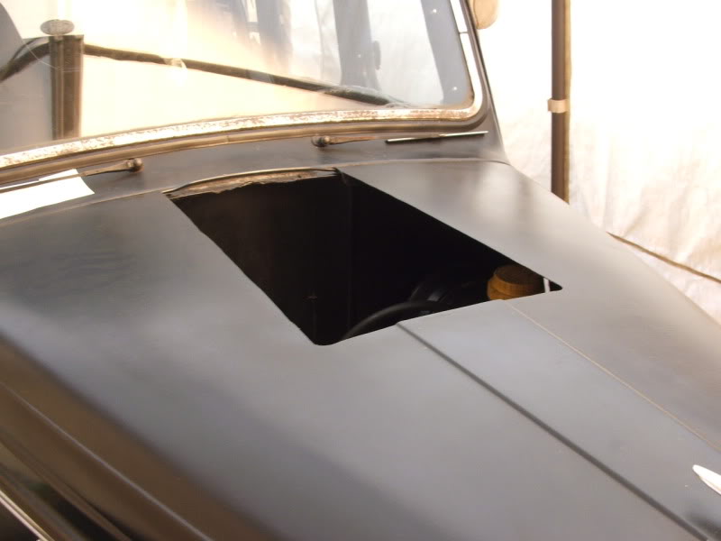

Summer is over, the cruises are all done, and both cars are converted to winter storage insurance. $2ea. for 6 months!! So it's time for the fun to begin!
There's a big hole where my Hilborn scoop used to be today!

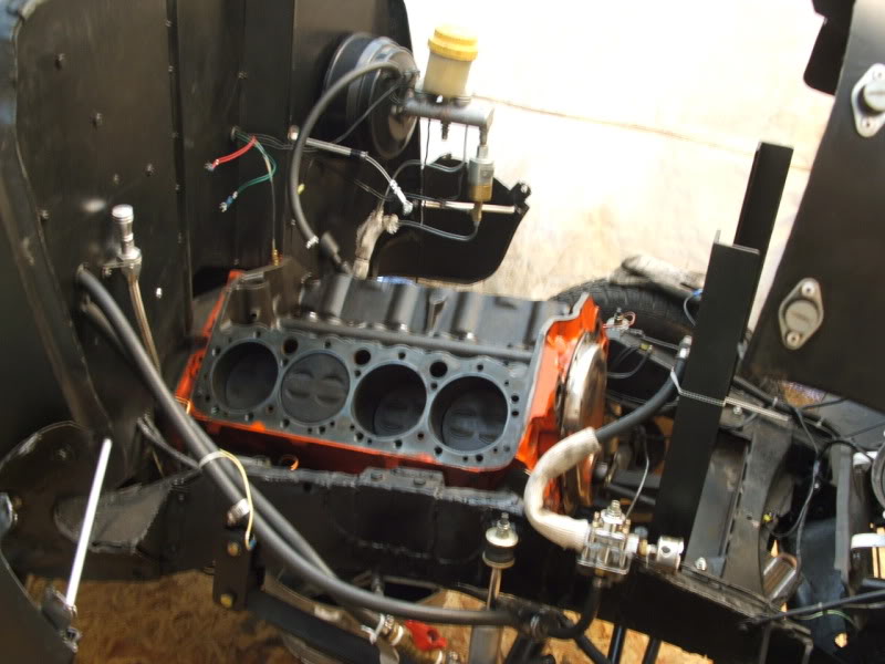

Got out this morning and tore the 327 down to a short block in preparation for upgrades.
Good news is it looks like new inside, and still signs of crosshatching on the cylinders from the .040" overbore it got just before I purchased it last fall. Tommorrow I'll pull the pan, timing cover, timing chain and cam. While it's apart I'll also pull a couple of rod and main caps to inspect the bottom end.

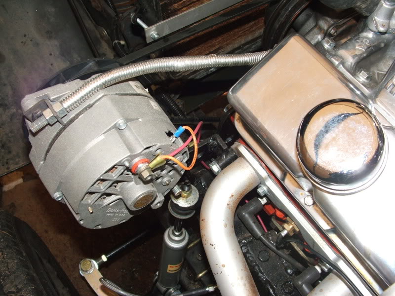

Here's an old pic before I removed the stock heads:
