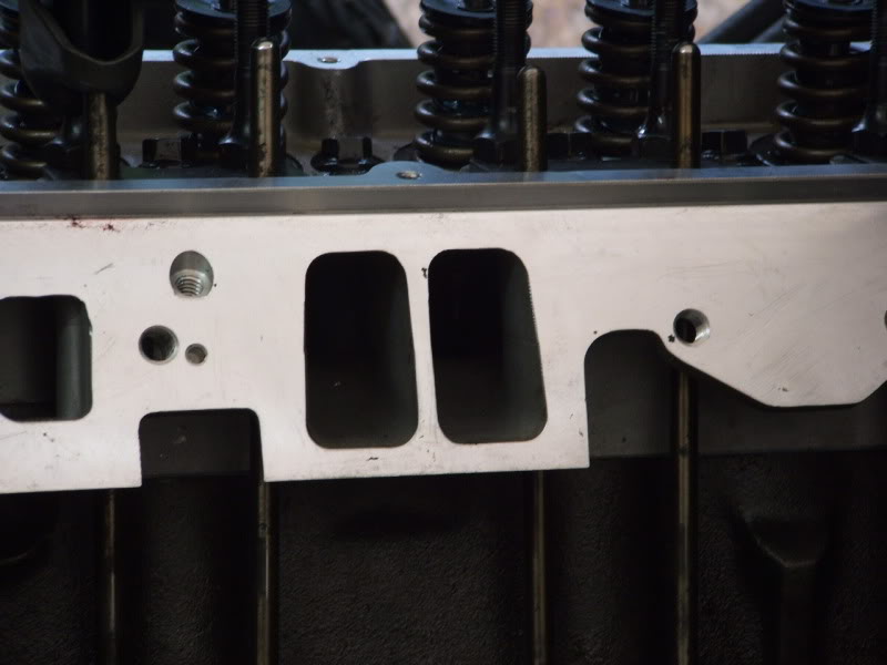

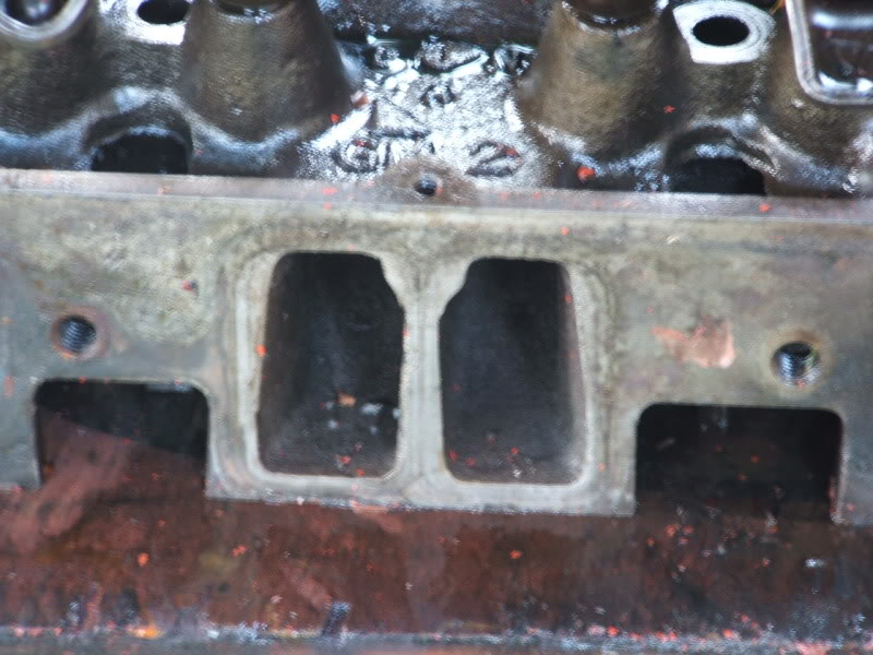

Got the heads installed and torqued, and I'll wait until tommorrow to check the torque again. I was looking at the intake runners and they sure are much improved over the old 882 heads I removed!
Here's a shot of the 882's:
Here's the new runners:

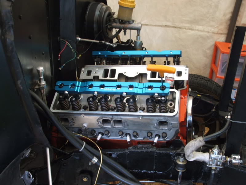

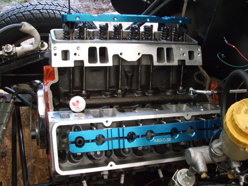

Did some test fitting of the roller rockers to ensure they ran across center on the valve stems. All looks good, so I wont need to change out pushrods to use the new 1.6 rockers. Also test fitted the stud girdles to see how they fit.

Thats awesome. AFR drilled those heads so a Vortec intake will bolt on. I want a set badly. I just can do it without one last try with the Canfields. Your gonna love it.

You must have read my mind! I was wondering if those weird vertical threaded holes were for a Vortec intake. Do the Vortecs only use 4 bolts on each side? (nevermind, brain fart. I know they use 4 bolts.)

One other thing I noticed on these heads; the height is taller than the old heads. The valve cover sealing area is raised 1/2" on the ex. side, and 3/8" on the int. side. Just enough that my new welded valve covers have about 3/8" clearance to the stud girdles.
Good thinking on their part, as I couldn't use the girdles had they not raised the casting surface!
Old Oct 31, 2011 | 10:15 PM
  #148
Thats exactly why they're raised. I would bet my lunch your going deep 11's at least. The only thig stopping you would be traction. Not always a bad thing.
