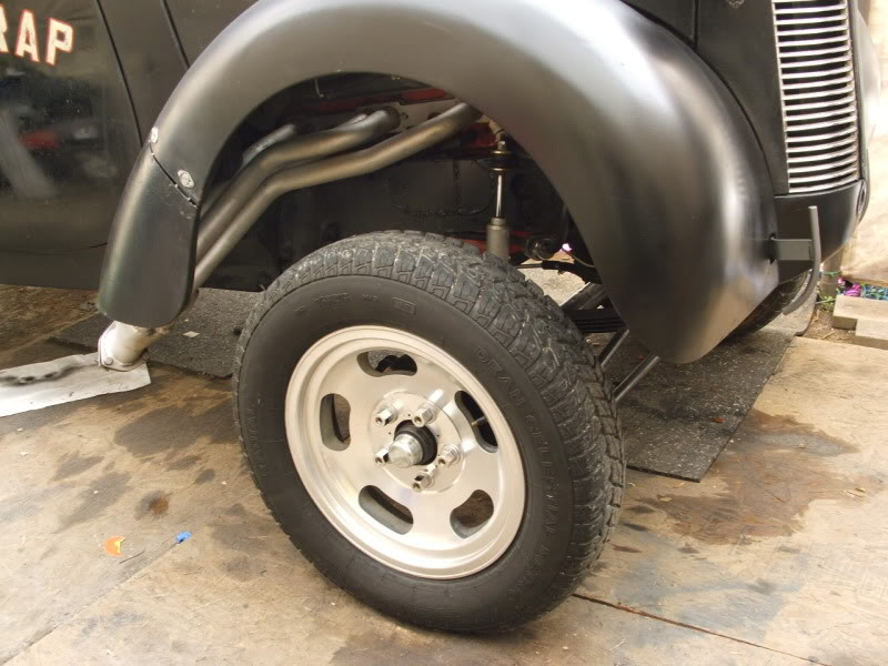

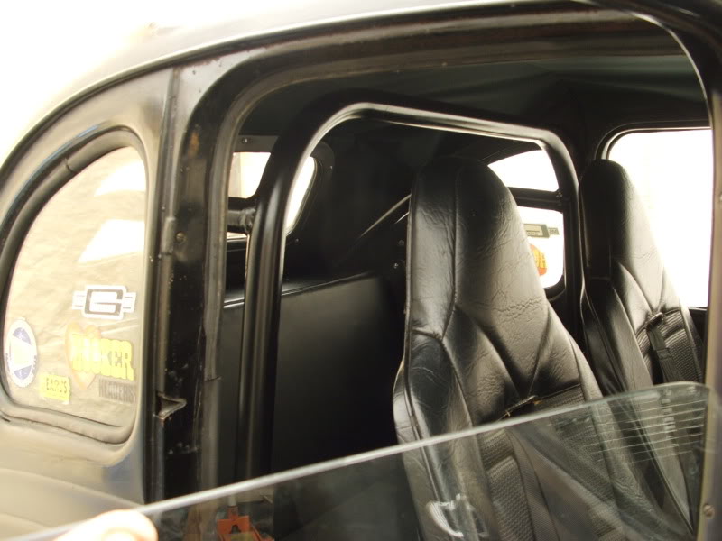

Finished the 4 pt. roll bar this morning, and got the new tires and wheels put on that I got from one of the members on the Gasser Forum for the front.
Here's the rollbar, a whopping 41" wide!:

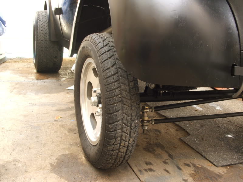

And the new to me skinnies up front. 2" narrower than before, and an inch taller:

I LOVE the column drop.. love love love love it!
Old May 28, 2011 | 09:14 PM
  #44
Ha, my tool box is 42". I can't imagine sitting side by side in that space.
Old May 28, 2011 | 11:11 PM
  #45
Thanks a lot! Can't take credit for the idea though. I saw a few done that way back in the '60's, and I figured if it worked then, it would still work. But it does get a lot of comments.
Old May 28, 2011 | 11:14 PM
  #46
It's a little narrower than the body, but not much! The inside of the car measures 43" door to door. Plenty of room!

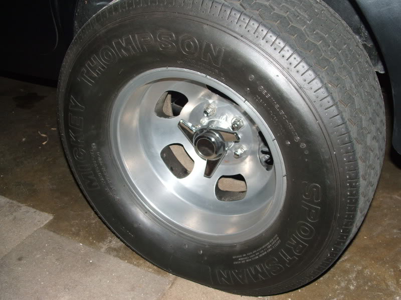

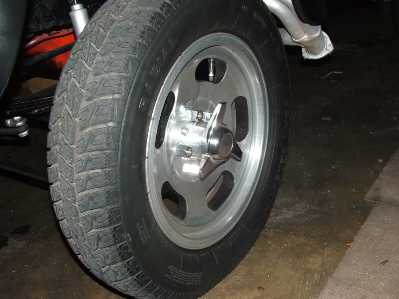

Picked these knockoffs up at the swap meet last weekend! They are threaded to the base, so you can knock them loose to access the lug nuts. I had a pair of straight winged ones, but was looking for a set, and foiund these cheap:
