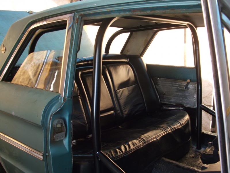

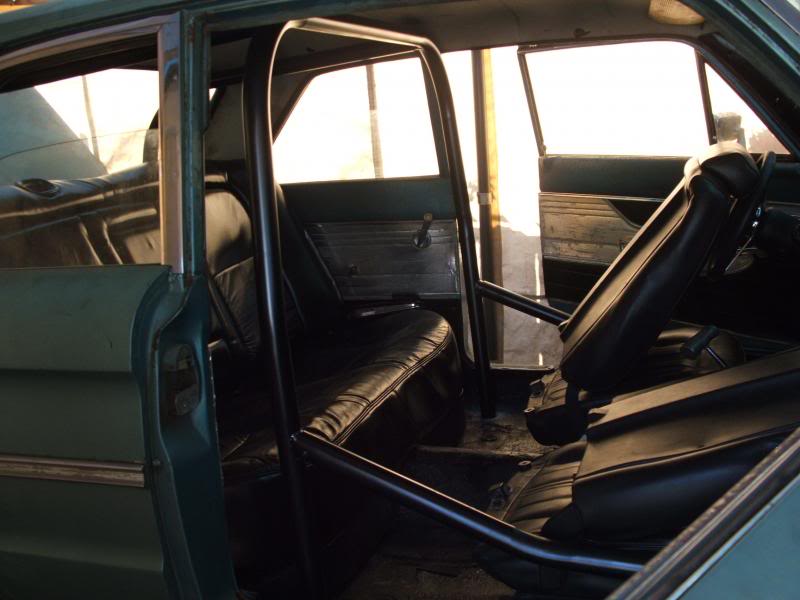

Pulled the Austin out so I could have a level concrete floor to bend tube on. Got all the pieces bent up, and trimmed. Then I tacked on the heavy wall stubs for the removeable front and rear braces. After some adjusting I got them lined up and welded them permanently in place. Then I cross drilled all the supports and stubs and pulled it apart. After that I drilled the braces out for 3/8 button head allens, and tapped the heavy stubs for the same.
Sanded it all and shot it satin black. Then just bolted it all in place with 3/8 bolts for the base and ends of the braces, and the 3/8 allens in the braces. After I finished mine, I bent up Jeff's for his '56 gasser. He's going with a 4 point, so it went pretty quickly. We ran out of daylight, so have to do his welding later.

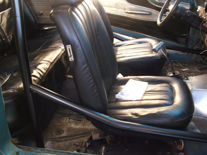

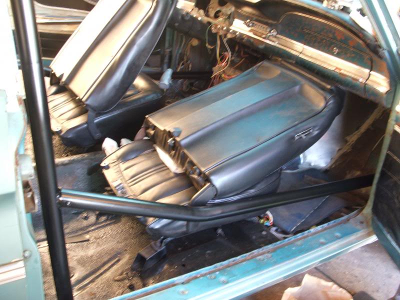

Made the side braces low enough to get in and out easily without having to trip over them, or be a contortionist.
