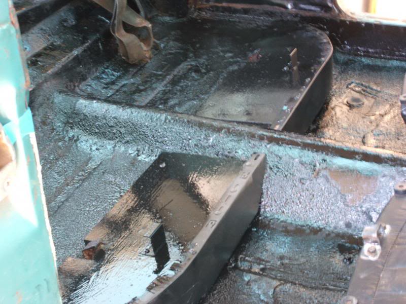

What a gorgeous day to work out in the canopy! Hit about 70 degrees, and half of my work was outside the canopy dying the backseat and some armrests. While the dye was drying I cleaned and painted the rear floor area. Gradually working my way forward to the firewall!
The rear package shelf was pretty bad, and like the floors, covered in gold carpet! So I made a template of the pieces and traced it on 1/4" plywood. After cutting it out I covered it in black naugahyde and slipped it in.
All the painting was with a brush, so good heavy coats to prevent future rust! These are the bases I built to fit the rear seat to the floor.

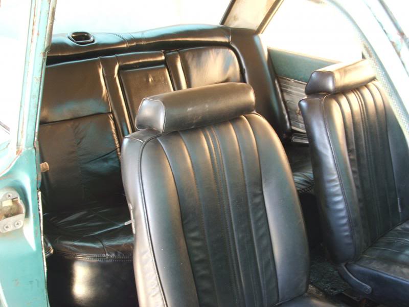

The stainless trim came off the armrests easy, so I could dye them without masking.
Backseat was tricky with all the sections, and had to dye things one way, then open it and dye another, and another, etc...
The backseat looks way better than the front until I pull them to get recovered.
I hope they look as good in the car as they do in the pictures. Excellent dye job. What kind of dye did you use? Spray can or rub on?

It's Duplicolor spray dye. Since the backseat will rarely get used it should hold up fine. I've used it on front seats and it holds up, but the piping, and edges usually wear sooner.

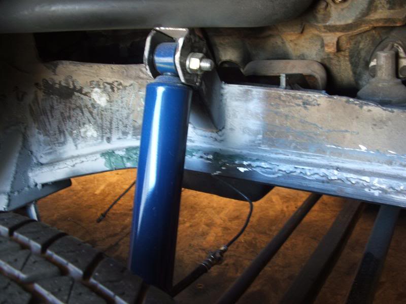

Got the new shocks, and built the shock mounts. Took half a day to do them, and probably a bit overkill, but they will show with the frontend open, so wanted them to look good and be strong.

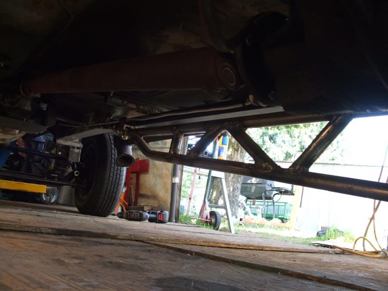

After getting the car out I gave the work area a good cleaning. It really needed it! The postman came about that time and dropped off the new gas tank! Perfect timing! I rolled the car back in the canopy and after putting some double sticky foam down on the trunk floor, I dropped the new tank in. It's definitely deeper, as it hangs down a couple inches more than the old tank.
With the tank in place I got my 3/8" line out and bent up the fuel line. Then I strapped it to the frame with straps and taped both ends closed for now. I put 3/8" rubber hose over the line everywhere it came in contact with any metal to protect the line. Did a 180 degree bend at the tank so the hose can be a straight piece to connect it.
Ran it along the inside of the new subframe connectors to protect it from any possible damage.

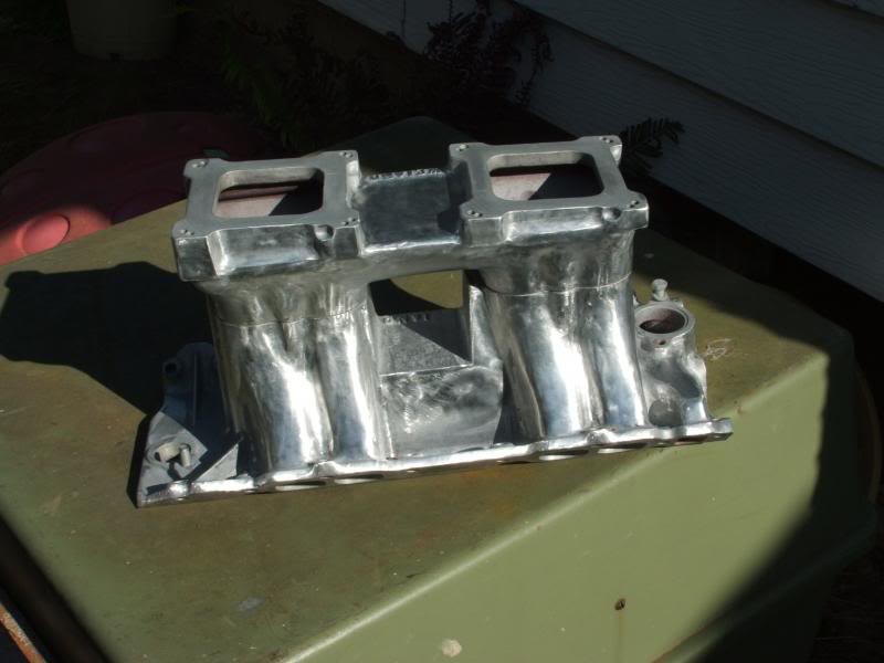

After finishing the fuel system I got out my sanding pads and die grinder and started smoothing the tunnel ram out. I'm going to give a try at polishing it myself, and see if I can get it acceptable. If I can't, I'll live with however close I get.

Stopped by Harbor Freight and bought one of those miniature sanding disc setups for the die grinder, with quick disconnect discs and polishing pads. Stripped all the cast finish off the tunnel ram and then gave it a light polish. Not super high polish, as I didn't want that level of shine, but didn't like the as cast finish either. Something inbetween.

And the upper shock mounts I built last week.
