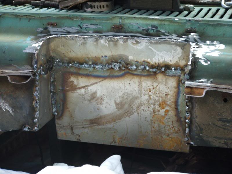

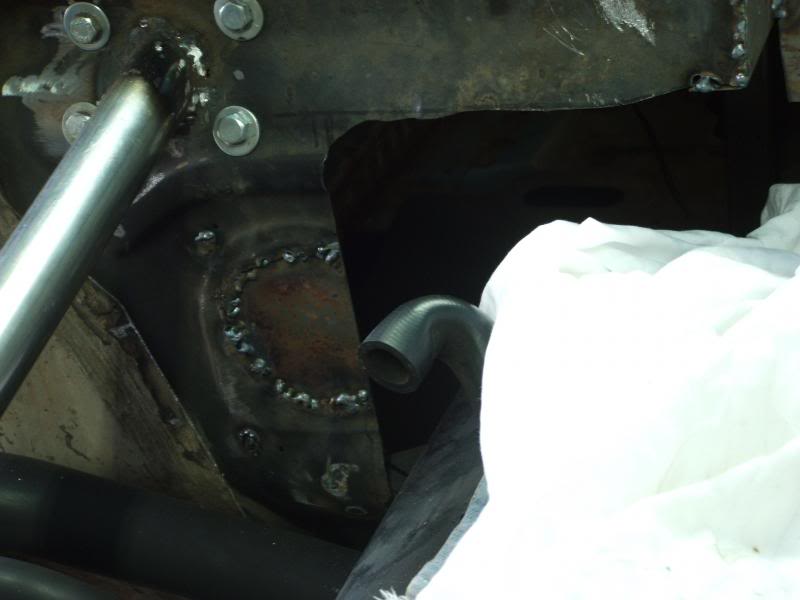

When moving the motor back that far, will you have to do any work on the firewall or do you still have the clearance you need? Love the motor mock up!!
Old Mar 28, 2013 | 09:51 AM
  #113
Yeah, just a little work. Like filling this big hole!:

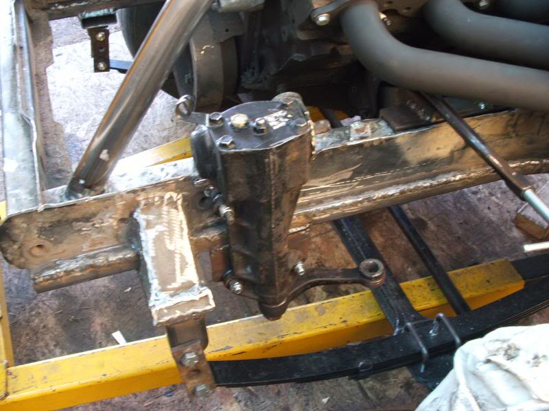

Got the mount built for the steering box today, and cut the key out of the pitman arm to reverse it. Had to notch the frame for a gusset that is cast into the steering box. Drilled the upper bolt hole large enough to sleeve the frame and welded in a heavy sleeve for that bolt. I built a plate for the lower bolts and a gusset off the rear to support it. Box is very solid, and lines up perfectly with the column. Just need a double d shaft and joint to connect it.

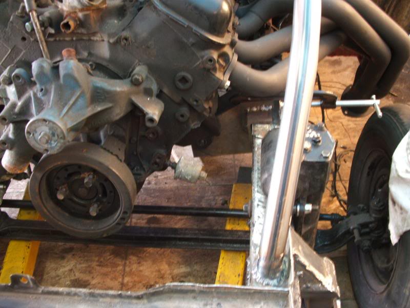

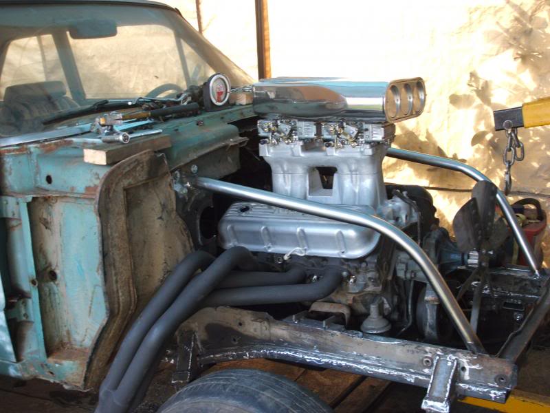

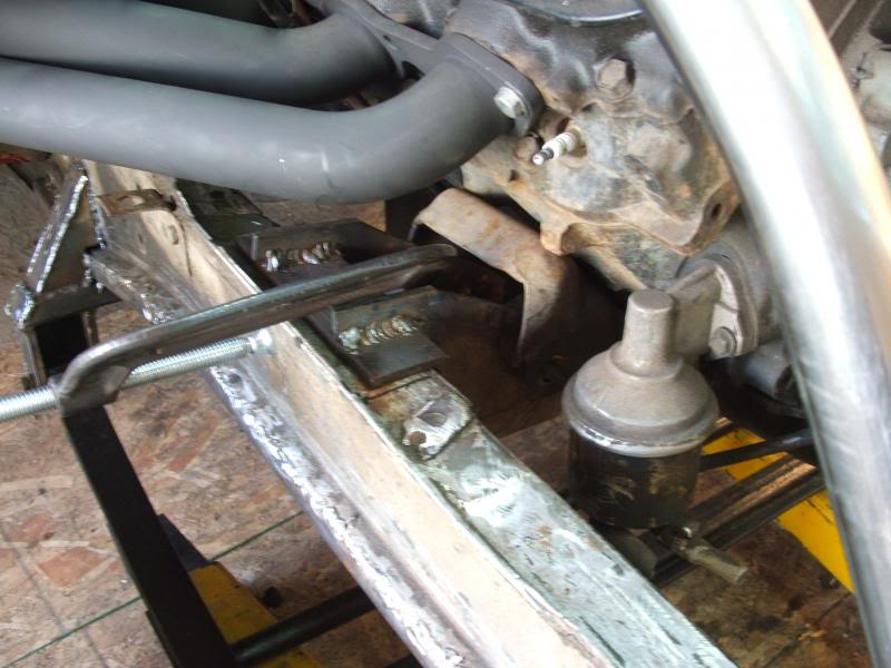

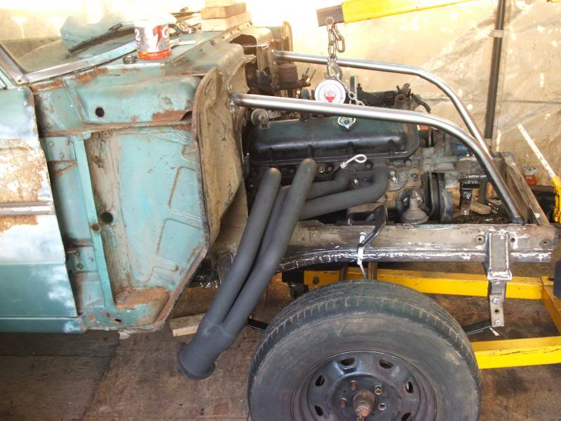

Asked my neighbor to help me move things around when we brought the cherry picker back. We put his snow tires on the back of the Falcon and pushed it out of the canopy, then picked the engine up and set it into the frame rails. Once I got it sitting down in the rails I did some measuring and cut some cardboard templates out. Then I traced the templates on flat stock and cut them out. Tacked them together and clamped them to the frame rails. I welded the plates to a piece of angle iron to spread the load over a large area, and get more weld area too.
The mounts are just clamped to the frame for now, and I can't remove the cherry picker until I get bellhousing and trans in place and a crossmember built. I couldn't put even the little 25" tires on the rear until I jacked the body up and put a 2x4 between the axle and frame, as there's no tire clearance until I radius it. I also noticed the rear axle needs to shift .5" to the passenger side before I do any welding, as it's not square yet.

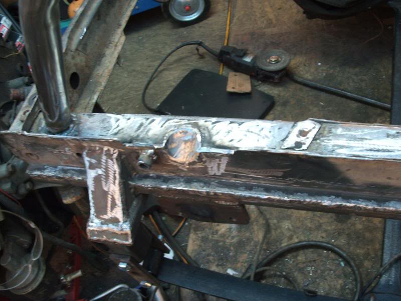

I need to trim some excess off the mounts before wleding them permanently to the frame. Left a lot of extra metal below until I figured out where the holes would be. I welded schedule 80 pipe between the frame mounts so when I tighten the bolt they wont distort.

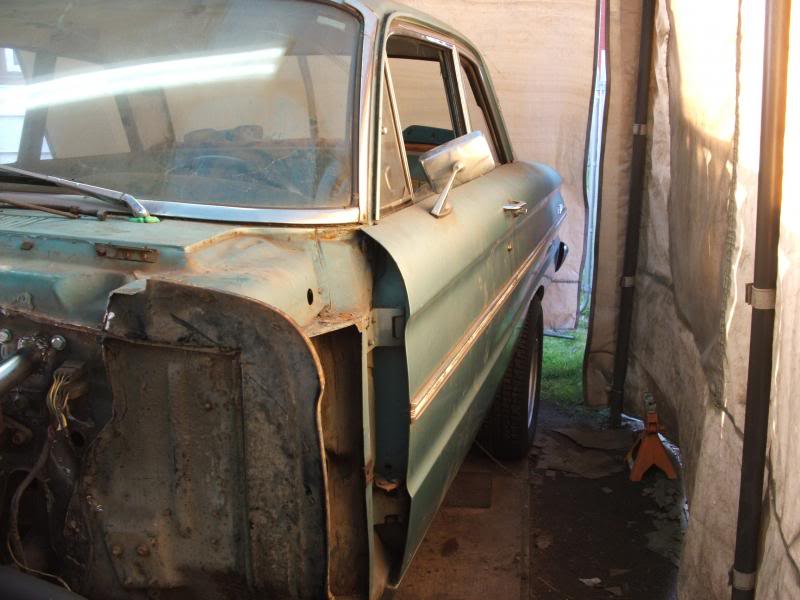

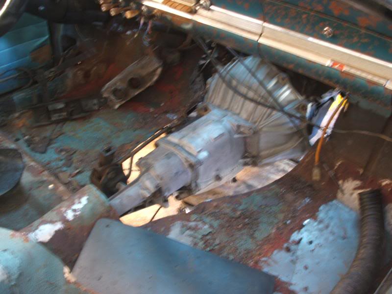

Got the engine slid back another inch, and then let the chassis take the weight so I could try the bellhousing and trans, but no luck. Had to get the trusty sawzall out and open up the floor also. The tunnel was just too small for the 4 speed.
Looks like I may have to open up the driveline tunnel a little more also, as the tailshaft of the trans is only about 1.5" away, and not sure the driveline joints will clear when in place. I still haven't gotten a yoke to fit the Super T10, so I don't have a way to check for sure. I may borrow the neighboor's driveline from his Camaro to slip in and see how it clears.

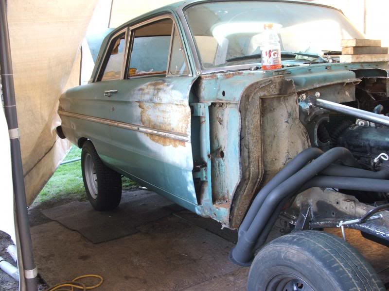

I started doing some sheetmetal work today. Got most of my floor and firewall framework done, and started to close up the cowl inset. I had to do it in two pieces to close the cowl first, and then finish the lower section, so the upper area could be sealed and not leak into the car when it gets wet outside.

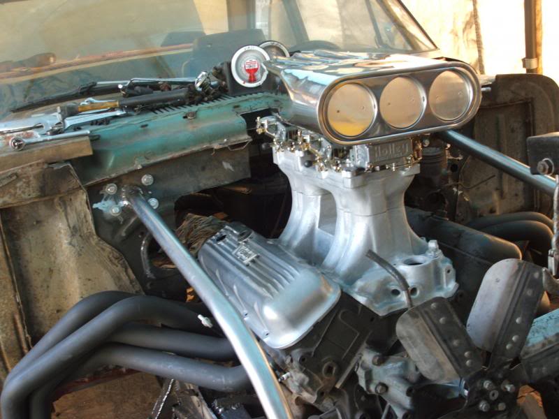

Of course I "had to" test fit the tunnel ram and carbs to ensure the cutout will give plenty of clearance!
Once I put the base plates on the scoop it will just sit above the hood level. That's just where I wanted it, so got lucky and wont need a spacer.
