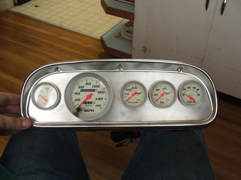

Went to the scrapyard today and got a piece of 16ga aluminum to build my dash insert. Not sure if I'll just scotchbrite it, do something fancy, or cover it in some material. Still have to wire all the lamps together and make my harness, but the holes are cut and it's mounted.

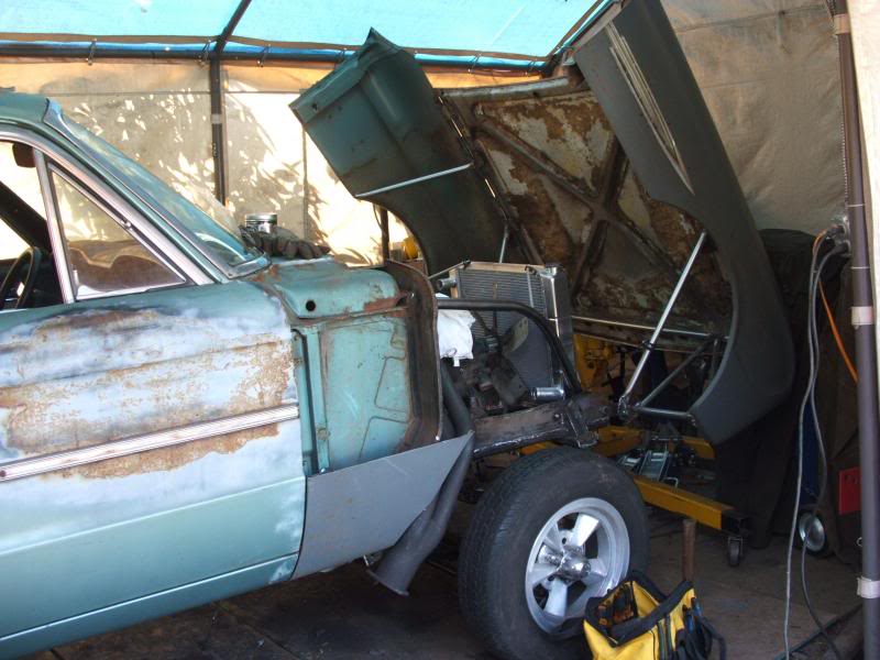

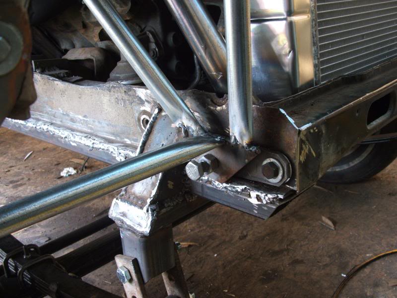

Wasn't going to work on the Austin after church this morning, but then some friends stopped by to see the progress, and the next thing I knew I was cutting and fabbing. Got the pivot pieces fabbed to make the frontend move forward 6", and then I cut up more EMT and tacked in braces to the upper framework, and one out to each side to keep things centered. The old bumper bracket bolts made a good place to attach without having to make any new threaded holes!
Once I test the function to ensure it tilts, I'll see if I need cables to restrict the forward motion as I did on the Austin. Looks like the pivot bars may go against the frame and stop it, but if not I'll grab more cables from a station wagon tailgate. I kinda lifted, but not sure if I'll be able to have a place to grab and open this by myself, or if I'll need assistance. Didn't want to try it until I have help, as the tacks I made are pretty small and may not hold if it gets away from me. Once it's tested and I pull it back off I'll go over all the joints with the welder and make them permanent.

Thanks Scooch! I liked the way the aluminum panel fit in with the aluminum factory edge trim.

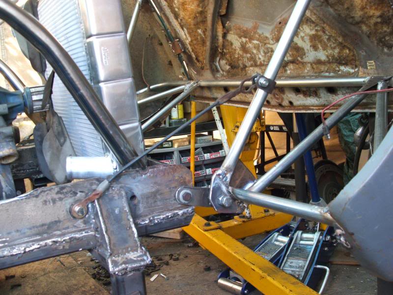

Picked up my newly built driveline today, and slid it in. Perfect fit! (as it should be!) Then we headed to the wrecking yard to get the cables, and found a pair of nice ones on a little Ranger truck. I also saw a Taurus SHO with a nice leather backseat that folds down in two sections, so grabbed that to replace the shabby and tattered Falcon backseat. At least I'll only have to get the buckets recovered, and not front and back seats!
Got back home and had my friend Mike help me lift the frontend back on the car again. We tied it with old scrap wiring at the place I wanted it to stop, and then I fabbed up a pair of straps to clamp the tube brace. Used a bumper hole in the frame for the other end, and bolted the cables in place. Once I cut the temp wiring it sits great!
The straps that connect the cable to the tube can be adjusted by loosening the throughbolt and sliding the strap up or down to vary how far the frontend opens when the cable stops it.
