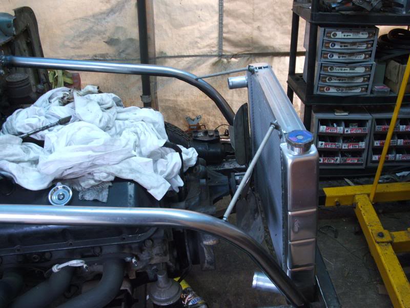

Today I decided to see how the new radiator fit, and ended up mounting it in the car. Two bolts drilled and bolted to the frame below, and then tapped the braces for 1/4" all thread rod, and sleeved it with some aluminum tube from my old TV antenna. It's really solid!

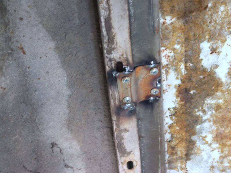

After that I bent up some 1/2" offset sheetmetal plates from scrap 16ga., and screwed the hood to the front fenders. Once I got them all screwed together, and checked alignment, I tack welded the plates to hold them better.

With all the plates tacked, and checked, I bent up some 3/4 EMT tubing and tacked it in place. Added angle supports to the corners, and also a separate support from the hood plate to the upper fenderwell opening to stiffen it once I separate the lower fender drops. Added a few extra plates in several places to connect it all and add to the strength. I'm sure I'll need a little more tubing once I figure out how the tilt system will function. It needs to go forward a couple inches before it opens.

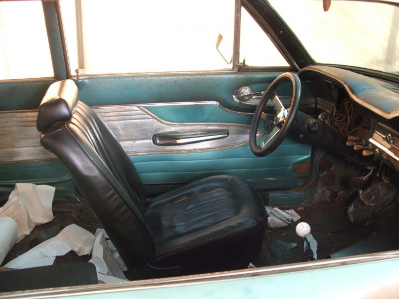

I put the "new" seat in the old holes and checked my seating position with the steering wheel, and it feels like I just need to raise the rear mounting points an inch or so and all will be great!

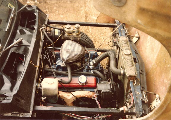

Lookin good so far. Some years back I built a V8 Datsun pickup, and made a hand laid glass front end. I had the same clearance issue, where the front end needed to slide forward before it could tilt open. I used barn door hinges, dismantled them, and bent some rod to use as the pivot. To open, I lifted and pulled the nose forward to flop the hinge, then the front end would clear in back when tilted. Drilled holes in the rod for clevis pins, and the rods could be slid out to completely remove the front end if desired. Picture is when the truck was still "in the rough".

That's a slick idea Chuck! I may have to incorporate something like that in the tilt hinges! Thanks!
Old Apr 11, 2013 | 09:09 PM
  #158
You're welcome. Figured it should give you at least a spark of inspiration. I like to improvise as you do, it's more fun!
