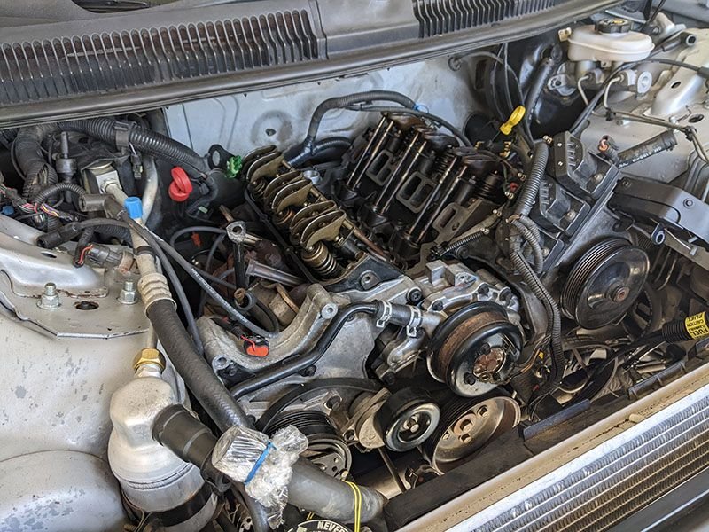

I have some pictures, before when everything was so dirty and I seem to have dried on oil and other grime around the area(s). Then as I've gotten things off, been cleaning and removing dried on gasket material.
Before - Oil pump drive
After - Oil pump drive

Issue I'm having with this: Lower intake goes on over 3 studs, the rest of the holes are bolts. I put the three studs back on and I can't get the lower intake to slide back on over them. It's close, but it doesn't quite want to fit. I'm not sure why this is.

I seem to have found the undocumented trick to this...you want to have the studs threaded but loose. I originally already had them tightened/torqued. If they are loose you can slip the lower intake on, then tighten the studs before installing the nuts/bolts.

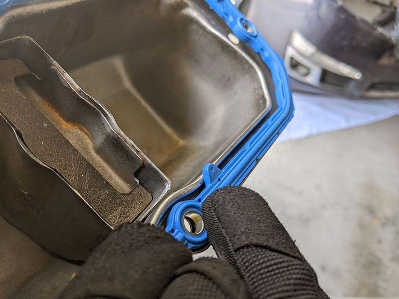

Another little issue I'm wondering about. I've contacted Felpro about this but I'll post it on here. I bought one of the 5x more expensive Permadry molded gaskets for the valve covers, but they have these 4 little inner tabs vs. the original cork and therefore don't fit down the same. I'm not sure if that's ok and it'll work alright, but it doesn't seem right to me. These gaskets are supposed to work for the older 2.8L, 3.1L and my 3.4L. All those valve covers are basically the same, so I don't know what the tabs are even there for.

Well you could just take a razor knife and cut them off,problem solved.

Yeah...it's just they are $40 gaskets and I shouldn't really have to modify them. I don't get why there are tabs to begin with, and why are they in that orientation? There's nothing for them to slot into to begin with.
