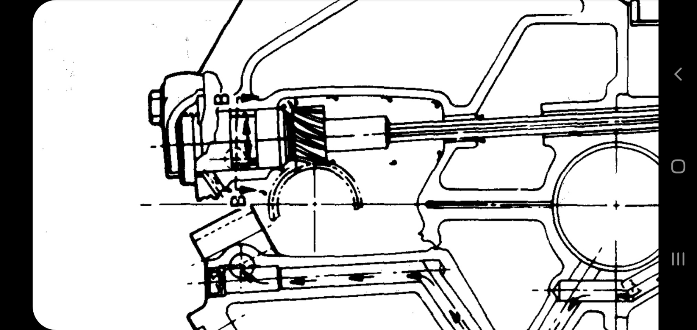

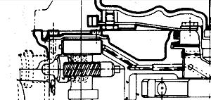

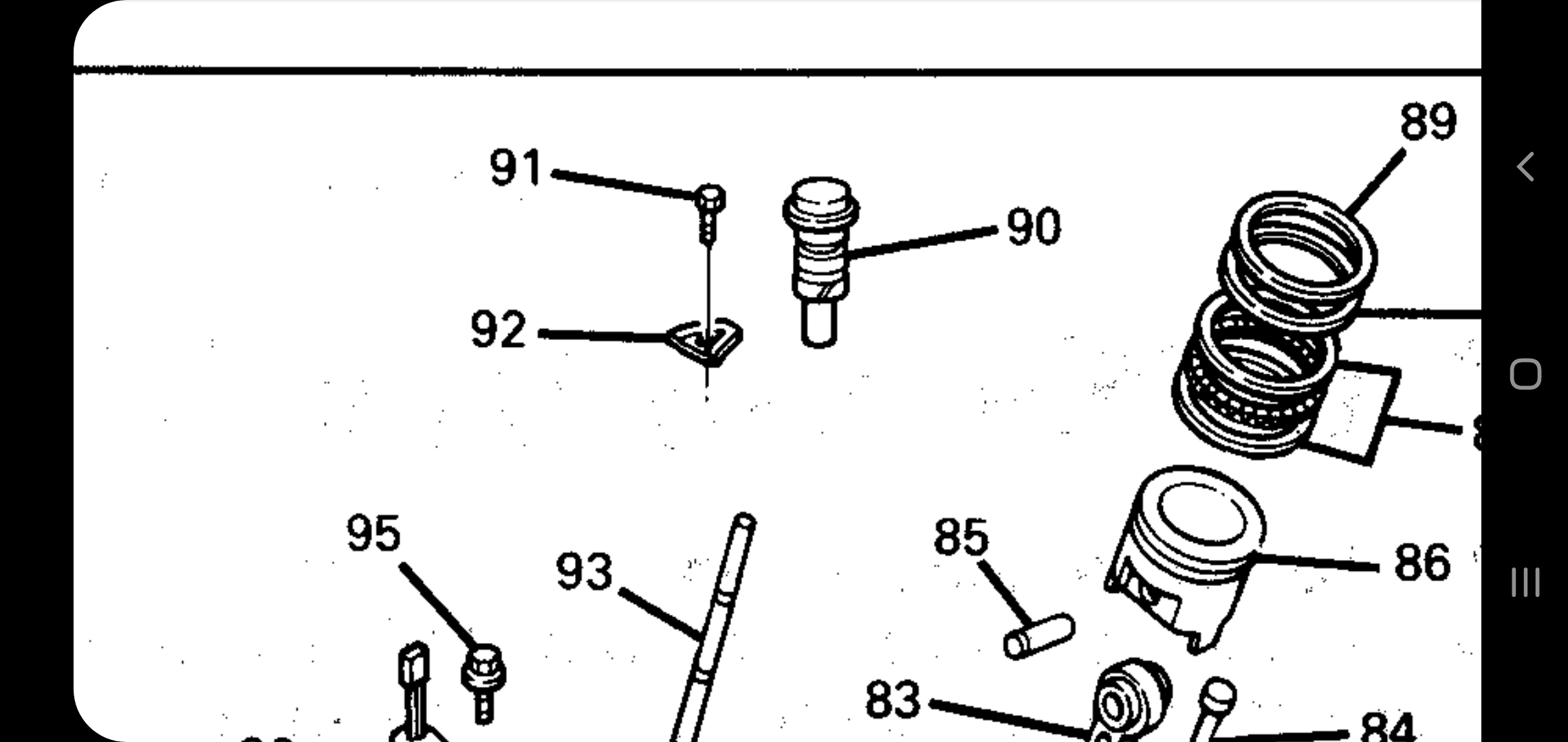

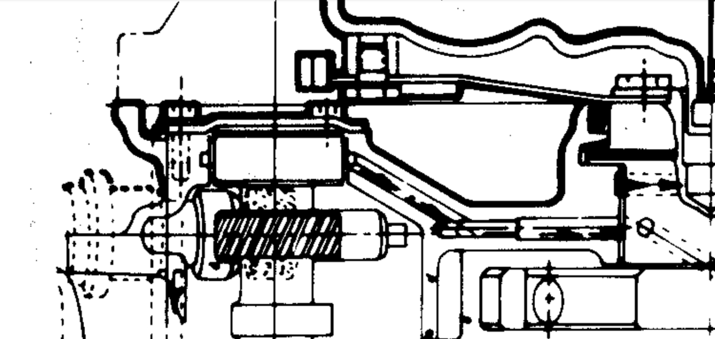

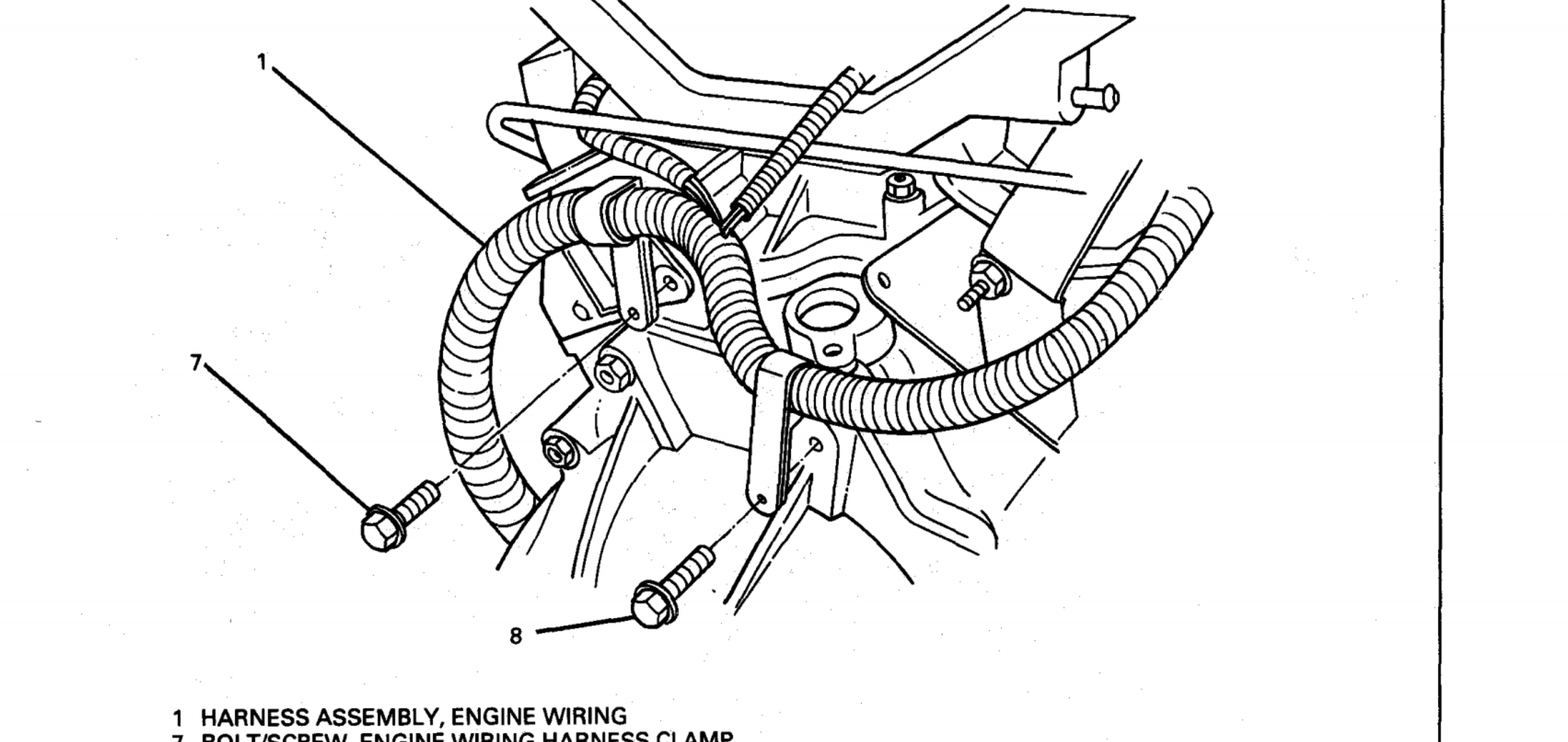

I have that leak also on my 94 3.4. I have been milking it. It does not look fun trying to get that cap off. From my research it has an o-ring. If you have some tips accessing it please share.

I got the oil pump drive out. Took some light and careful prying to lift it up a bit so I could pull it all the way out by hand. I've since cleaned it up and reinstalled it, with a new o-ring. I also did what some have suggested and bought a distributor gasket (Fel-Pro 70194) and with a light coat of RTV put that on the thing as well.
It seems it would be very hard to get to this without pulling the upper intake (at least). I have the upper/lower intake and the valve covers off, so it was easy to get to then
