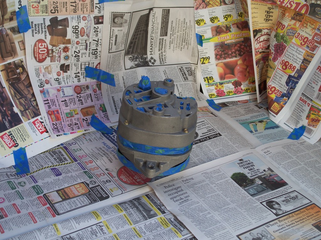

Taped up:

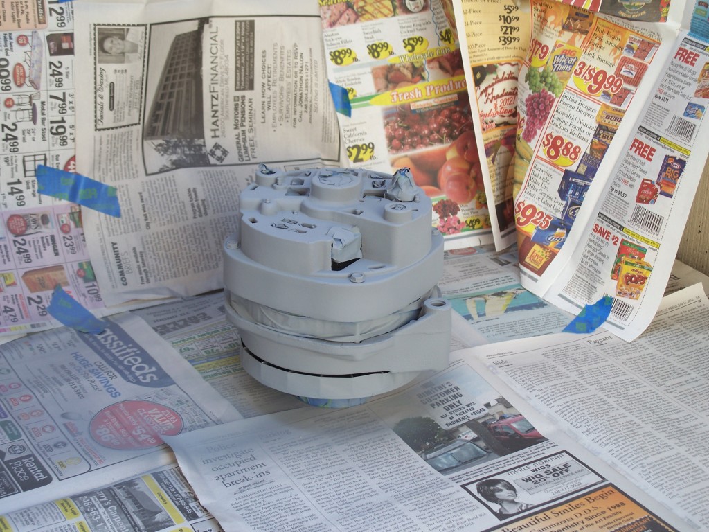

Primed:

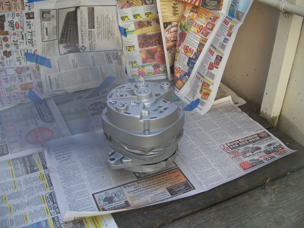

Paint & Clear:

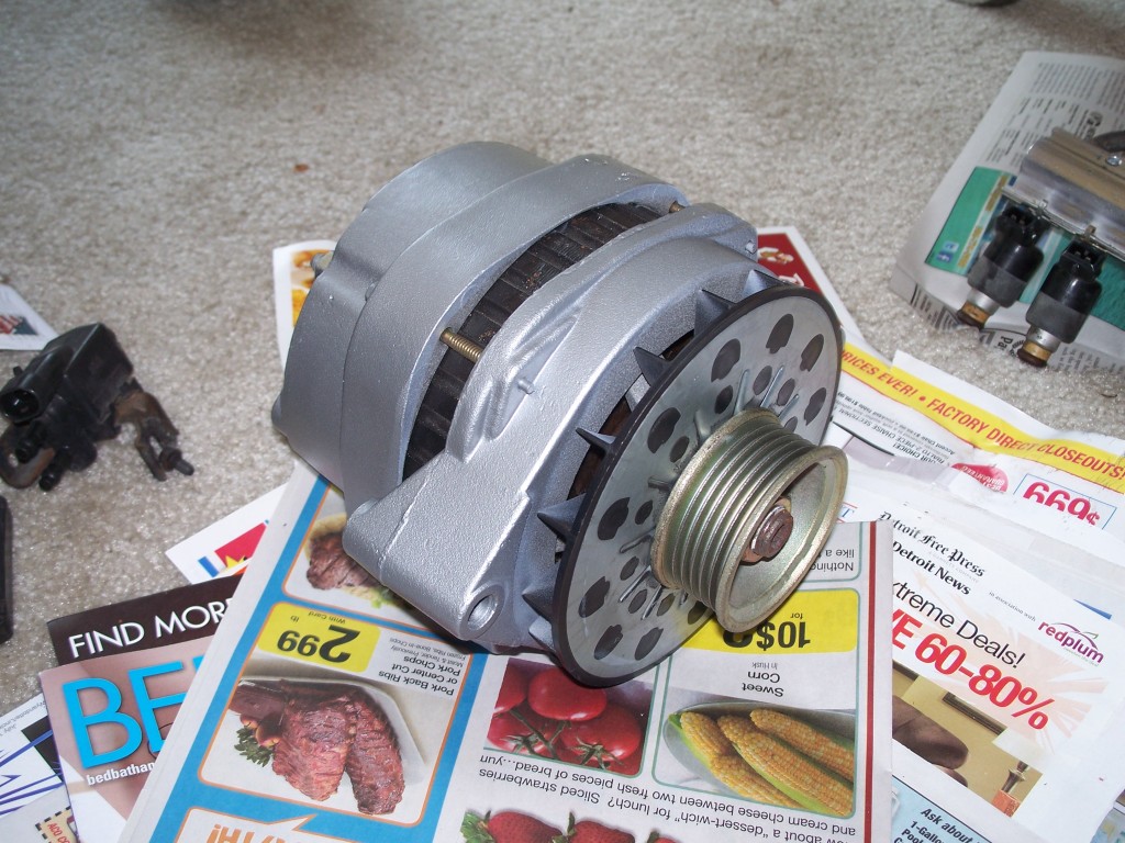

finished:

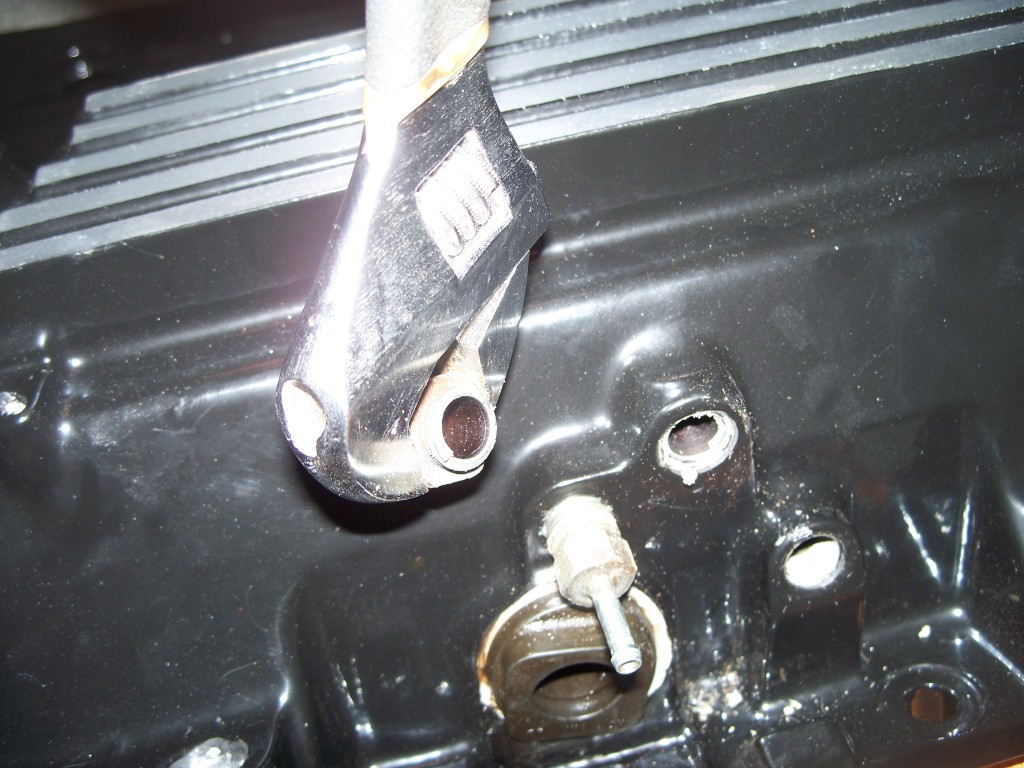

Disaster.
Tonight I was working on putting fittings back into the intake manifold while watching the Olympics. Then this happened:
I'm in a state of disbelief right now. I can't believe that happened...and I have no idea how the heck I'm supposed to be able to fix it...
Old Jul 30, 2012 | 09:33 PM
  #368
Posts: 22,042
right you cant get them back in the same place. i would at least try to get em in right side up. look for stains or wear that looks like it belongs up or down. in 10k miles maybe have a look at em to see how they are doing. could be fine could be not. maybe in 6 months you will want new pushrods,,, and 1.6 rollers. can you get a easyout on that pipe to get it out.

Old Jul 30, 2012 | 09:48 PM
  #370
Posts: 22,042
its broke off inside there right? at least thats what it looks like from the picture. ez out,,, ill be right back. ok this style works best for me on pipe http://www.tooltopia.com/atd-tools-3...aign=nextag_r1 should have em at a hardware
