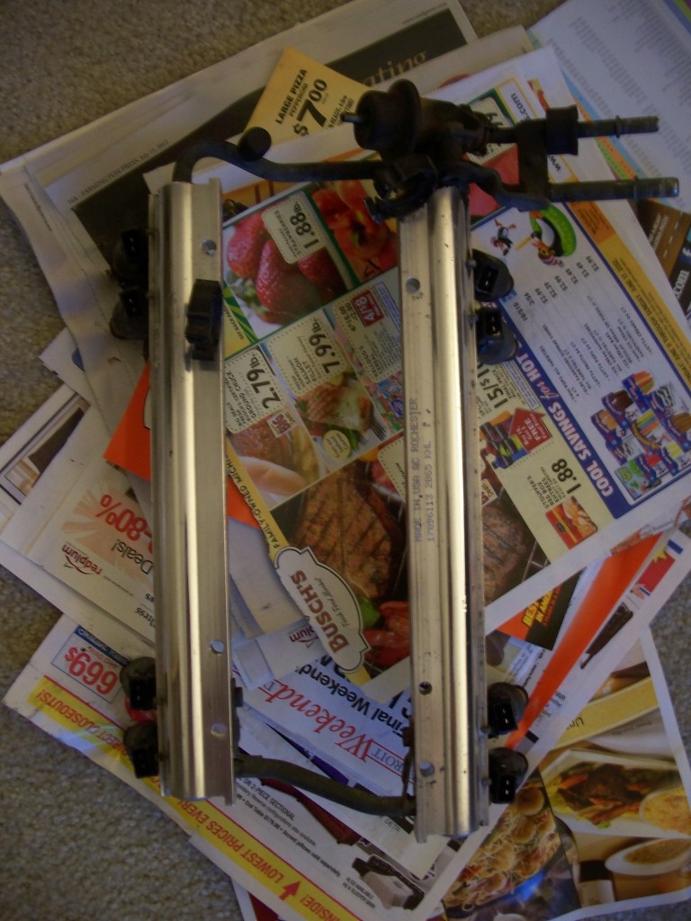

better picture of the polished fuel rail:

Rail looks nicet, you do good work.

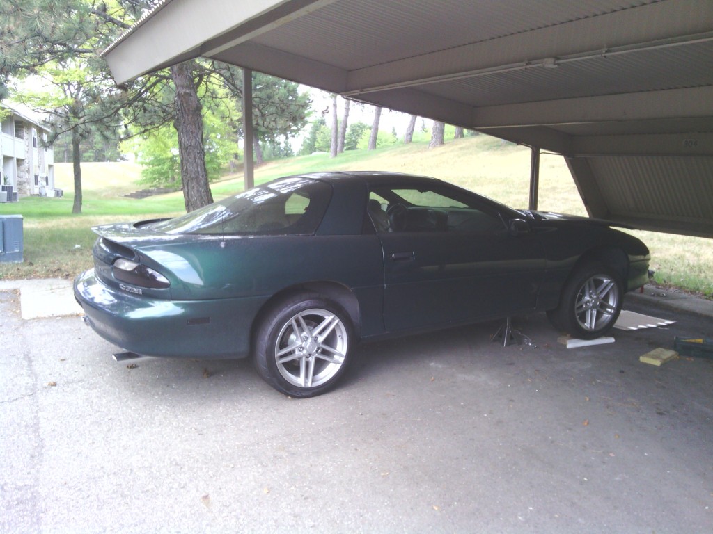

well here's how it sits now:
I seriously need to get a new jack. The one I have is worthless. It took me way longer than it should have to get up on those stupid jackstands. I had some trouble trying to remove the fans. They come out the top, don't they? They weren't coming out as easily as I remembered...do they have to come out with the radiator and condenser at the same time?

You should be able to get them out by themselves. I can't remember if I pulled them through the top or down the bottom..but I know it can be done. Did it when I had to change the opti.

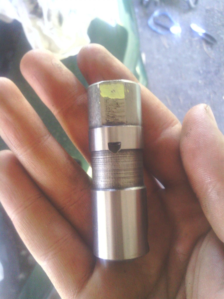

Thanks. Also, does it matter how valve lifters are oriented? does the oil feed hole face in or out?

Here's a picture of what the lifters I have look like, including the oil feeder hole:
the ones I took out didn't have that little hole on the side, which is why I'm concerned if they have to go in a certain way.
