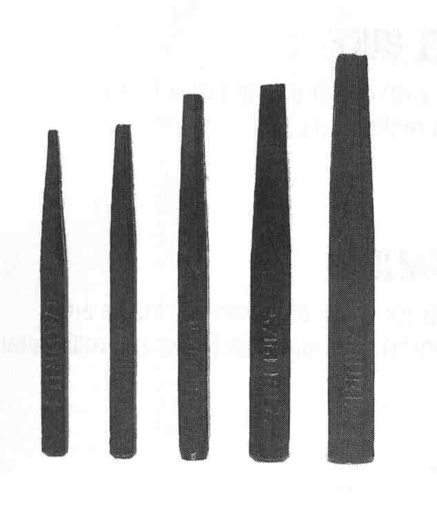

Old Jul 31, 2012 | 06:03 PM
  #376
Posts: 22,042
sears should have em, need to get the right size so take the broken piece with you to make sure its the right fit. heres a picture of the pipe extractors style that you will want

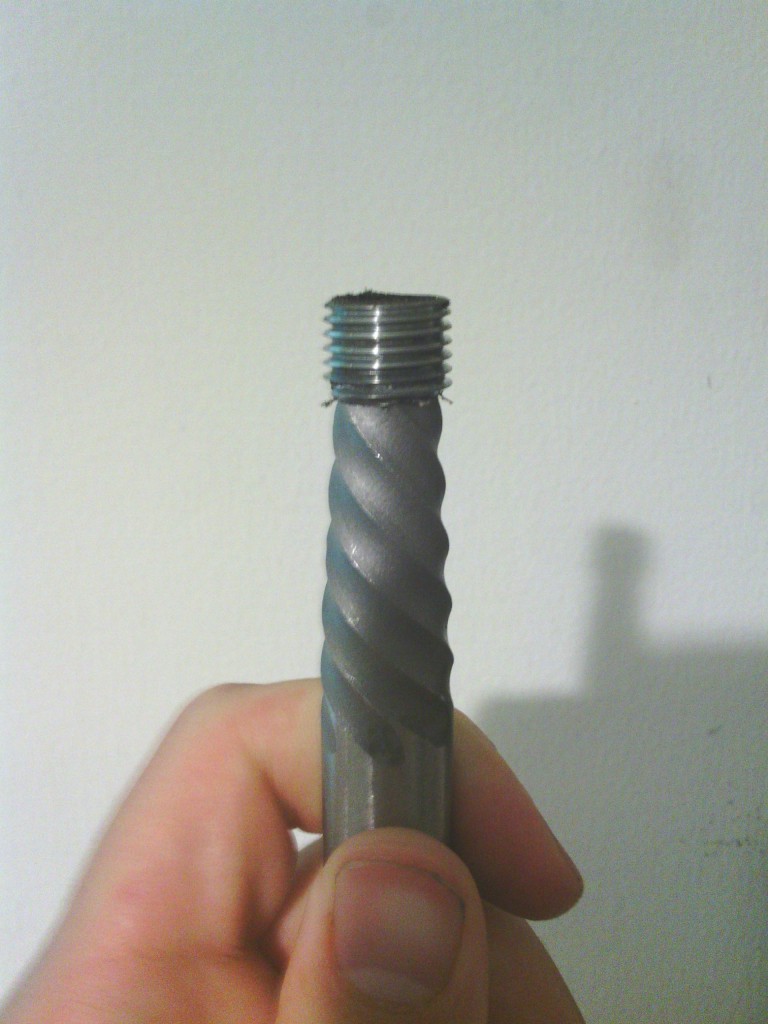

Did my valve lash adjustment today. Still haven't gotten that fitting out of the intake manifold. My dad suggested getting a saw blade and cutting most of the way through the stuck part of the fitting. He also said that screw extractors don't work as well for stuff that threaded in pretty tight. I haven't had much luck with finding decent screw extractors anyway. Still figuring that stuff out.
it's out!
As it turned out, the screw extractor that I originally thought would be too big worked beautifully. I think I'm going to give the powdercoater a call though. I really struggled to get any of the fittings started, and this happened as well. I might see if he will try to clear some of the powdercoat from around those threads, hopefully that will help. Then, since I'm holding off on the opti, it's time to start putting stuff together!
