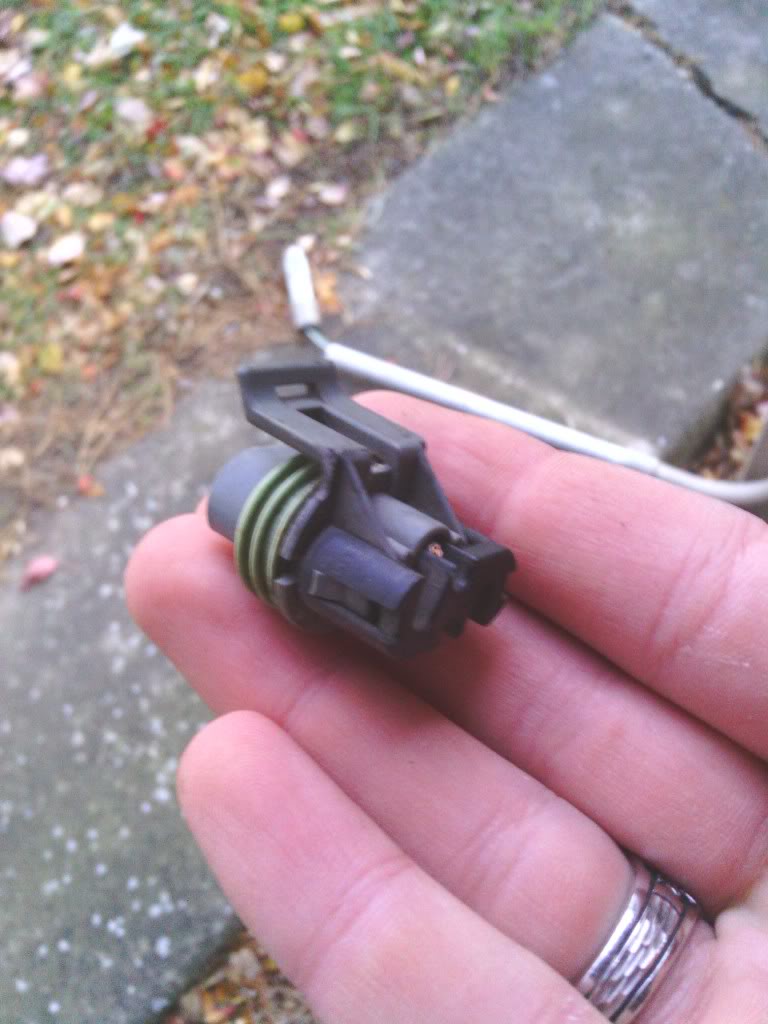

Well I think I found my culprit:
Reached my hand around to the back of the engine where the oil pressure sending unit is this morning before work, and found this: the plug is completely severed. No idea how that happened...

I only let it run for the two minutes because I got scared and shut it off. I don't think the oil pressure needle moved the entire time--that is, it was at that position before I started it and well after I shut it back off.
Any thoughts?
If I were to guess, I'd think your oil pressure sensor is broke.

Well I got that figured out now...but is the engine sound in the video due to an oil issue or a valve adjustment issue? Do new hydraulic lifters need some time for oil to work through them?
