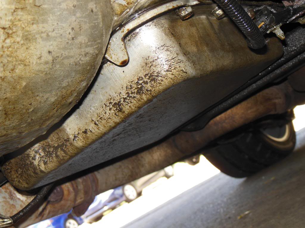

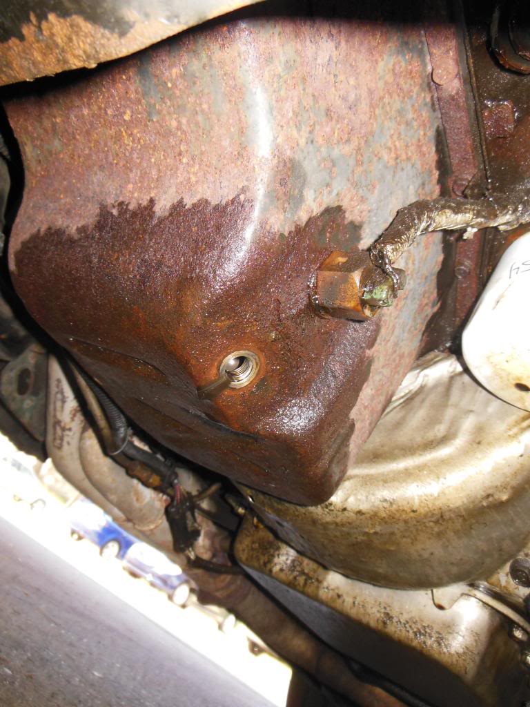

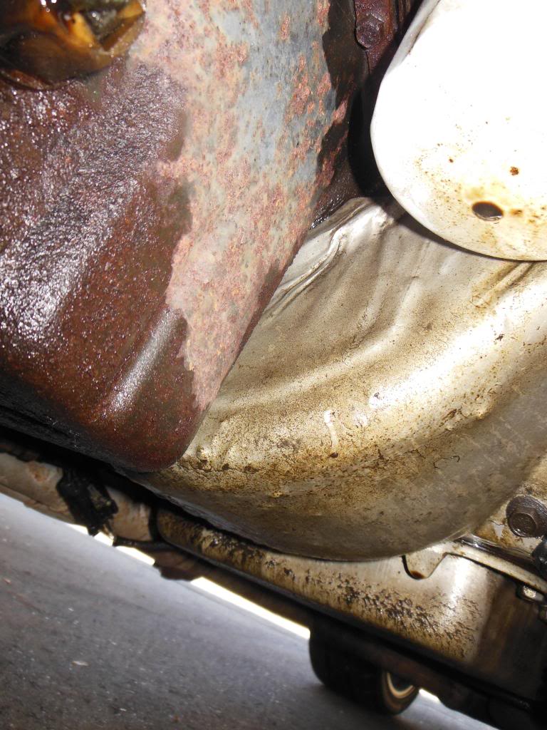

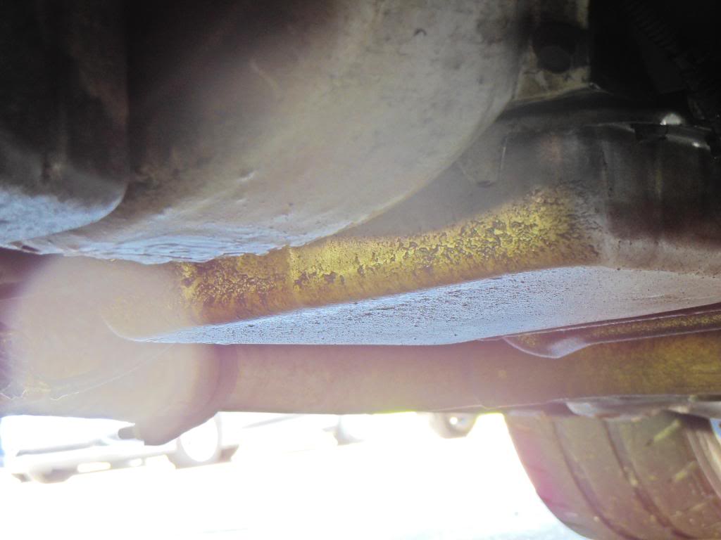

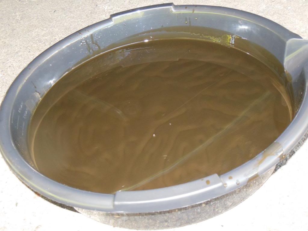

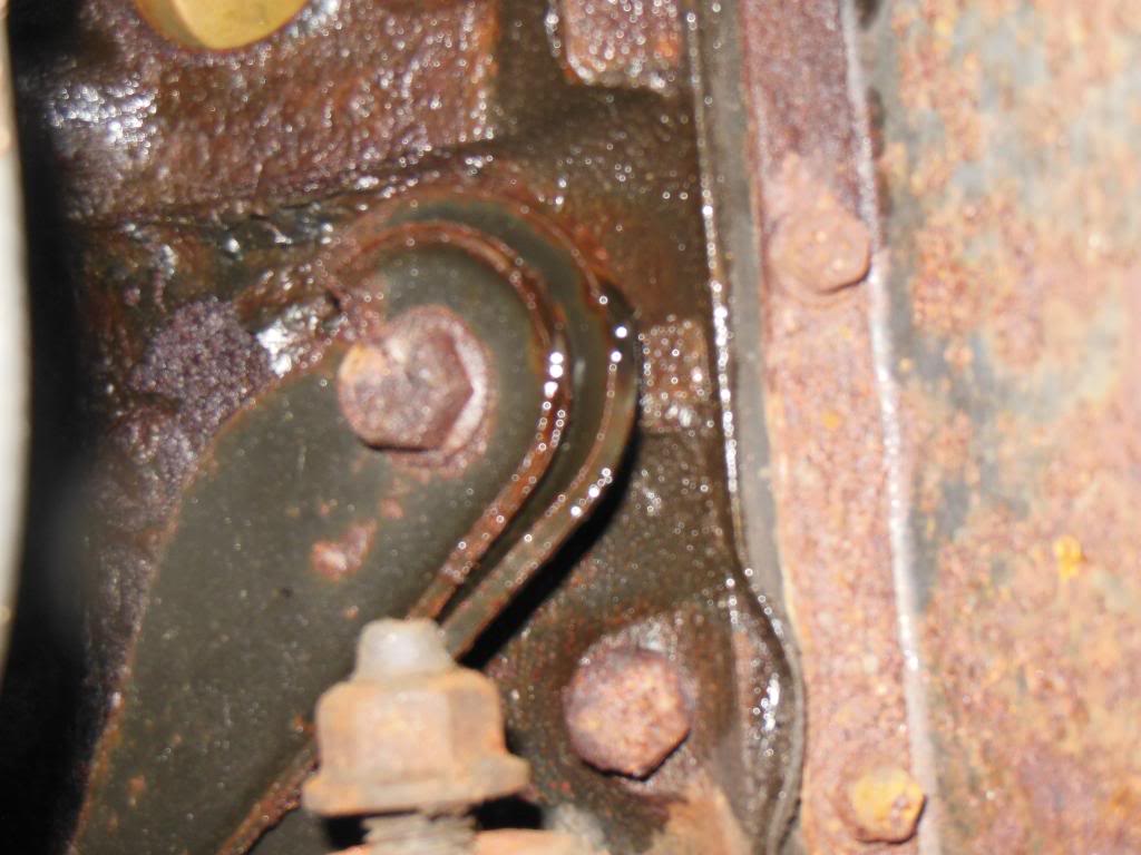

So I drained the oil to see how it looked. When I got under the car, the first thing that I noticed was that there was oil all over everything...

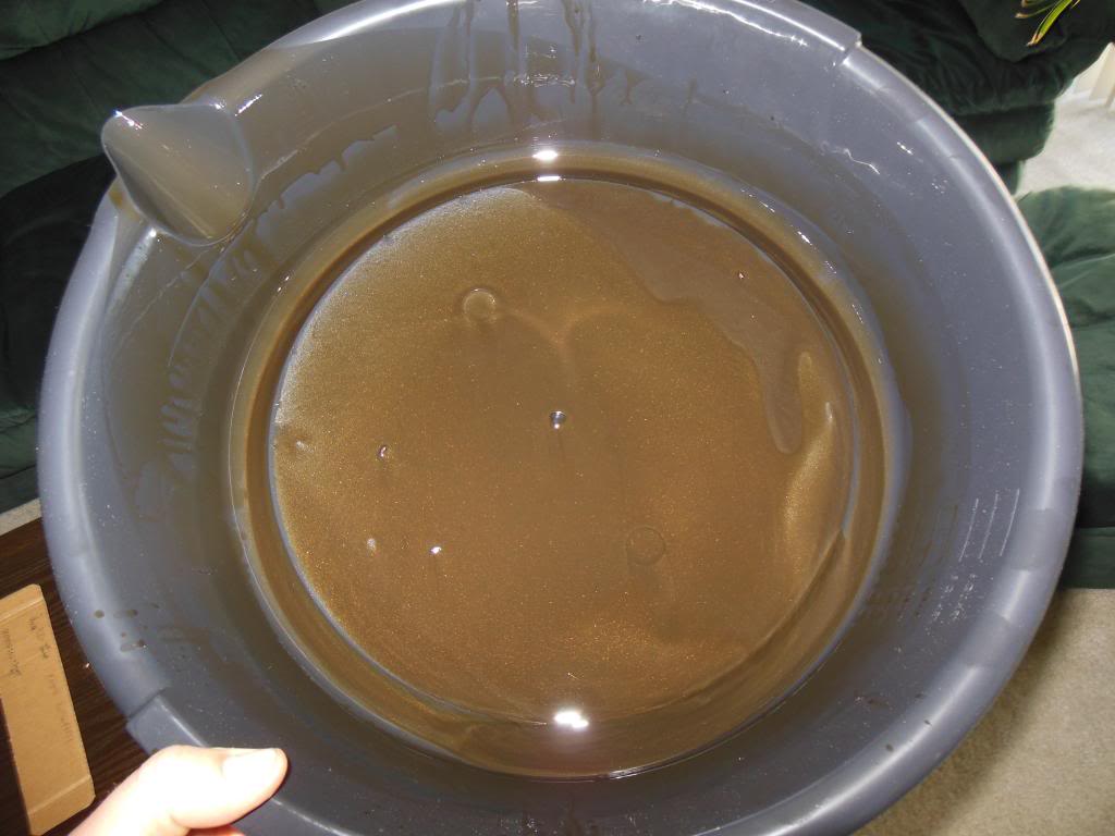

Drained the oil:

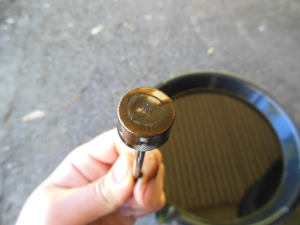

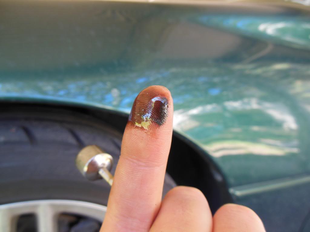

Ran a magnet through it, and here's some of what I found:
Here's what was left in the drain pan: lots o' metal
So...looks like the engine's going to have to get pulled. That means there's a lot in store for this car over the next few months:

You can clearly tell that the point of origin for your oil leak was at the level sensor in the pan, and the dripping oil would be blowing back as you drive which is what coated everything behind it. How many miles since the last oil change?

Probably about 1000 miles, if that. I got the oil changed once I got it back together late last fall, then it's probably only been driver about 2 months total other than being in storage since then.
There was a lot of oil much farther up on the block (toward the rear) than what could've come from that sensor.
