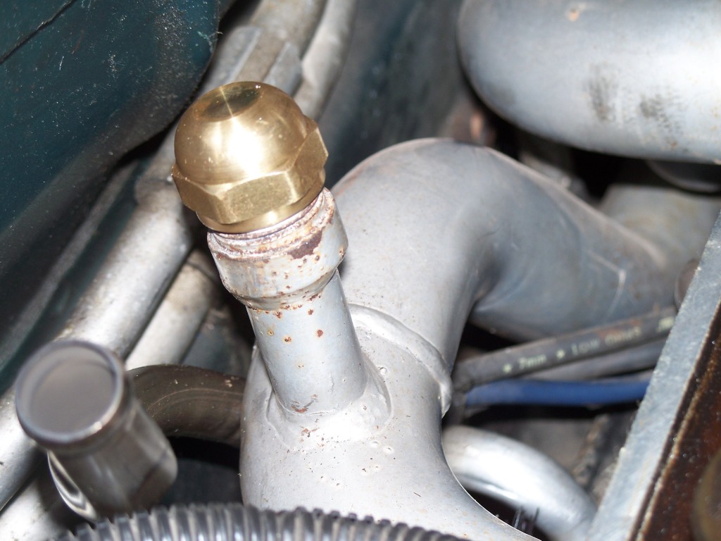

So as you may recall I said before, I used brass caps to cap off the AIR fittings on my headers, like so:
Almost immediately after I started the car back up, the thread tape melted and the exhaust was leaking like crazy. So I learned that thread tape isn't good for heat lol. So what could I use to seal these without the sealant melting with the exhaust heat?
Old Oct 15, 2012 | 12:30 PM
  #499
Posts: 22,042
high temp thread sealant
