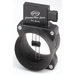

The complication today, however, has come in the form of my MAF. It was throwing a code before I took everything apart, so I used MAF cleaner on it, but it's still throwing a code after everything was put back together. I was shopping for a replacement, but I figured out that my MAF isn't stock. It looks more like this:
It has a plastic housing, no screen, and no airfoil. I think a stock LT1 MAF looks like this:

Did some more research about the MAF thing today...saw something about a 20 amp Engine Sensor fuse that could cause it. Got home today, popped the hood, had a look, sure as heck. Blown fuse. Gotta love easy fixes
