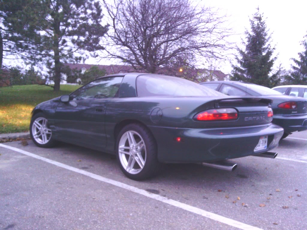

And let there be life
After work today I took it to get an oil change, then drove it to my friend's house and back (about 20 mins one way, mix of highway and city driving). Other than the exhaust leak from the EGR block-off plate on the header, no issues to report
