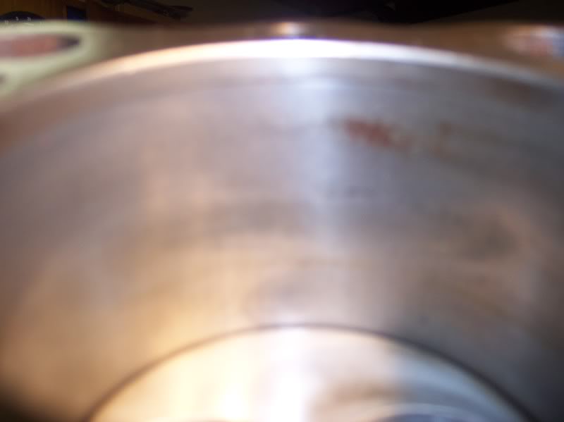

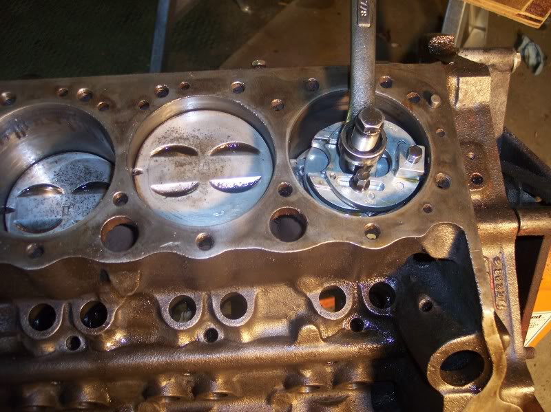

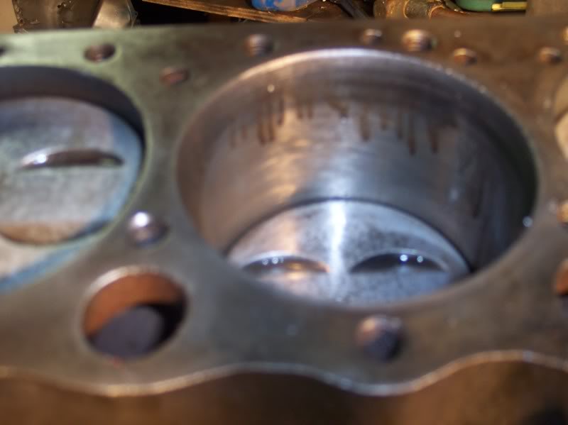

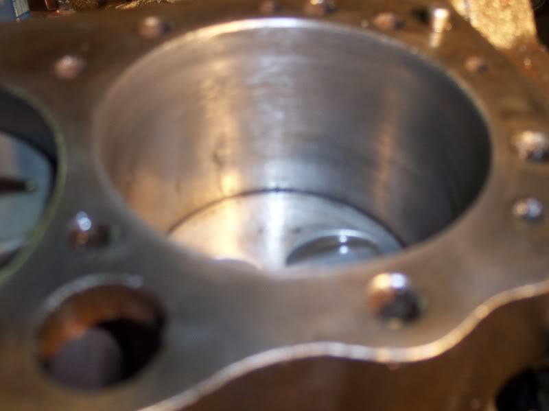

The cylinders did have a ridge in them at the top, I had to go to Autozone and rent a reamer, after a break and another go at it, I got the hang of it and it went really quick for the rest of them. A thousand questions from my 4 year old probably didn't help the first go around... lol.

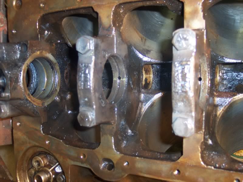

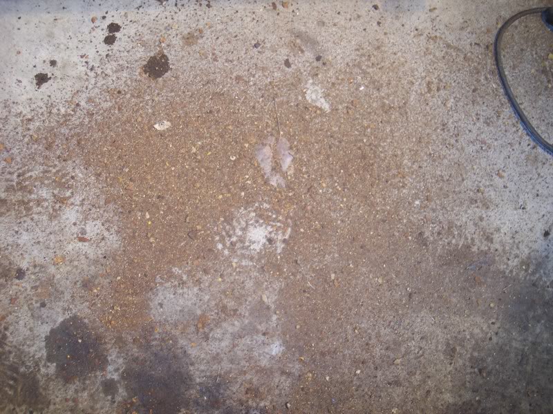

I took and chucked and open quick connect in the end of my air hose and let it rip through all of my water jackets and stuff, and got ALOT of rust and junk out of there. I wasn't planning on pulling the freeze plugs, but with all the crud that came out of there, I think I should, it would allow me to blast it from different angles in the water jackets I think. Unless I can get it all out otherwise.

Even the rings looked good to me, given the quick glance I gave them, I need to spend some time really cleaning everything up though. With the ridge on the top of the bore, I don't know how they could have gotten the old pistons out, unless it is possible to take them out the bottom??? Not sure about that, then again, they could have beat them out for all I know and used the tool to put them back in. Or they are original, what do I know? lol.

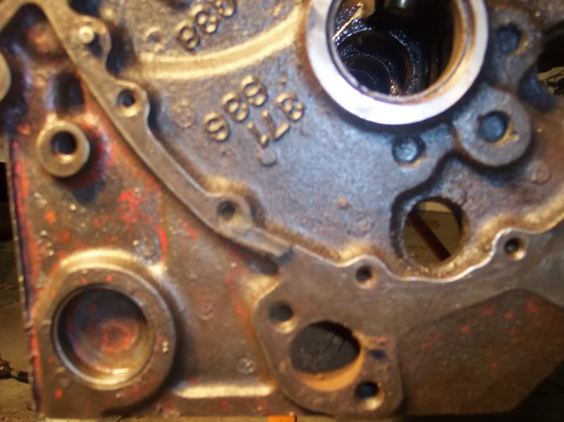

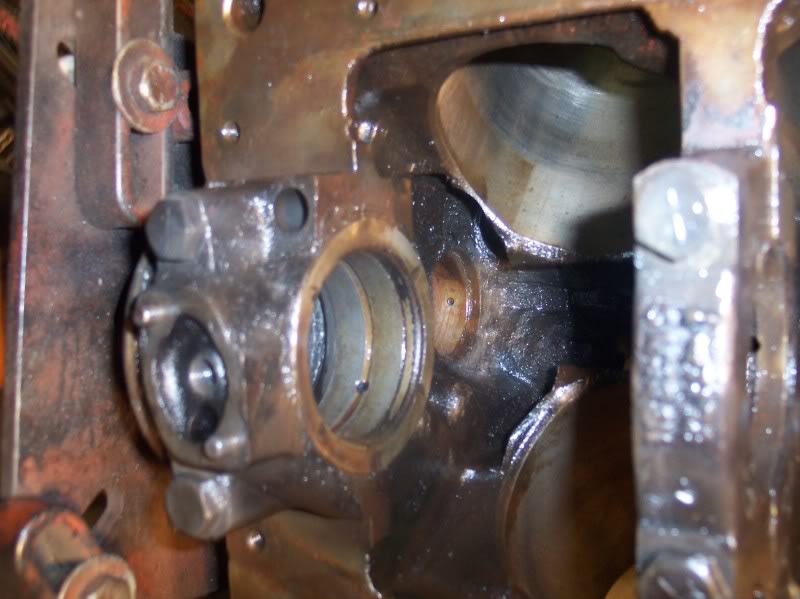

The cam bearings are definitely not new though I don't think. I haven't gone after them to clean them up, but when I removed the cam, it looked like a small-ish one, and it definitely wasn't new, so they probably just left that bit of the engine alone.

I'm going to probably take a break for the rest of the night, hopefully tomorrow sometime I can get out there and decifer what size bearings are in everything. I need to do some reading on how to tell if the rods are still true, how to mic the crank and check the radius or whatever. I'll need to check the bore size, I assume that it is stock, but who knows. I'd like to try to determine if it needs an overbore too. Got some learning to do. I don't really want to go ***** out drag race here, but I'd like to take this oportunity to get a good grasp of building an engine the right way.

Hmm. A lot to take in here. No way should there be thread sealant on the main bolts. Thats a no no. I was thinking about what your FIL was saying about making the side of rods. I have seen this near the bolt. Forgot!
Anyhow, I think your lookin at a stock motor. I can't explain the sealant though. Maybe someone had the crank turned. You can pull the crank and reinstall without ever touching the pistons.
You rings will almost always look new. Rings don't really wear down they relax and lose tension, there ability to push toward the walls. The piston skirts will tell a bigger story. Look at the thrust side. This will be the sides 90* from the pins. The side that pushes toward the outside during ignition is the worst.
Around here the machine shop will hot tank your block and rplace cam bearings for about 50 bucks.
I can't say for certain, but my experience tells me those stamps are to identify the the different cavity #s. I would imagine there were many, many cavities for pistons. Needing 8 per vehicle is a lot when you think about it. We're launching a seat pivot at work. Four per car. 2.5 million pieces per year. We only have (2) three cavity dies. Thats for one specific car. Now back in the 60s and 70s when there were anything from Novas to motor homes came with a 327, it blows my mind really how many had to be produced at one time.

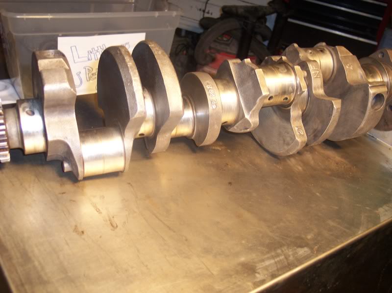

Just went out and hit my crank with the die grinder, cleaned all of the gunk off of it, it looks almost brand new now. That aught to help I'm sure.
I don't have a shop around me that hot tanks the engine. I wish that there were. The one in town pressure washes engines... I'll do that. As for the cam bearings though, not sure how I feel about that being a DIY option. I've read about it, but it sure looks like it has to be right. I'll dig up my book and re-read it.

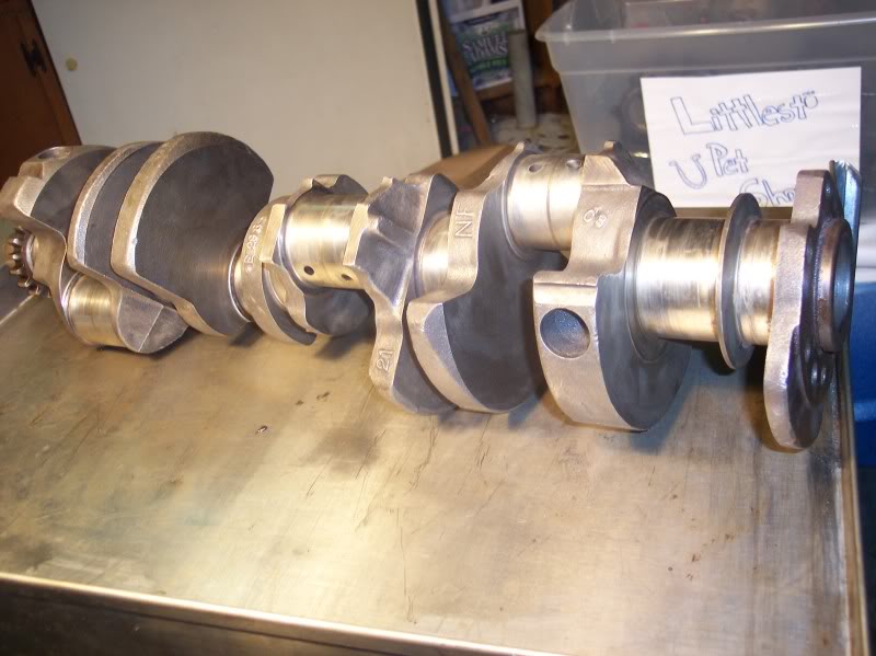

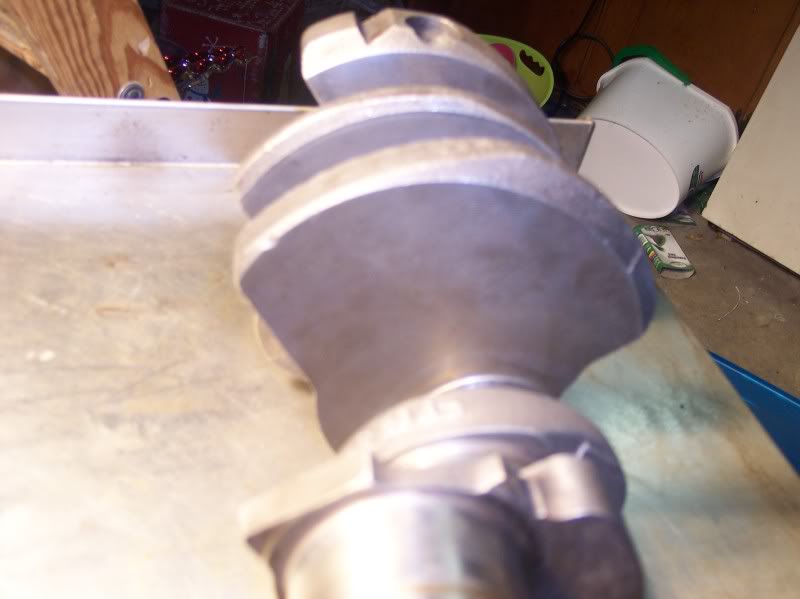

Here are some pics of the crank cleaned up. I may go a step beyond this, but I'm not really sure yet. Where do you stop?

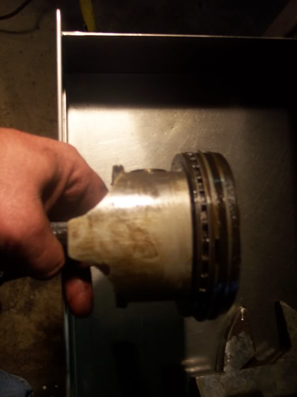

And my next project is going to be these I think. Is it possible to remove the rings and reuse them if they are any good? Or is it just not worth it?
Tomorrow is our Easter with the kids and everything, and next weekend is with our family, so I'll have to try to come up with some way to hit these things during the week.
What is the best way to clean pistons and rods, I'm thinking that I would like to not have to pull them apart. Soak them in something maybe and a wire brush? Probably brass on the pistons?

I never take them out the top unless it was a re-ring with no bearings, and I've never been in that scenario. I always pull the crank and take them out thye bottom. Mainly because I want the engine completely apart, hot tanked, and magnafluxed before I start anything else. That way I don't spend any time or money on anything until I know the bore size, what the crank condition is, and what it might need to be turned to. Or if anything is cracked in the block too!
My Camaro had a cracked block when I rebuilt the engine back in 1999, and had I spent any time on labor or materials it would have gone for nothing once I found the block was bad.
Don't reuse the rings for sure! They're not worth reusing and wont cost much to replace. Also when cleaning the pistons I just clean them in a solvent tank, then use a piece of one of the old rings to clean inside the grooves.
Have you pulled the bearings yet to see what size they are on the backside? There's a few spots on the crank throws that look questionable to me; might just be the light or dirt, but odd looking.

The valve seats might be a problem. I'm not old enough to have ever pumped leaded fuel so I can't say they'll live long without it. The journals look kind of dull, did you wire wheel them too?
Yes I've pulled them, but I don't know what the numbers mean, I'll get to that soon here. I like the idea of just soaking them and cutting a bit of the ring off and using it to clean the grooves, I'll go that route. Would you recommend going to the trouble of pulling the pistons off of the rods?
As for the crank throws, when I pulled it apart, everything looked like all the pictures of perfect that I've ever seen. I really feel good about everything there, but I need to read about checking things with a mic, etc. It very possibly could be bone stock, and it is likely that it is.

I didn't go after the crank throws with the wire wheel, I may have bumped them occasionally though I am sure. I know that they are supposed to have a nice pattern to them. But I did clean the crank up with paint thinner once I was done wheeling on it. I think that dulled it up for sure.

Steve, crank throws sould not have any "pattern" on them. Every crank I ever had turned and polished came back with a mirror finish on the throws and mains. As for the valve seats, I asked the machine shop when I had my last set done if I should go to hardened seats and they told me I'd probably go 30-40,000 miles with stock seats, where hardened will do twice that with ease. For my situation of about 2,000 a year I figured I'd be dead before they need new seats.
