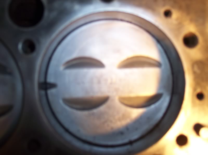

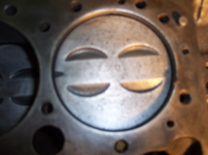

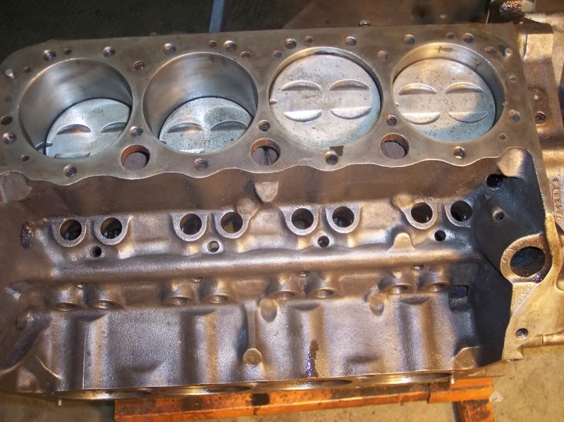

Been picking away at this engine and heads for a couple of weeks on and off. I'm tempted to build it and go with it for now, and pick away at something alot better later on. I've essentially got an entire engine in parts laying around. All of it old school technology, but all of it good old school technology. I've also got a few questions as I go here too. On the cylinders: they each have a number stamped into them, mostly 11's, one 10, and a 9. What does that represent? I'm not sure yet if this motor is stock yet, over bored, original bearings...

I've got some numbers also on all of my cylinders here, Anyone know what they represent? Here are pics of them.

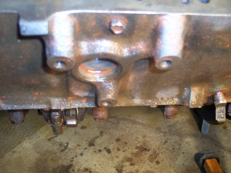

Got some random pics of the engine as well.

Going to get my 4 year old changed and take him out to "help" with the disassembly process now that everything is numbered. I do have a bit of a ridge though at the top of the cylinder bores, so I may just hit that with a hone and see if it will come off.

Hone wasn't working, went to autozone and got a reamer. What a finicky POS those things are. After about an hour getting it "centered" in the bore, I finally got one "done". Seems to do a pretty rough job of things, hopefully I can hone it out.
Anyhow, that was about the extent of my little guys patience for garage time. Once my wife gets home I'm going back out to try to finish it up. I hope I don't need to get this thing punched out. If so, I'm just going to bail on it and get the 350 block. My FIL wants this one anyhow eventually. He's got 13:1 pistons and rods for a 327 that he is dying to use.

Looks pretty good from what I see. I can't tell for sure, but doesn't really look like you've got much if any ridge at the top of the cylinders. Are the numbers on the "cylinders" the ones on top of each piston? If so, I've seen them before, but they've always been random, and I've never figured out any meaning for them.
Is there a reason you'd want to specifically use a BBC oil pump, or do you just have one that's cheap? Nothing wrong with a SBC oil pump, as they can easily put out equal volumes of oil and oil pressure.
I just found a bbc oil pump with a brand new pickup for cheap. It is a M77. I know I've read that even the stock sbc pump is sufficient for most builds, even performance ones. But that the BBC pump would be equal to a HO oil pump. Really though, the price was right.
As for the "cylinders", when I was typing it, it just didn't feel right, pistons is what I meant. Showing the newb in me. lol. I did have a ridge, but it wasn't much, at least I don't think so, I could catch it with my thumbnail, probably a 32nd of an inch or more... I didn't quite get one of them all the way, and when I was pushing a rod and piston out it hit the tiny bit left and would not come out, while all the other ones literally pushed out by hand. So I would have needed to do it.

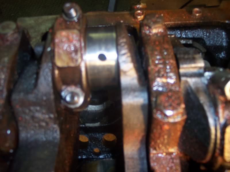

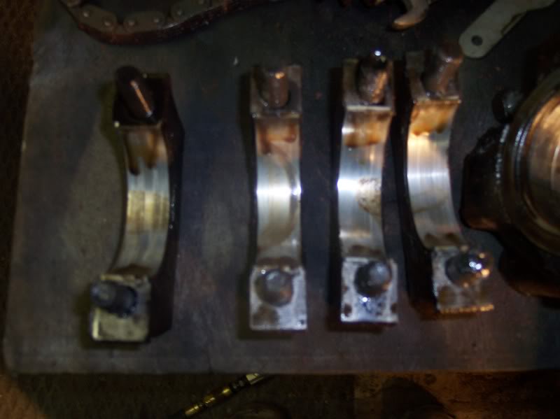

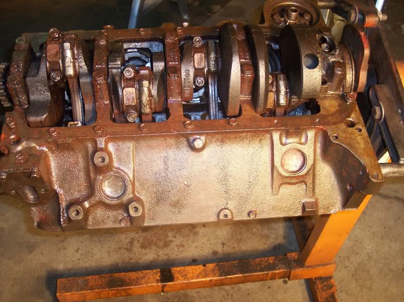

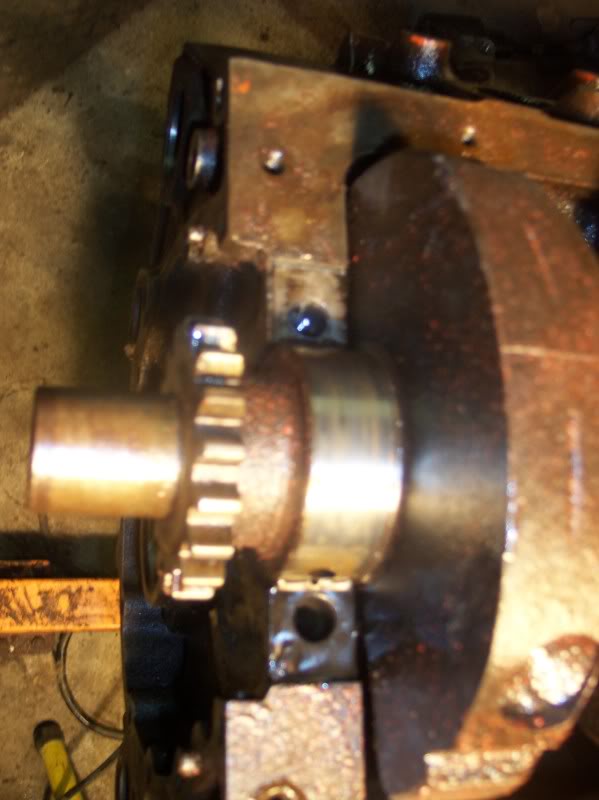

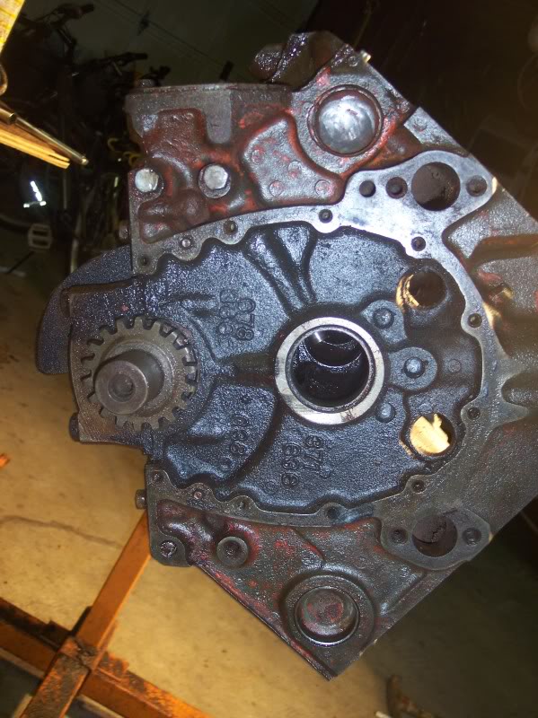

Pulled the engine apart, I really have a strong suspicion that this was a recent somewhat rebuild. The rod bearings looked new, the main bearings looked new, and the thread sealant on the main cap bolts looked like it was new... Nothing alarming color-wise on any of the bearings, nor on the crank either where the rods connect or on the main contact points.
