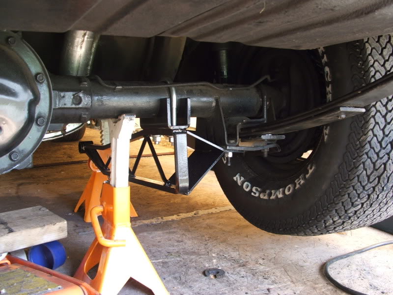

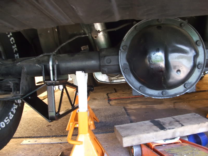

Got the new bushing pressed into the spring eyes. Fronts were pretty snug, but backs pushed in by hand:
Got the springs mounted and the pockets reinstalled, and the ladder bars installed on the axle and spring plate. Still need to get the rear shackles installed, but waiting for paint to dry:
Also have to get the front brackets installed on the ladder bars, which requires drilling two holes under the rear seat area for additional support. These things have more bolts than any traction system I've ever seen. Not sure if it's all needed, but I guess it is.

It got too warm by 2:30, so I quit. I'd like to finish tomorrow as the Columbia Camaro club has a cruise/poker run Sat., and if it's done I may take it to give it a test run with all the new suspension.
One drawback I may have to modify. The swaybar can't be used with these, but they say this system takes the place of a swaybar, and the way it mounts I can see that. But if you don't want to remove your swaybar, then the Lakewoods aren't the way to go.
