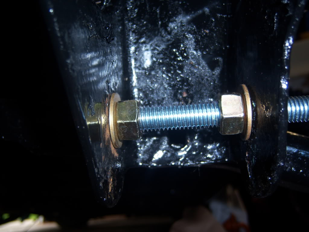

I've read horror stories about the sleeves. My car came with the control arms empty, it took about 30 seconds to sell them on Nasty. The Delrin in my new ones should outlast gasoline. Oh yeah, one of the first pages in my project thread has a pic of the deal I made to spread the control arm pockets out. It seems that when the factory tightened the bolts they pinched the tabs. So when you put the new, uncompressed bushing in. It won't fit. The tabs need to be spread. I used a piece of 1/2" all thread with two nuts and washers. Slip the rod through one hole, add the nut then washer. Then spin it up until you can get the other nut and washer on from the inside. Then use the nuts to spread the tabs apart. Worked great.

No, no no. The lowers. The two tabs one each side the the lower arm mounts to. The pivot if you will. When the factory installed the arm and tightened the bolt it pinched, compressing the rubber bushing. No big deal really until someone pulls it apart and cant figure out wht the new one won't slide in.
went back and found the pic for you. LOL before I knew how to resize pics.

That lower doesn't look like mine. Mine isn't here in front of me now, as I pulled them today and dropped them off at a friend's shop to have him press in the new poly bushings. But my lower is the same shape, but with a rolled lip where the bushing goes into the arm. Shouldn't matter if the doubled edge was off in width, as the bushing will space it where it goes into the subframe. If the total outside width was off, then it would be an issue.

I couldn't force my bushing in, that was the reason for the spreader.
