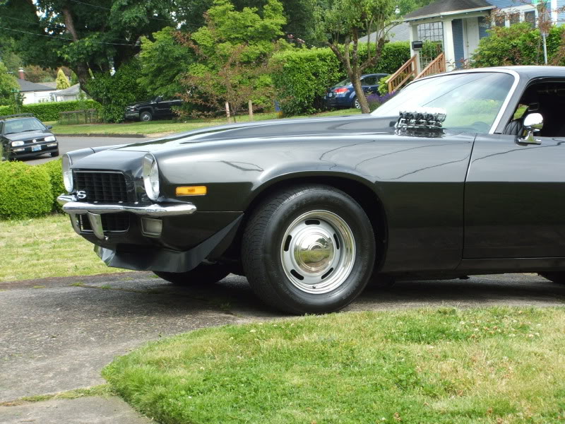

OK, so I finally got the Camaro out for a test drive after cinching down the upper swaybar mounts. Did a once over on every bolt, then checked tire pressure and shock pressure.
Tooled around the neighborhood, and then went for a drive on the freeway. It handles like a new car! It's firm, but not as firm as it was before. I found one little thing that I'l have to watch when coming in my sloped driveway today. The spoiler will scrape if I hit the driveway too quickly, so I have to be more careful coming in.
Wondered about the front bracket for the traction bars scraping, but it clears easily, and I'm glad I used the upper holes and cut the excess off.
As you can see there's plenty of clearance, even with the curve of the driveway slope:
From looking at older pictures before the new coils, I think the frontend sits the same height (or close) but a little more travel. The choice of smallblock coils for an AC car was a good decision, as I like the feel and ride height with my big block car.
