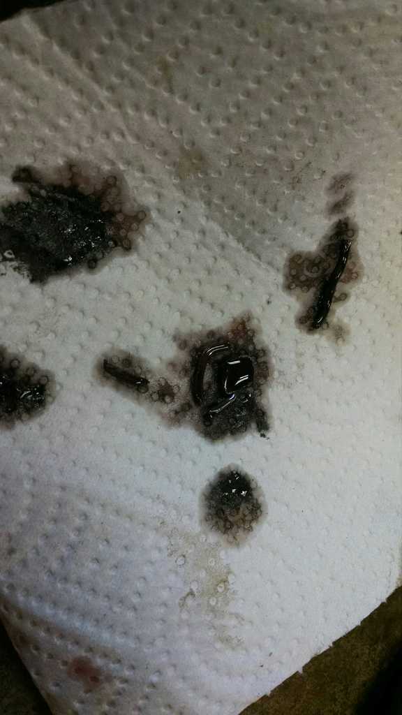

So I've been trying to track down a drive line vibration and I think I found it. I'm pretty sure the output shaft isn't supposed to move quite this much...

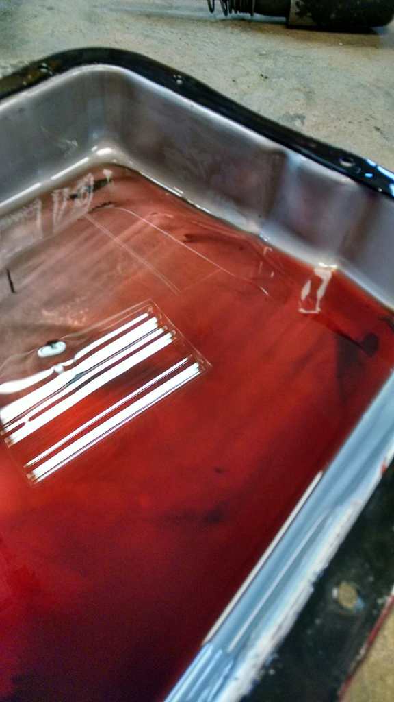

And since I was under there, decided to do the trans fluid. Not as bad as last time I did it so I do believe the cooler has helped buy some time but I didn't like finding this. Guess it's time for a new trans.

That really not to bad, case bushing has some age, how many miles? what is on the paper towel??

As far as what's on the paper towel, your guess is as good as mine, but it was laying in the bottom of the pan (you can see some of it in the pic I took). Looks like I'll be buying the built 700r4 my uncle has in his garage.
