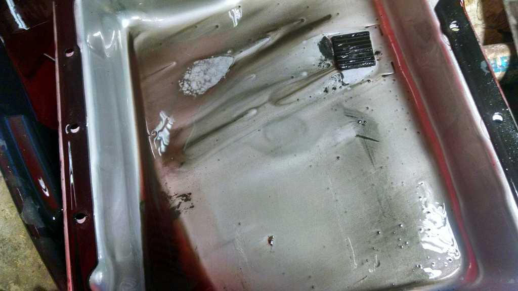

Well I got the stumbling issue fixed. Was another exhaust leak problem. But shortly after the transmission started acting up. You'd jump on it, it go for a split second, then rev like it was in neutral and usually make a banging sound like a hammer on steel. Thought maybe rear bit the dust so I pulled the cover and it was clean as can be. Transmission was next thought, so I pulled the pan...
Kinda bummed cause I just changed the fluid and filter less than two months ago. But I already got the trans pulled out. Much easier the second time around...didn't even touch the exhaust.
