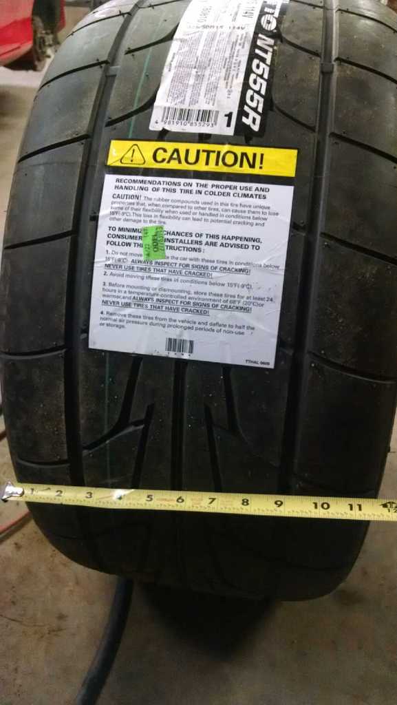

So I got the new rear wheels and tires yesterday and got them mounted and balanced. They are a wee bit bigger than I expected and stick out a wee bit more than I wanted, but I won't complain. I did run into one little problem though. As soon as I spin the wheel the parking brake cable is gonna rip the wheel weights off...

what BS are the wheels? You really shouldn't have that issue
Old Jun 9, 2016 | 07:19 AM
  #285
MKCoconuts's Avatar
Joined: Oct 2011
Posts: 2,553
From: PA
6.5inches. I did a lot of research and everything pointed to needing 7inches for a 15x10 but there were none in my price range so I went with the highest I could find. Everything else clears except where the cable connects. I'm not sure I can get the weights to stick again if I move them.

I think you really needed 7.5, thats pretty much the standard fbody BS for a 15x10

Yeah you need a 7.5 BS for a 10" wheel on the back. Race star makes a cheap wheel that fit perfect on my car.

hell, I have a summit brand 15x10 wheel for when I go 26" tire racing and I think they were 90 bucks a piece? 7.5" BS

I couldn't find any Summit brands that were more than 6.5in. And just about everything else was way out of my price range or strictly race use. I got it fixed though. Took it back, told them what was up, so he moved them in a bit and rebalanced. Got the passenger side dead perfect but had to take the drivers back over to have it done again. Was smart this time and took a paint marker and made a mark on how far in it needed to be. Had me in and out in less than a minute.
