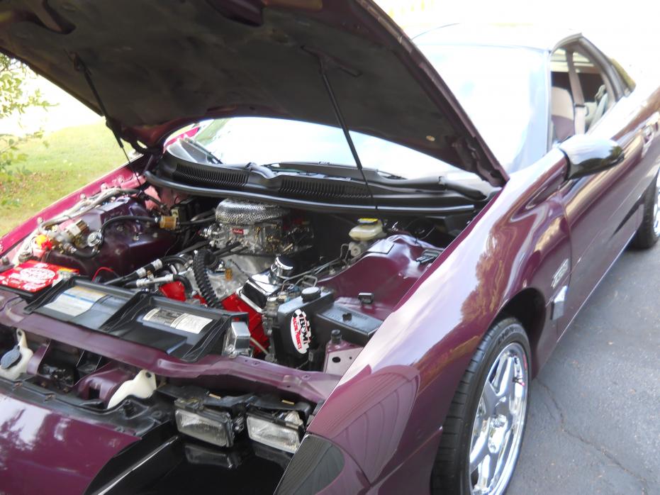

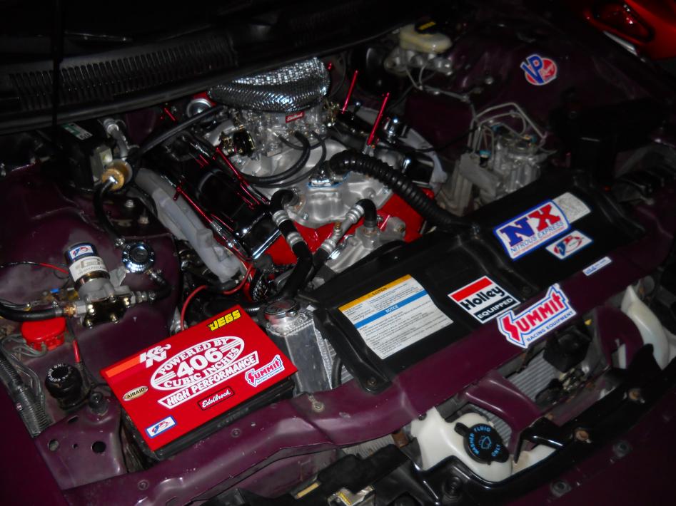

Attached Thumbnails Engine swap 1995 z28 350 to 406-dscn7107.jpg   Engine swap 1995 z28 350 to 406-dscn7120.jpg
