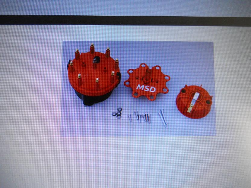

looks like it may fit google is not clear then 8445 cap ,ok I got that pictures printed up thanks though now it?wich pump I know low psi cap or the hole ,I got to say I was disappointed to not have my car this weekend ,but working to have it soon I guess ,cant have cake an eat it to ,it will look good when its done so afuel pump from a 1979 to 86 ???,so it sounds like we are pulling the old pump caping it off ,then using a sending unit,keith had said he did truck 93 with 50 psi an still runing with it few years later with just regulater ,but I don't want to have this work then break on side of road 80 miles away from home so if its going to be as simple as it seems compared to things so far ,>?explain or show me the thread ,so is it unhooking in then hooking up the sending unit ,there taking the vacation 3 days so I am not an anything info I can have to move thing alongs will be great thanks guys well it looks like msd is the way to go on this they have tech line,looks like will modify it to ,the heck with getting an external coil

The distributor cap you show adapts to the conventional size MSD distributor to give it a big cap, which helps prevent cross-firing at the terminals. It won't work on an HEI.
For clearance purposes, you want to use a distributor that's more along these lines, but this one is mechanical advance only, no vacuum: Chevy Flat Top Pro-Billet Distributor - 84891

thanks yes I know I called msd we cut a small hole I am going to be putting shock tower at some point .did not affect my wipers ,an ,I found I could have ran an external coil but deside not to we modified so many things does not matter any more now what matters is how it runs ,an I feel good about that it was realy about making the angel fit so its very small just to allow to turn the angel to fit there over an inch clearance ,got mesh like air cleaner ,looks pretty m,uch like that other Camaro but mine altogether sit about inch or more forward.you don't relize how big those engines are until you got them in there .

When you are looking at clearance don't forget motor mount have give to them and a high torque motor can move a lot. I have seen a few caps knocked off of distributers due to a lack of clearance. You could try a jack on the motor to see how much it has but with 400 Ft/lbs of torque the jack can not duplicate the body twist or the compression of the "other" mount.

well I was looking at it yesterday they made sure they were careful the way they cut the hole there is now 2 inches clearance ,we had about one inch anyhow it was just getting it over the top ,that angle that cap has when you set it on there ,was what was stoping us at first now its got plenty or room ,thanks will keep an eye on alot of thing during first week ,will post pics soon ,thanks gorn we had to switch pressure regulator ,it was pushing to much psi ,the first one sucked . got one now only goes up to 1 to 6 psi to 10,had to modify the tranny filler hole to ,an pump it in ,if today goes well I will be taking the breakin ride ,they have to break it in 20 minutes 2000 rmps up an down a bit ,then adjust everything ,well we desided it was the engine swap from hell ,but looking back got alot done pretty fast Tuesday was one month ,I am sure guys took a lot longer ,an the mech says he wont do it again ,well so much for a simple engine swap ,so he had said to begin with ,live an learn but live,oh I am going to get on it a little during first 20 miles I hear the most important time to properly seat the valves an a lot of guys do that ,not pound on it but not babey it ,then drive it easy the rest of the year ,couse I got to get the rear until next year until we do that rebuild craby had told me about
