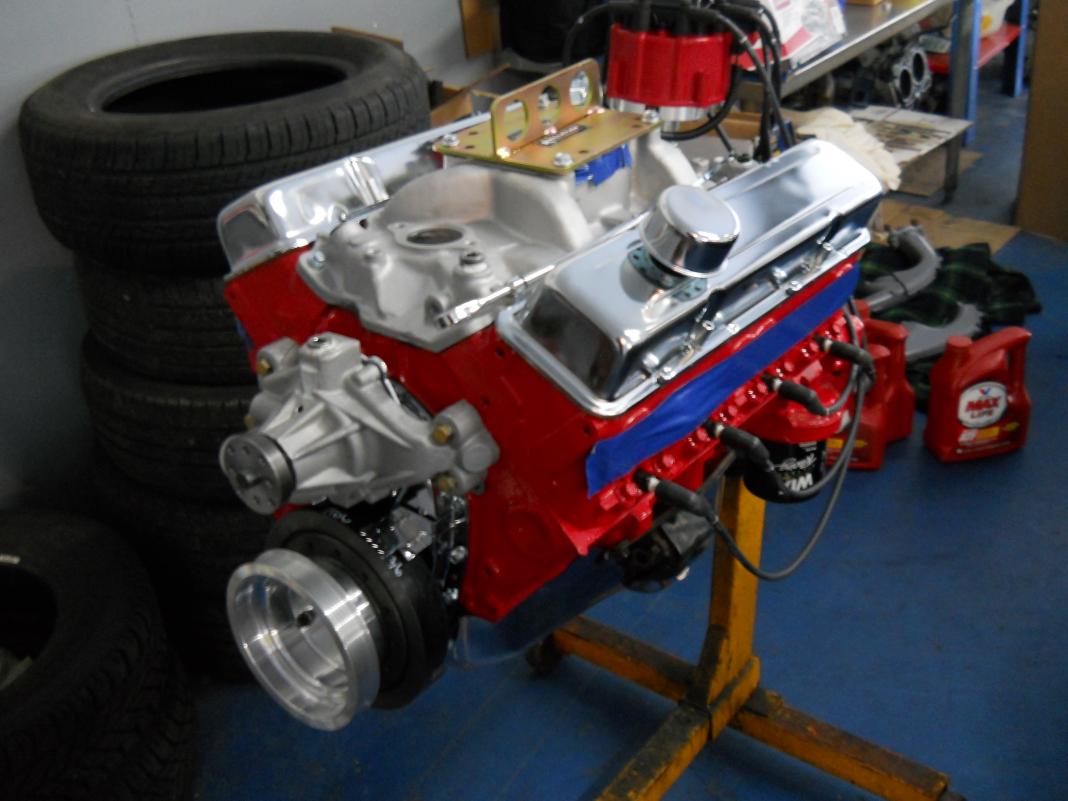

got tranny today ordered denso mini alt 70amp the bracket an power steering bracket an fuse protector ,the old bracket was not going to work ,got the engine mounts on serpentine pulleys the flex plate on ,monday one more mach up to make sure they only need to do in once ,could be runing he said Monday but I am leaveing it up in the air .buy not rushing them I think I get more respect,an I better job to,though.to take out engine I got to say about 8 hours includeing the radiator an 1.5 hours on the tranny I am hope no more then 30 hours labor they gave me a lot of free time too .,an to concider we started this 5 weeks ago I drove it for another 2 an only about 3 weeks down aprox throuble shooting an geting parts waiting ,I am more then happy with the time its taken ,I knew it was not going to happen overnight man just one week behind ,thats not bad with the help from you guys was that mr freeze thank you were right about the tranny an I learned alot wich may actually make me helpful to someone down the road thanks again ,update Monday more pictures an one of the manifold leak on the lt1,now to research the under dash ac unit I had forgot my brother had one an an old 1978 ford elete was cold to

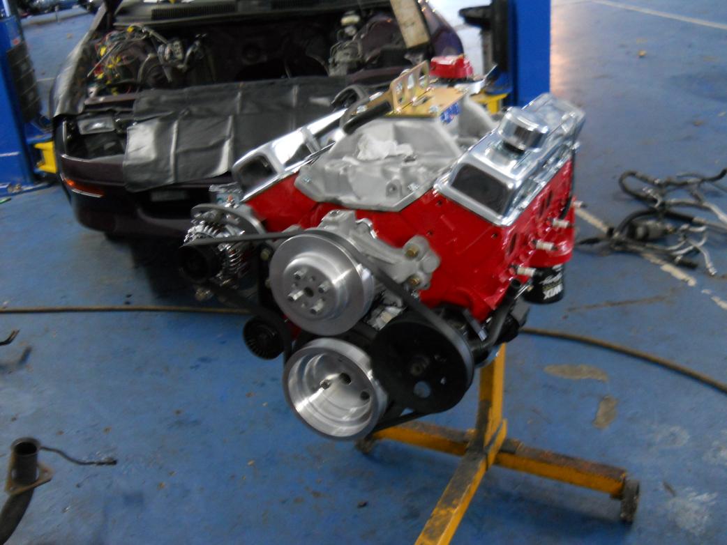

just like the guy in that picture mine is right wear the computer was he choose to run a line an put is on the left side to better reach the carb ,mods the manifolds had to be mounted an modified to fit. the motor mounts also modified to work some good old welding ,his guy is a good welder ,the egine went in an about 30 minutes ,we had the talk though ,there was a lot more then he thought or me to this ,so now guys can read the thread an deside for themselves ,I will add up total in end ,li think we are at the point wear I have seen enough of them an them me ,give it time I guess I would still say no other way ,an could have spent a lot more for a good 383 stroker fuel injected ,probley 7.000.00 alone ,then would had to do tranny anyway ,I wanted more power ,an I am getting it at a price I think still less then staying with an lt1 built to 383 from gm has anyone priced those lately ,I have $9000.00 an then some ,don't know hope we fire it up tomorrow ,pics from today
,will show more soon then when its detailed ,not a spec of rust under the car other then the rear end an that happens to them all ,if the car was not so solid ,I guess I would have had second thoughts ,got to get some steel to beef up the uni body an have some frame next year that an rear end mouser axles stuff they say is good 28 spline ring an pinion ,
