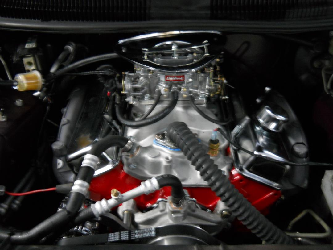

Default this one seem to fit a bit better then the other posted back
now to research .do we replace that with lower psi pump about 10 ,or do they pull old one cap it off then use sending unit,got a pretty good idea what the psi is just wich pump an how it goes thanks guys,i got to say they talk about streetable hp an torq feels like enough for me with the stall ,does not even feel like the same car ,feels great just some getting used to
it seems to fit better I did not take pic with air cleaner on it yet ,will take video of it running when we get there

Don't use those foam type of air cleaners......if you value your car. One good backfire through the carb, and the foam can start on fire. Besides, a dropped base round air cleaner will give you more clearance above.

ok thank you ,I have thought about fires a desent fire extingesher abc would be good thing to aaah,?what about the pump manual style ,now the air cleaner I was thinking about dual a style that's sits low an has 2 cones comeing off it ,will get a 6 inch to work for now ,drop down base will look that up ,the one I want is like $200.00 but a K&N,
14x3 seem to be the commen size one say only one inch needed clearance ,we got that ,just need to check measure from center stud on carb to fire wall to get aprox 7 inches
I have live that. I had the key on too long fried a set of points. Not knowing I tried to start it and it cranked for awhile and bang. Next thing I know I was putting out a fire. Just bubbled the paint a little. Could be a lot worse. I warn everyone I see with one at car show.
