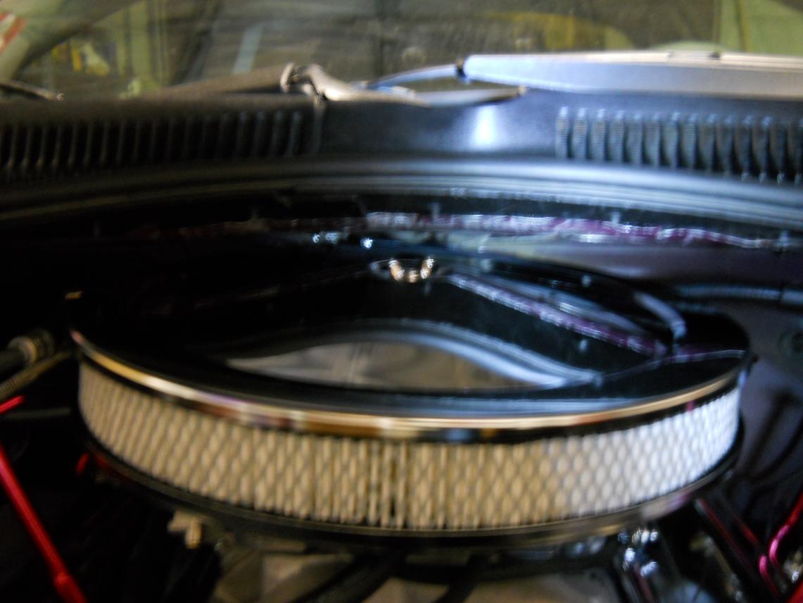

thank you I tried it I don't have much trouble posting hear or the garage but still cant load it, oh well is not that big a deal,soon i will load one up from you tube got the air filter in place now ,an the guy I got the alternator from ,is making me a 200 amp that will charge at idle 700 to 900 rmps an a smaller pulley about an inch smaller i got a 30amp amp for the speakers boom box an cameras for the wrong places ,looks better with the air cleaner an got near an inch atleast not touching,i did want to ?ill the mech a few times now but its against the law JOKE,don't know what he was thinking looking back I still got a lot of stuff to power,soon going to change oil an adjust the valves,most I can do myself ,I found out yesterday that turbo 350 chits an gets ,they sell used cars an the sales guys said I would play hell chirping 3rd well I did it buy accident ,the stall seems so much higher then I was told ,can feel the rear is wineing for help ,,seems working out the ****** ,I got to say though if I had it to do again I would have gone another way,but I think a guy can like I said cut the time in half buy reading thread an asking questions ,should anyone deside they want to do it ,for real i want to the mech has got me so mad at times during this easy build ,ya right guys aahh,know better now,yes next year going to put some shorty headers an run straight pipes I know i said it alot ,but its only a few short months till spring I meen winter .no matter whear I go the car turns heads more then ever an vibrates the tree next to my garage I am impressed with the power of the 406 350 turbo combo ,an that's all that matters skeptics

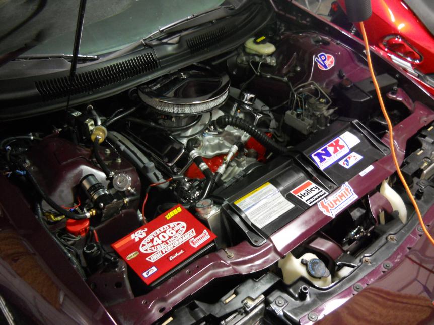

we backed off the timeing today, covered the hole for the tank adjusted the valves,changed the oil ,went with vr1 20/50 ,I desided with more high profomance motor it runs hotter,an heavey oil fits ,,going to move the fuel pump to rear wheel so it pushing more then pulling ,the tranny is shifting a lot better now too the breakin I would say is about half over about 500 miles,i would say 1000 miles should be good though I wont change the oil now till spring ,got a small exhaust leak on right side but that why I am puting headers in the spring ,that's what the knocking was thought to be at cold starts,,so that gives more insentive to get the headers even more ,I got a set of mechanical gauges on the way ,no regrets now ,other then not doing the headers now,but I want to run a whole new system ,is going to run about $1000.00 $800.00 if I shop ,running great ready for longer rides ,the smaller pulley on the alternator is working good but will keep an eye on it ,another thing will work during winter there is not a lot of room there for a bigger one ,so we got to make the mini work ,I think it looks alot better then the lt1 ,I would say go for it guys ,I am feeling much more confident behind the wheel ,I got to say I feel like I have an engine now ,efi is overated ,computers all the junk one friend used to say ,we got along for near 80 years without them ,its round # ,personaly I only use a computer couse it does have its perks ,the app thing is out of hand ,though that being said if you make the right one you can get rich ,what people wont buy to entertain them self ,new cars if no one has noticed are getting recalled more an more an parts are failing like crazy ,its a racket ,though if I had the money I would have ls7 in 70.who won that darn car I entered with like 4 hours left the 70 orange an black I would sell it after driving it for few years wonder what the value of that car was ,mabey one of the 90 guys who never say anything can answer that , ,the person who did win got one hot fine ride
