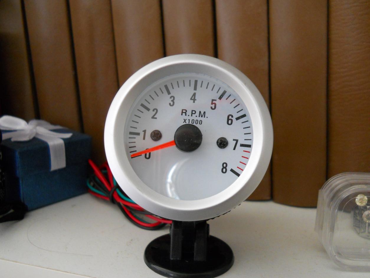

time to do the headers next Monday .I was going with a cluster then I found these liitle pods ,you can put anywhear an take up a lot less room 2 inch ,so like the rpm guage I just bought the pods separate .did not put a lot into cost of quages ,but I did notice trying to cluster them without putting them on the dash is not happening so with these I save a lot of room ,can probley fit 3 of them in the center console under stereo the pivit to move them to

time to do the headers next Monday .gauges I was going with a cluster then I found these liitle pods ,you can put anywhear an take up a lot less room 2 inch ,so like the rpm guage I just bought the pods separate .did not put a lot into cost of quages ,but I did notice trying to cluster them without putting them on the dash is not happening so with these I save a lot of room ,can probley fit 3 of them in the center console under stereo the pivit to move them to
let it breath true duals ,few other things to work out,dont know about you guys but this year more then ever ready to get my car out on the road,i think they will look good this year beside what I am doing cleaning up inside to so will post pics hoping bye end od april ,ready for the show ? how many guys would use black trim with 3m tape to cover up the tears headliner around the tops ,there not more then one inch all the way around ,so cheaper then replaceing the headliner ,about 20,for the trim its about 1.5 inch wide an would cover up ,the rest of my headliner is fine ,actually in the whole car its the only thing worm beides on small hole in drivers seat with cover now
