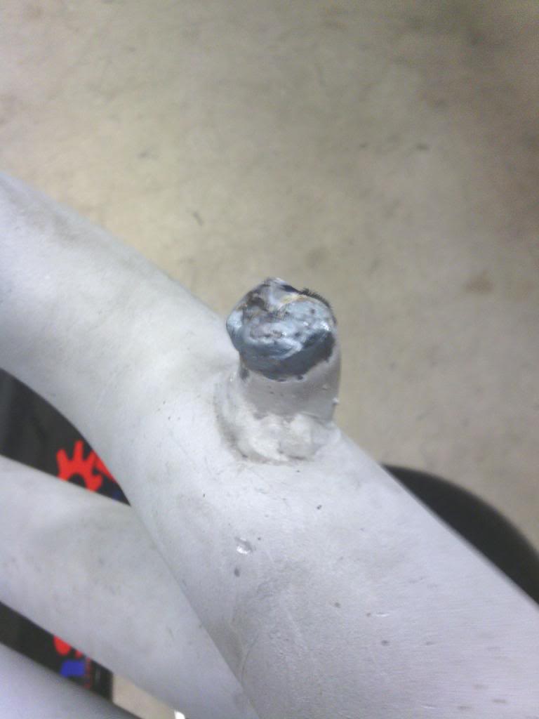

Had a reasonably productive day today. Spent the day getting things buttoned up. Got the interior back together and some other stuff. The biggest headache came when I had to remove the passenger-side header because the cap I had made for the EGR fitting wouldn't fit. So we cut it off and welded it:
Other than that, just a lot of little stuff. BUT, another couple days of good work and this thing should get fired up.

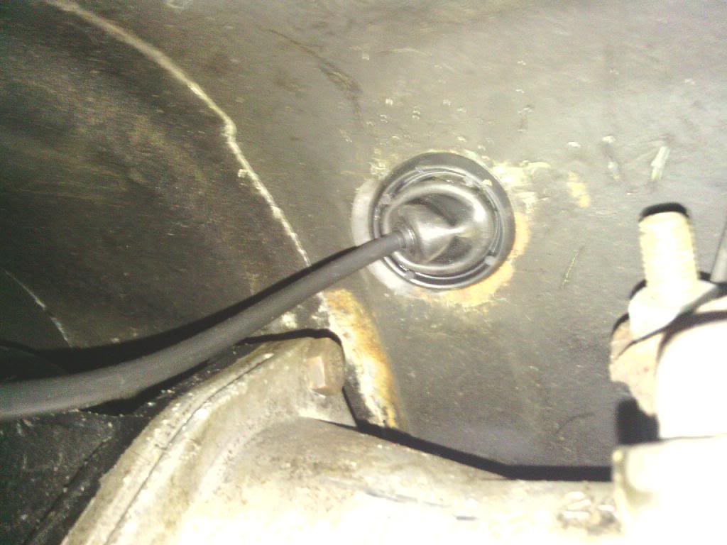

One question, though: I tried getting that grommet seated, but it wasn't really working well. This won't bother at all, will it? (kinda hard to see, it's not properly seated from about 7:00 to 10:00)
