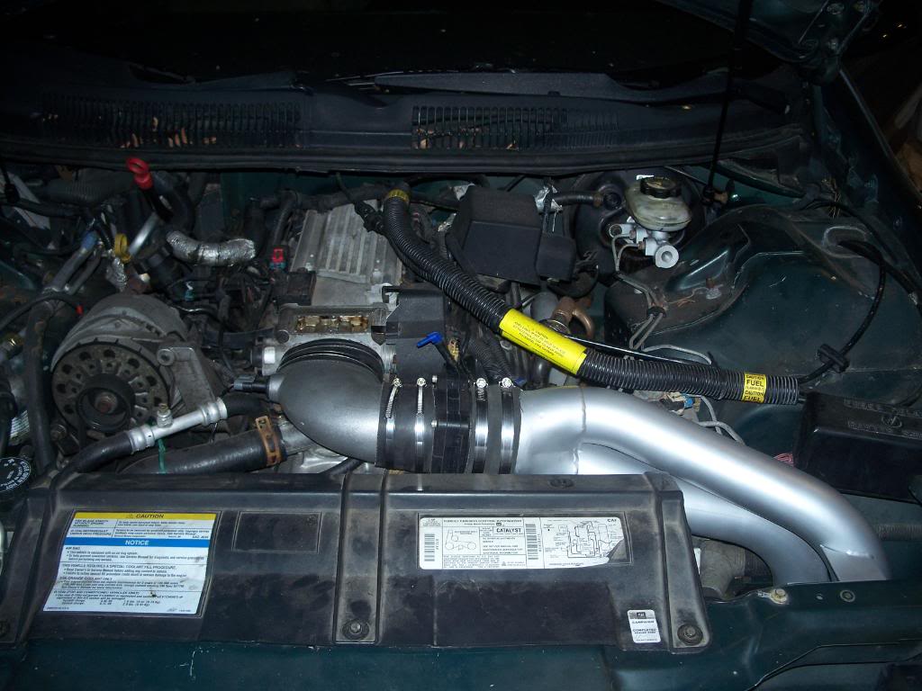

I got everything mocked up under the hood:

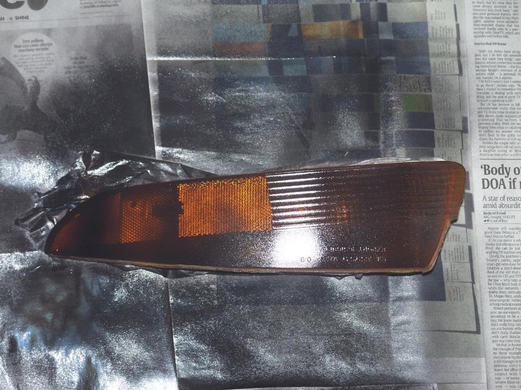

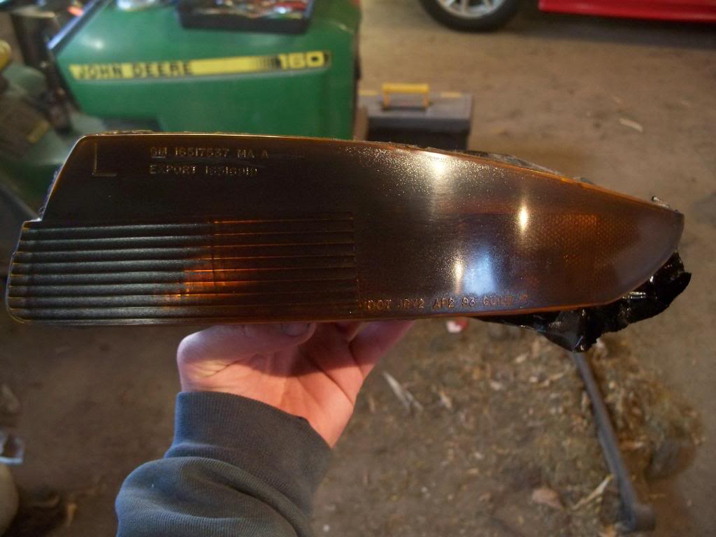

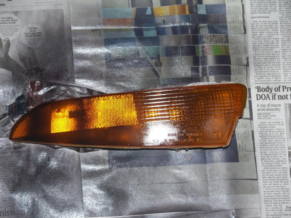

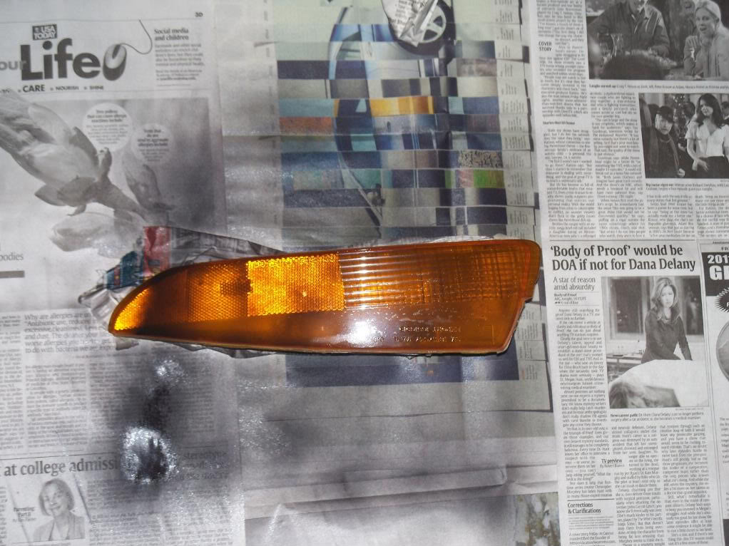

I also got to work tinting my turn signals.
At first:
then successive coats:

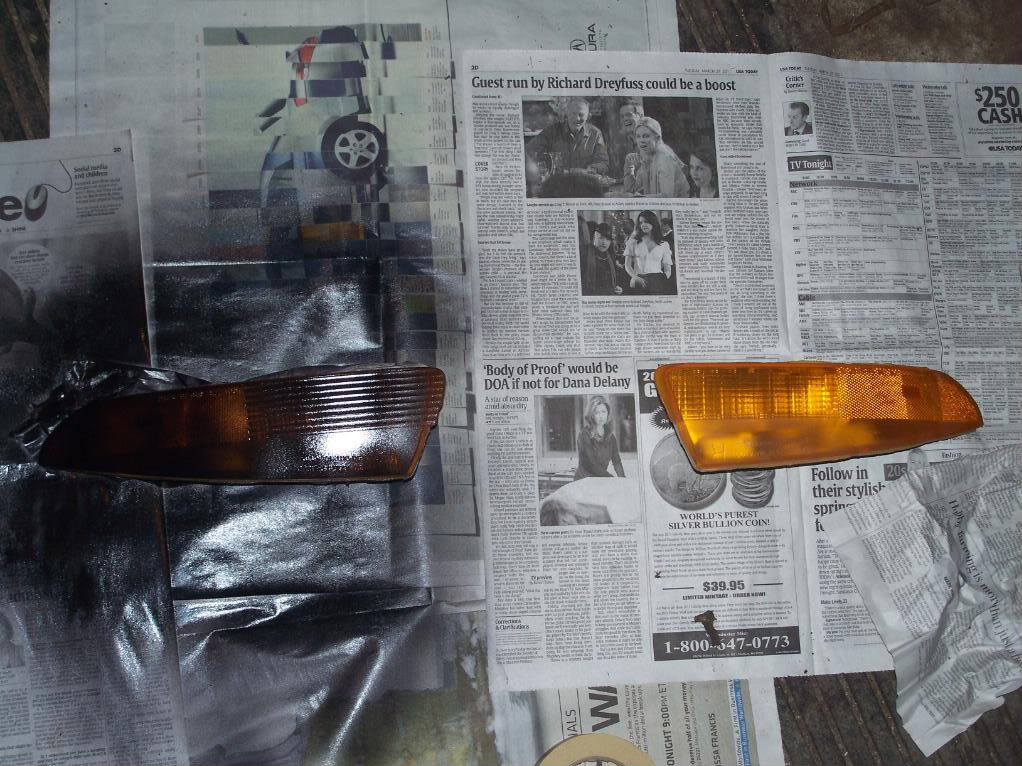

To show the contrast:
I've since applied two coats of clear coat. I'm not entirely pleased of how it looks so far. I feel like it should be smoother...

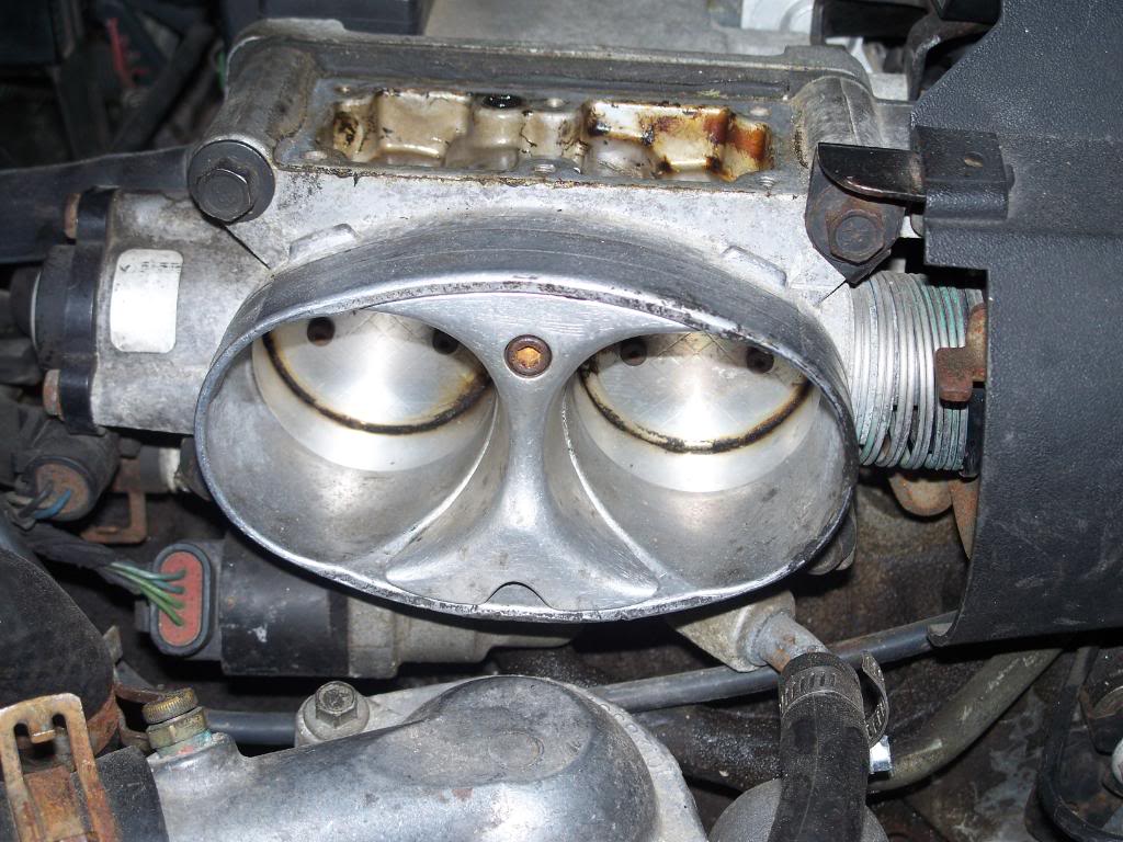

other than all the stupid niteshade stuff, I got a little bit done today. I finally got that nut in the mail, so I could install the throttle body airfoil:
I also installed the new intake elbow and CAI:

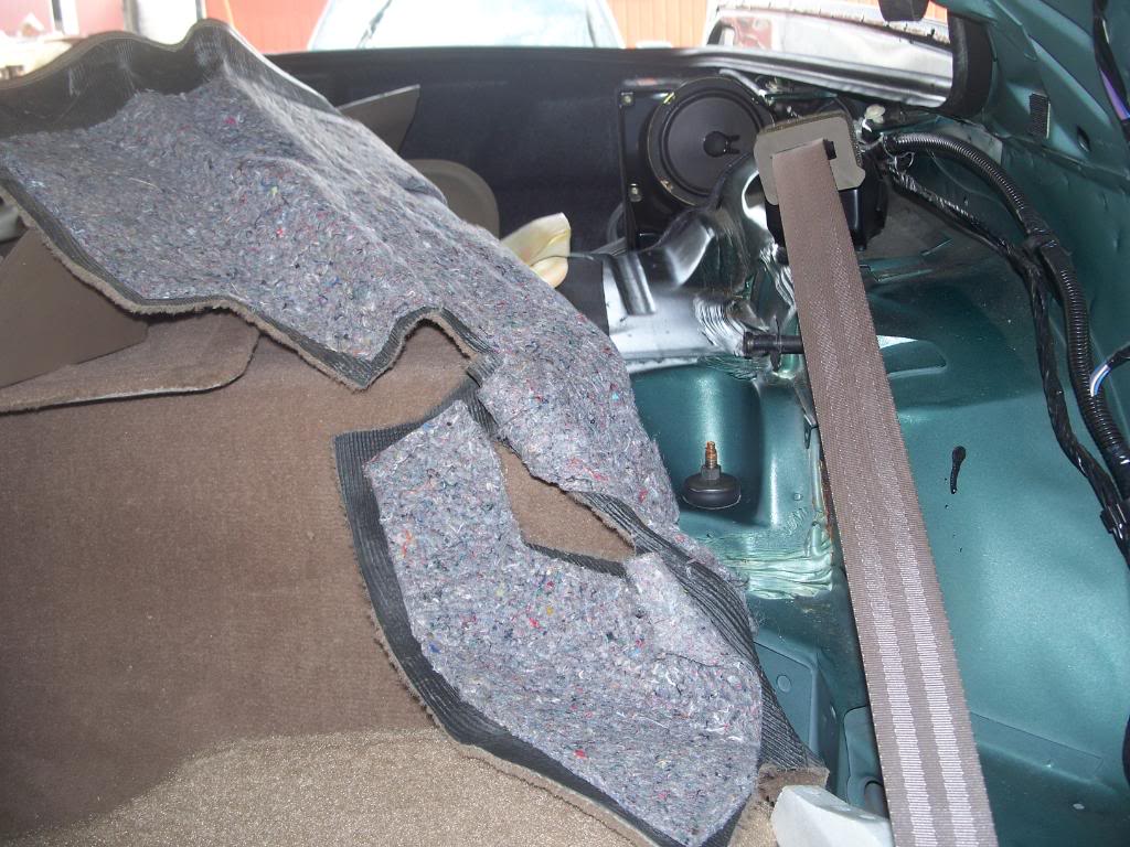

I also got the interior pretty much ripped apart enough to get at the top bolts for the rear shocks.

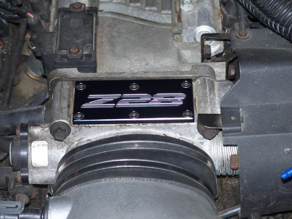

Got a lot done the last couple of days. First, I got the TB plate gasket in the mail, so I finally got it installed:

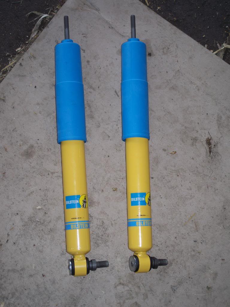

Then I got to serious work on the rear suspension. I got my SLP Bilsteins:

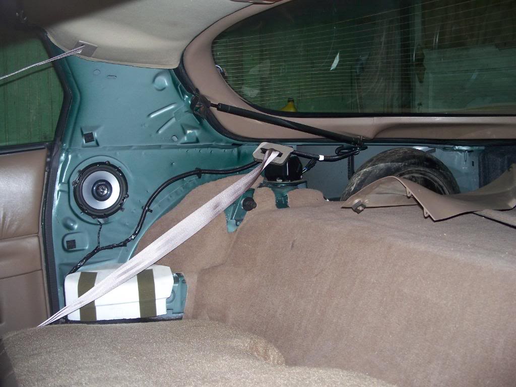

It was rather annoying that I had to tear the interior apart to get at the upper bolts, but I've done this before.

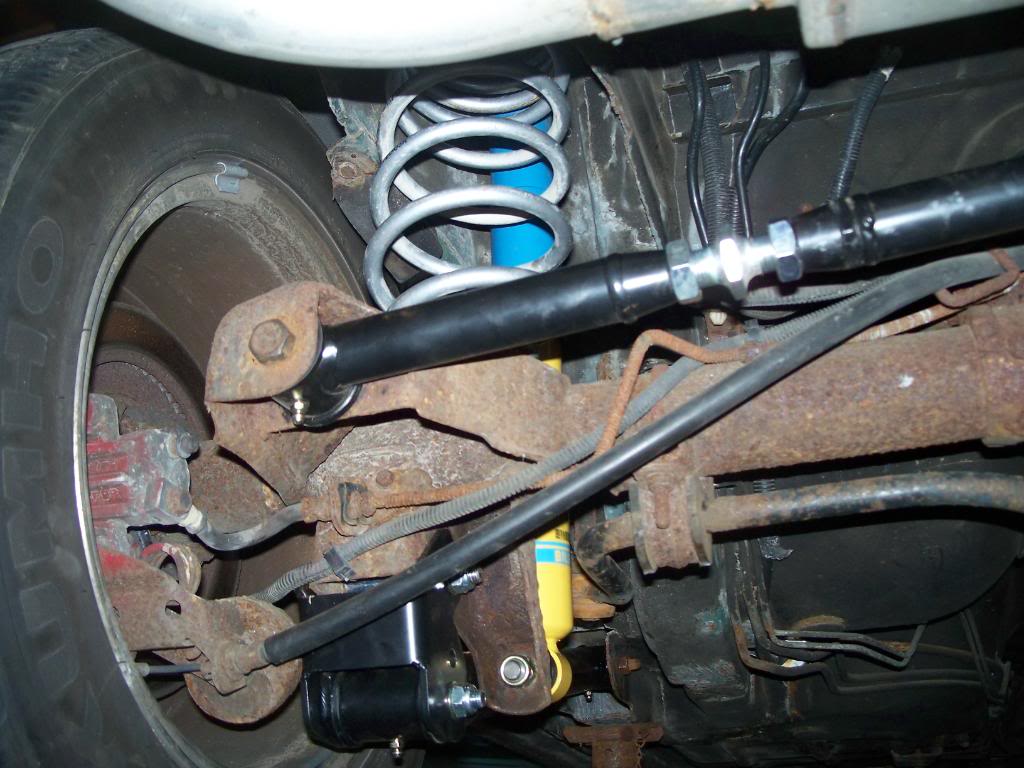

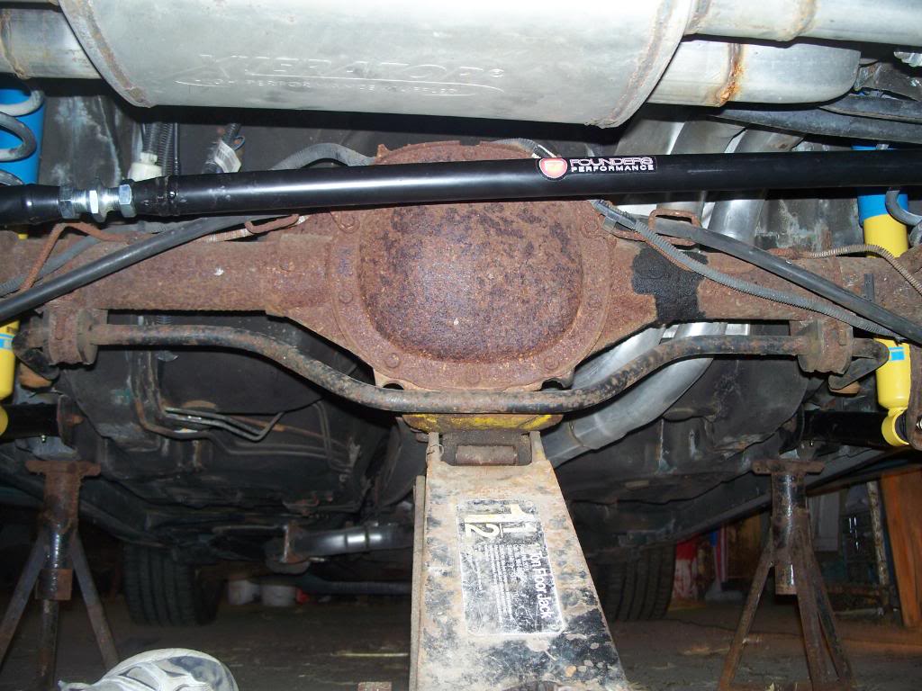

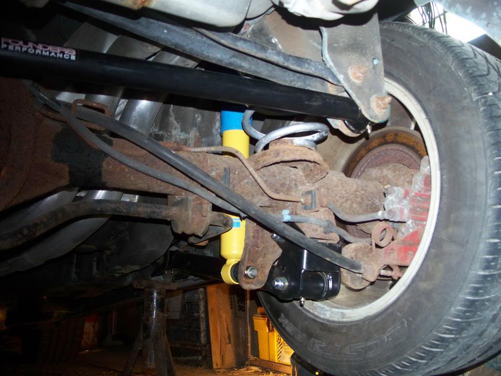

Fortunately my dad was out in the garage helping me this afternoon, so we got a lot done in not too much time. We installed the Bilsteins, Summit lowering springs, adjustable Panhard, LCAs, and relocation brackets:

Kind of a crappy picture, but this is how it sits now, with stock front suspension and lowered in the back:

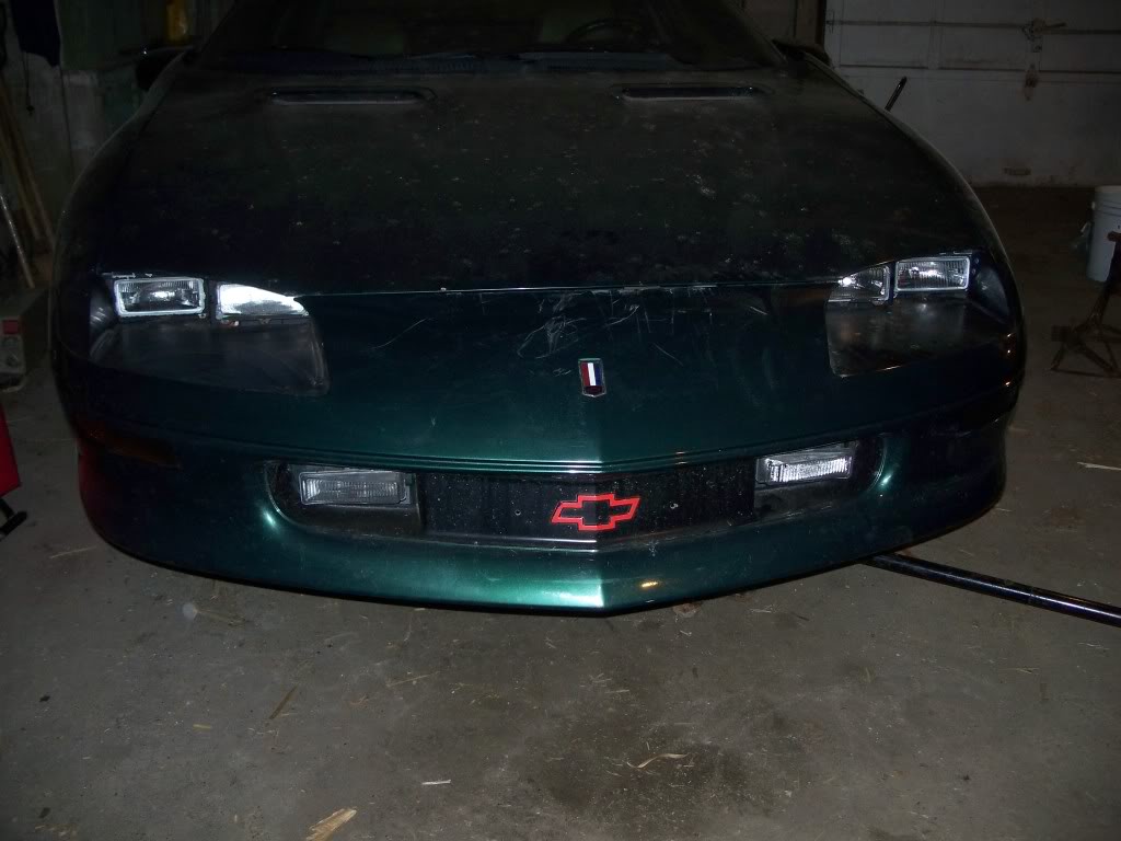

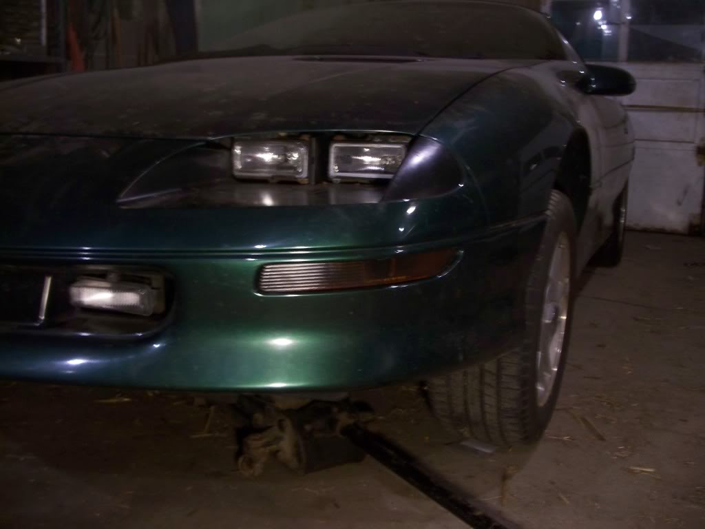

finished the other turn signal...turned out not as dark as the other one, but I'm hoping that you won't be able to tell the difference since they're on opposite sides of the car.
warning: dirty car is DIRTY
also dropped the car off to get the front Bilsteins and springs installed, and to get an alignment. Pretty much all I have to do yet is drill a hole in my intake elbow so I can put the opti vent hose into it.

How did you prep for the night shades? Also is the finish glossy?
Old May 19, 2011 | 10:18 PM
  #206
WIspartan1026's Avatar
May 2013 ROTM
Posts: 1,671
From: Farmington Hills, MI
I cleaned them real well, sanded with 1000-grit, cleaned again, put four super-light coats of nightshade on, then followed up with 3 coats of clear, then wet-sanded with 1000-grit again. I then added Meguilar's polishing compound and Scratch-X. I think the lighter your coats of nightshade, the smoother it will look.
