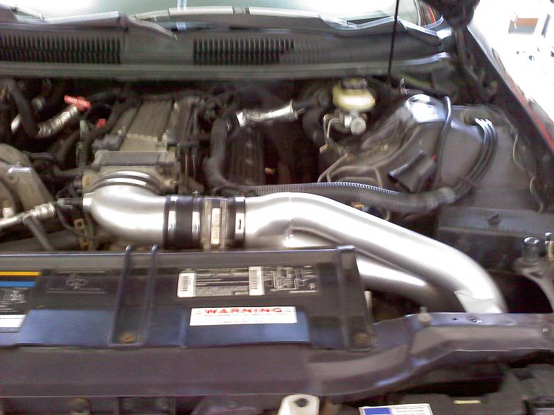

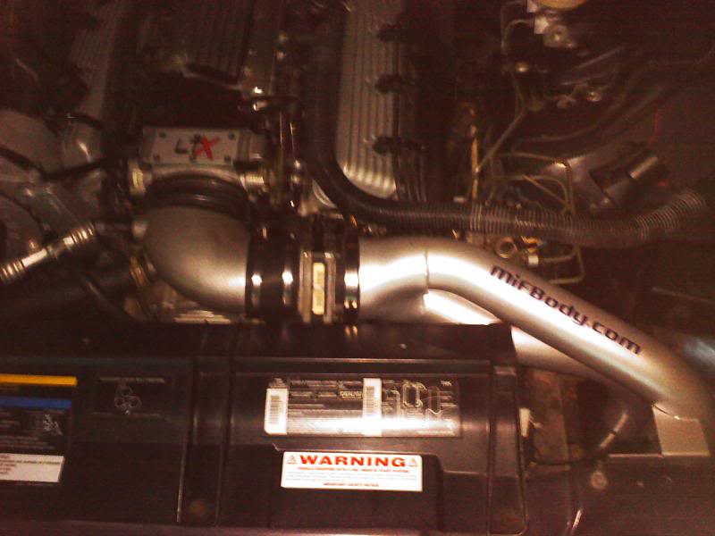

so I came across this SLP cold air intake:
I already have a cold air intake on my car, but I think this one looks a TON better. I think it will dress up the engine bay quite nicely. The guy wants $160, but I think I'm going to offer him $140. What do you guys think? I could probably sell the one I have for at least $100.
