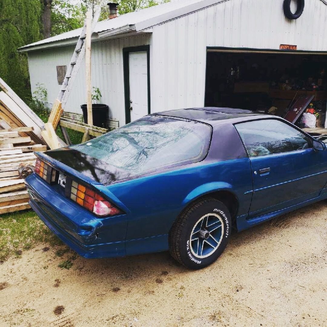

Yeah she’s being a major pain in *** though but I can get car to start. Gauges still arnt working and I’m gonna attempt to reinstall original ignition. I think it was the stereo system that I installed that’s messing up the wiring part of this problem. How ever my map sensor blots broke now lol. The car was my grandmothers she bought it in 92 off lot and I got it now. It sat for about 4 years and parts are old ya know but this car is worth every penny and time to me 😁
