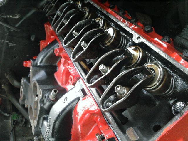

here are some pictures i shot last night. maybe this will clear up some confusion. i believe earlier you all were asking me if they were mounted indevidually or on a shaft. i think i said shaft, but wasnt quite sure what you meant. these are indevidually each mounted on a shaft. heres a picture. sorry for any confusion, i appreciate the help!
Attached Thumbnails 89 camaro rs with 81 camaro 267 v8. a few questions-getattachment%5B2%5D.jpg
Old Jun 13, 2010 | 05:04 PM
  #27
To avoid confusion next time, those are "stud" mounted rockers you have, which is a conventional setup. You need to follow the individual adjustment procedure already given you.
A "shaft" style is a horizontal bar that the rockers (different type) ride on.
