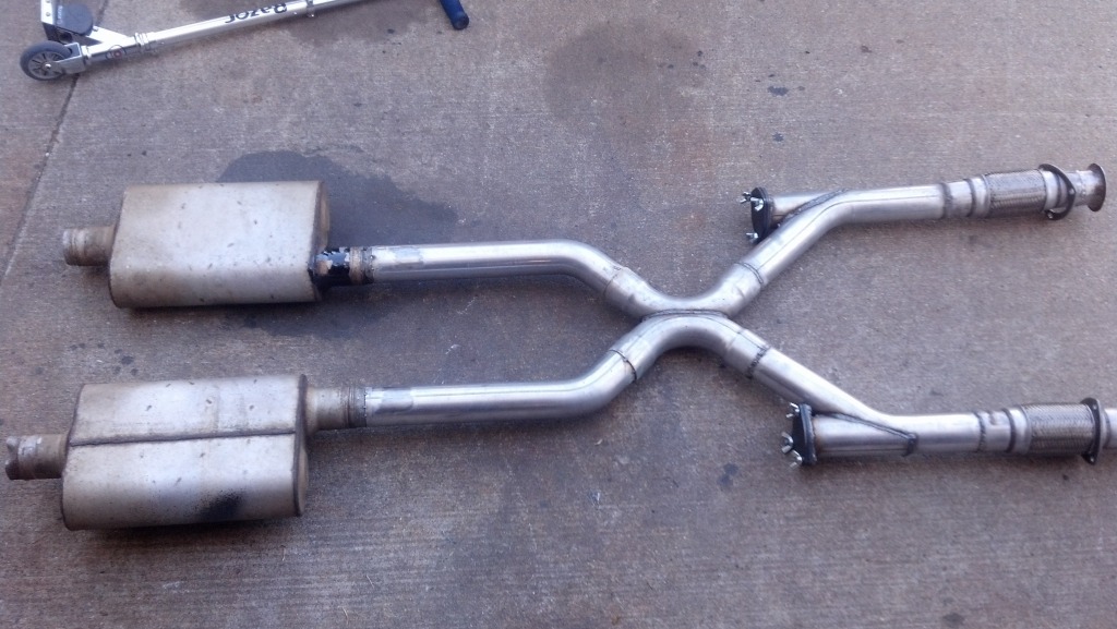

Lemens is building you a 3" collector BBC header? Huh? I dont have cut outs on my car. but I did put them on the truck.
Here is my Magnaflow 2.5" stainless w/ x-pipe
Here is the 2.5" Flowtec x-pipe kit with Flowmasters on my truck. No electric here.
