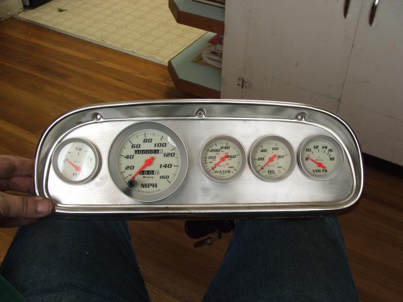

Not sure you'd find water pressure, but if you could I wouldn't buy it. Amp meter to measure charge is also not necessary, and even dangerous. I haven't used an amp gauge since the 70's.
I use:
oil pressure
water temperature
voltage
fuel level
speedo
tach-I don't mount a tach in my gauge cluster-separate.
Additional gauges that I have used on cars, but not necessarily in the dash are:
vacuum gauge- I have mine mounted either on the firewall, or in a port on the intake. I only use this for tuning, not constant observation.
fuel pressure- Another gauge that I don't put inside the car. Dangerous to have fuel line going into the interior, and remote wired fuel pressure gauges are way to spendy. I mount mine directly to my fuel pressure regulator and use it to initially set pressure to the carbs. After that I rarely look at it.
Some people go nuts with gauges, because they think it looks cool. My attitude is if I rarely look at it, I don't want it in my dash.
This is the gauge cluster on my BBC powered Falcon:
Thanks for your opinion. I agree with you with your last statement.
Why a vacuum gauge is important and needed for tuning? What do you tune/adjust?
