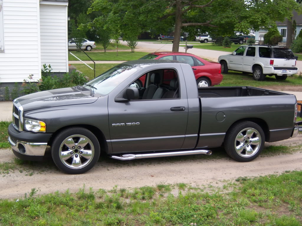

Looks like a push! You can build your own car. But I'm just offering real world advice. Unless you're running the nitrous motor on nitrous, the regular 572 the same motor. They used a different ring pack and o ringed the block to seal again the pressure on N2O. Thats all I see in hard parts. The cam may have different timing as well. Both are rated at 750 NA and I would bet a solid 1000hp hit is enough to pizz out your azz the first time it happens. But again, its your car. Have fun. Side pipes?? Look into that. Getting the pipes routed can be hard. Hooker doesn't make the original ones that were a real four into one side pipe. If you have kids, they WILL burn their leg exiting the car. ask me how I know???

You can't have side pipes and the X pipe system. Not if you really want the side pipes working, and hooked up. If they're just hanging on the side for appearances, then it would work. But the headers and X pipe system will put the end of the exhaust nearly to the rear axle, so it would somehow have to get turned 180 degrees, and run back under the car to get back up front to hook into the side pipes. Just not feasible in reality.
